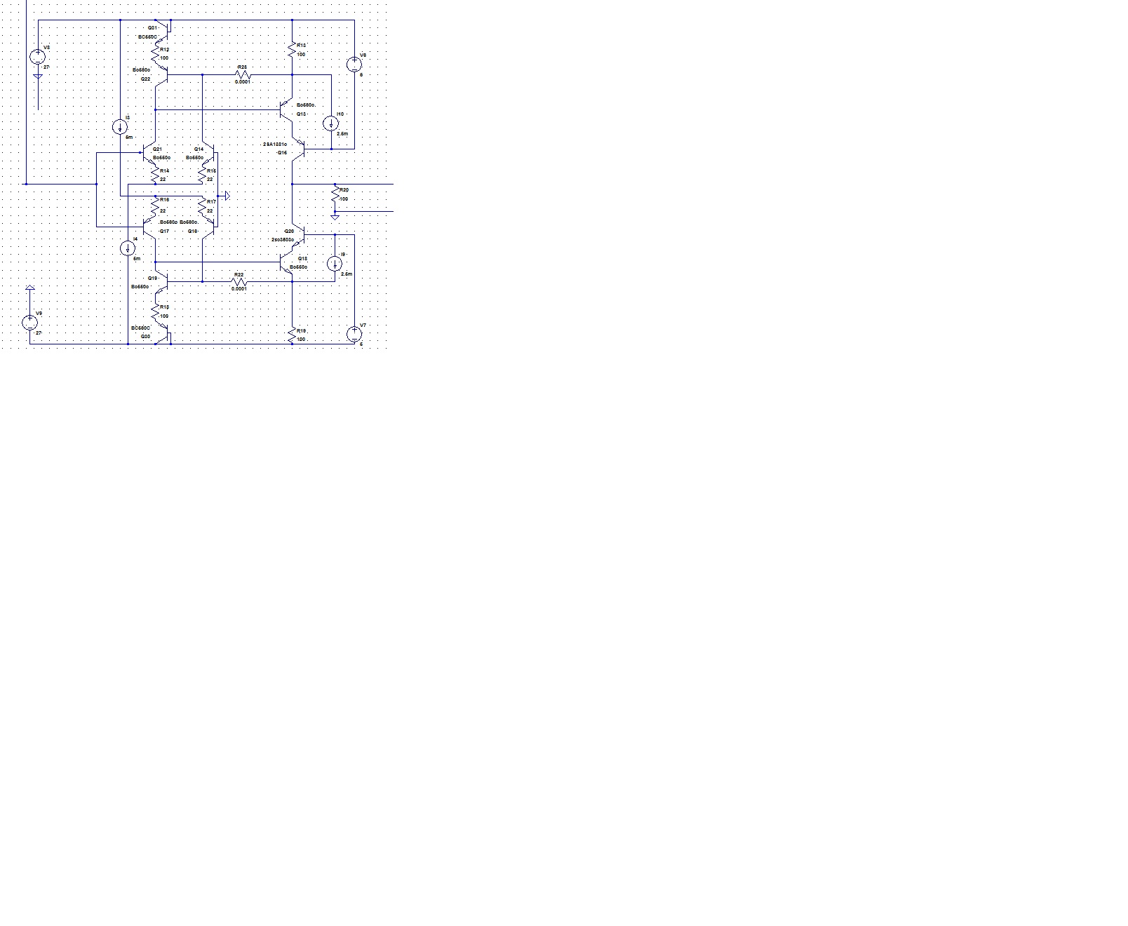

Hi Edmound have you considered a different input vas interface doing "the same thing" like the attachement? Omitting the "mirror".

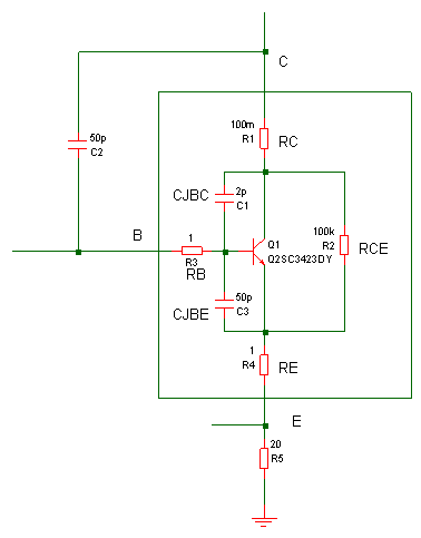

With no degeneration the miller local loop is itself "degenerated".
The emitter degeneration will allow for the base/emitter capacitance
to be bootstrapped in respect of the base.
Without this degeneration the said Cbe will be seen as a short to ground
at high frequency , drasticaly reducing the local NFB where it is most needed.
A simple schematic help to understand more easily.
- Has anyone seen this front-end before?
