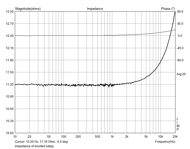

Here's what it does with the speaker leads simply shorted together. I don't know why I didn't do this in the first place, because this is what I should be trying to make work, and cannot be affected by acoustic noise. I would not be surprised if the HF rise is due to my cobbled together cable, but I am quite sure the 11.2Ω is not. Time to experiment.
Okay, so I dissected my cable and realized I had a short on the left input jack. Dumb dumb dumb. Surely this would fix everything, I thought, but no. Well everything became much more consistent and stable, but the results are still bad.
Now everything is too low. If I measure it with the speaker wire shorted, I get 0.14Ω with a small rise to 0.17 at the top end. Since the wire measures 0.14Ω with a multimeter, this seems pretty good, but something is wrong. A 470Ω resistor gives a reading of 2.89Ω. A 2.7kΩ resistor reads 16.75Ω. That's a consistent 0.6% of what I should see. Seems like a clue, but I'm not coming up with anything.

Let's see here... if I swap reference channels with the the 470Ω resistor, then I get 100Ω added to the (wrong by factor of ~0.006) result, eg. 102.89 instead of 2.89. For a 120Ω resistor, 100.64Ω instead of 0.64. If I measure a short, I get 99.86... that's odd, 100Ω minus the 0.14Ω result on the other channel. Anyway, seems pretty clear that's not the reference channel.
I have the input levels matched and calibrated now, btw.
Hmm, I moved some ground connections around and I think I may have cracked it, except I don't understand how.

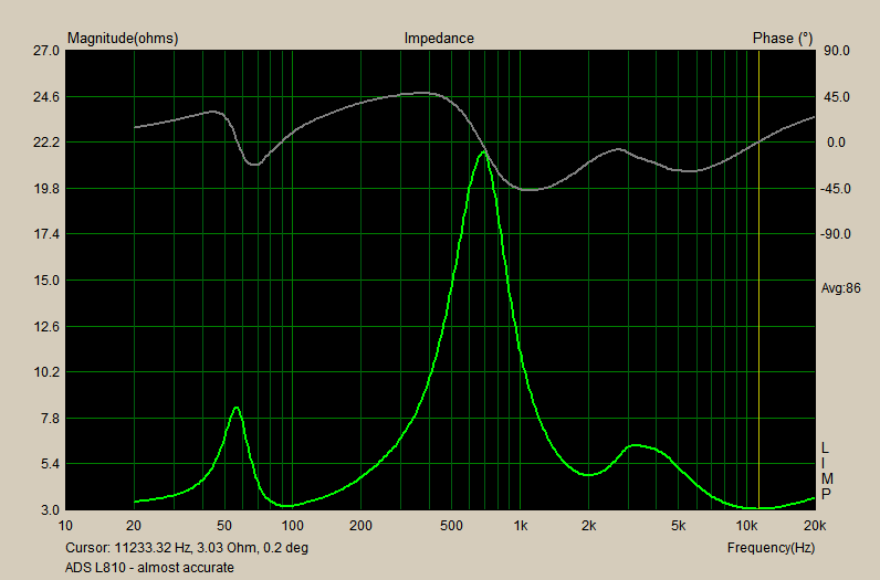

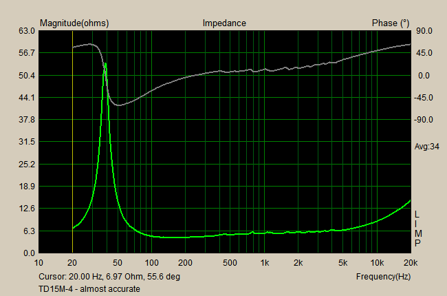

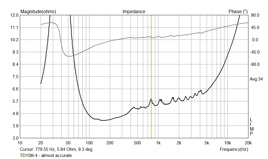

How about this? Looks pretty real. Has some ugliness, on the order of +/- 0.25Ω. I will repeat as a stepped measurement soon. edit: nevermind, the stepped measurement was identical down to the smallest details.
That's looking much much better. If you want try measuring some of the other drivers just to make sure.
One thing that is clear though is that there do appear to be some small resonance issues in the AE driver.
Those ugliness could be the spider or cone. I vaguely recall that the TD15 has a phase plug? Anyway, unless you are prepared to mod the driver, that test already gives you enough idea what you got.How about this? Looks pretty real. Has some ugliness, on the order of +/- 0.25Ω. I will repeat as a stepped measurement soon. edit: nevermind, the stepped measurement was identical down to the smallest details.

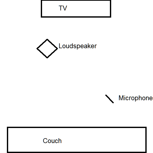

To perform a decent farfield measurement you need to make sure that your measurement space is as free from any objects as you can make it. I mean this can be difficult but if you can manage something like the attached image it should be fairly decent.
You need to get the loudspeaker up off the floor, the higher the better, but having the centre of the driver at least 1 meter off the floor is a good starting point.
