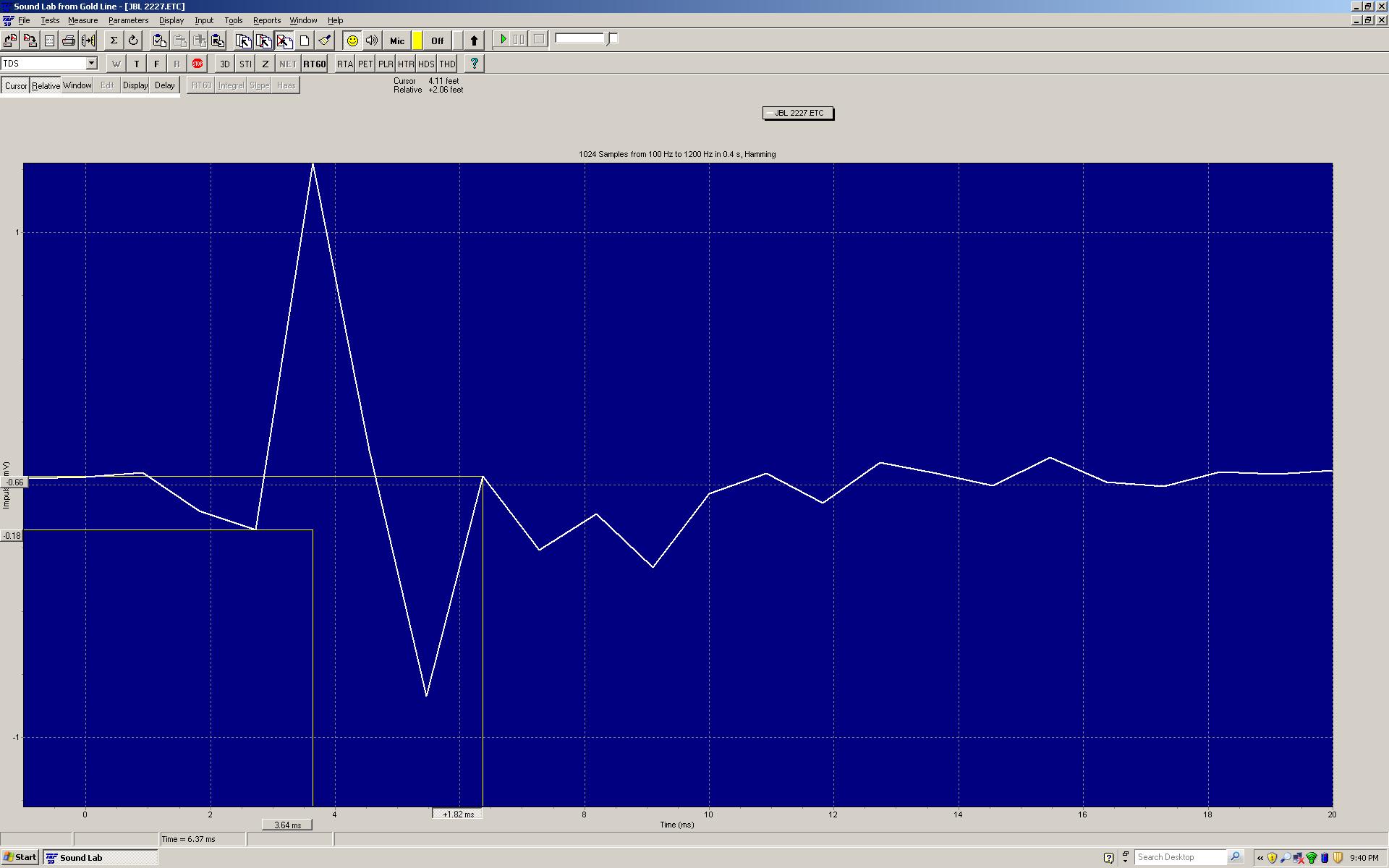

Below is an impulse measurement of a JBL 2227 band limited from 100-1200 Hz

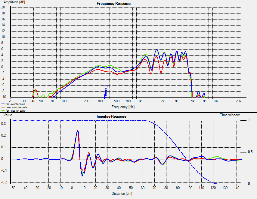

This may not be very useful for anything here, but I needed to see it, so here it is anyway. "Near" is around 15", "far" is 50". The design axis is 6" above the woofer center. I tried to match the impulse amplitude for the three.
P.S. The differences from ARTA mentioned above do appear to be from the gate taper - if I move the gate a little farther out, the small ripple in the 500-1k region does show up.

You know... going back to the real task hand (designing a speaker), what little of this bothersome behavior will make it through the crossover will, at the worst, affect the system response by +/- 1.5dB in the 1-2k range, and that's it. I should probably be more concerned about whether I'm getting an accurate picture of the average SPL between 500-2k, so that I end up with a flat midrange and get the HF driver padded correctly.

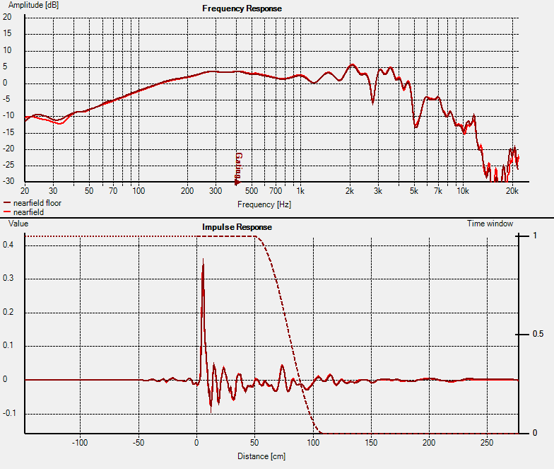

Here's the nearfield. I took a second one with the speaker on the floor pointing up, which should take the first reflection out about 0.5m farther from the first measurement, but as you can see, it looks the same.

Look at the impulse of the impedance measurement, if it is there, then it most likely is the spider problem.
In the impedance plot, this would normally show up as a wriggle in the dip between F0 and the inductance impedance rise.

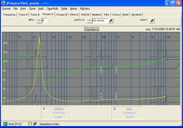

This is the mfg impedance measurement of the 8Ω version, if you guys haven't seen that:
