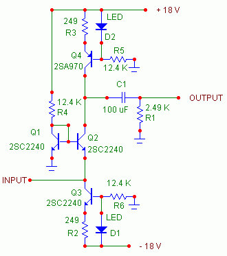

Just looked at the lm4562 it's slew rate (20v/us) is too low to be a good i/v converter.
Correct me if I'm wrong I've always been led to believe that you need good high slew rate amps up over >200v/us or even 2000v/us to be good i/v amps otherwise the hf corner noise spikes can't be handled.
Cheers George
Cheers George

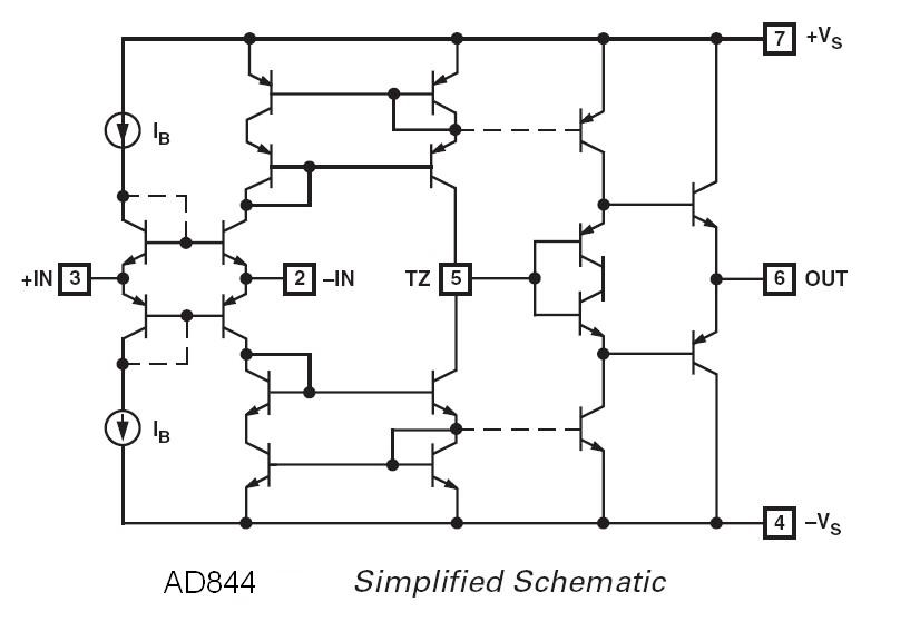

Have a look at the data sheets on the ones Boky likes you'll see that the worst one has 10 x the slew rate of the lm4562 (20v/us)and the good ones have over 100 x the slew rate of the lm4562. This is why they're good for I/V stage, if I went for an opamp it would be the AD844 (2000v/us) and discrete i/v's can be even better.
See how the +&- inputs feed directly into the emitters of the transistors not the base of the transistors, this is a Transimpedace amp, true low input impedance (typically 50ohms for the AD844) that current output dacs like the PCM56, TDA1541 and others love to see for low distortion performance.
Cheers George
Cheers George
