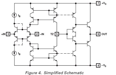

The only opamp version Transimpedance amp I know worth using is the AD844 (attached) note how the + & - inputs go to the emitters of the input transistors and not the bass, as most opamps, this is a true Transimpedance Opamp for I/V use, it is not a direct sub for the Harmans OP275 I/V quite a bit of surgery needed to get it going in there, that's why I preferred to go discrete Transimpdace for the I/V duties same amount of work but even better again.
Cheers George

Originally posted by Joe Rasmussen:
Take the output from Pin 7 and feed to 3.3uF coupling cap, then series with 390R to new RCA socket centre pin. Across the RCA fit 2n2 cap. Finally a wire back from RCA ground to suitable player ground, close to opamp. Do to both channels, both new RCA sockets that must not be grounded to the case, use insulators that usually comes with the sockets ....
This way, you loose the function of the muting transistors. Pops and noise when skipping tracks etc. are not supressed anymore. It is hard to imagine that HK included this additional circuitry without good reason?
Kurt
Don' worry. I wouln't use what manufaturers do as a good yard stick for what is good or bad.
Two answers to your question. Rebuilt hundreds of players and never had muting problems - just make sure your Volume Control is down (or anything that stops the sound to get to the speakers) when turning the player's power on and off.
If you disable the old outputs (there is usually 100-470 Ohm resistor) before it gets to the muting, just connected the new outputs to the muting point, and voila! I do this to the HKs I've done.
But really, don't need it that much. BTW, there are some who would argue that solid state muting can introduce non-linear effects and also that mechanical relays shorting to ground is the way to go.
But I repeat, muting is not absolutely necessary in 95% of players, you don't get much noise or clicks, if any at all. Trust me! Otherwise I would have been inundated with complaints.
BTW, the huge majority of DIY NOSDACs out there, they don't have muting because, if memory serves me correctly, the muting function is usually in the Digital Oversampling Filter, which they have deliberately omitted. I have built about a dozen of them and there is no option to include Muting. They work just fine.
