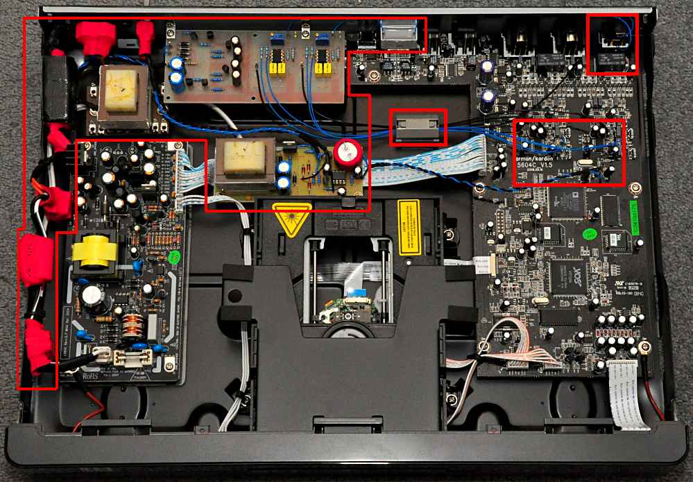

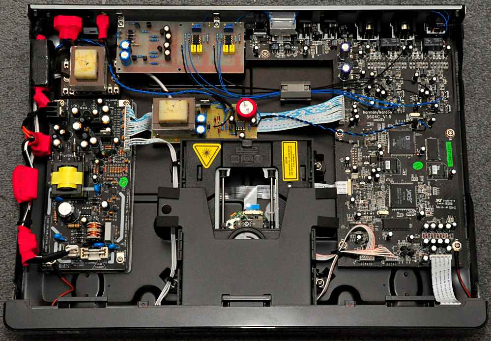

Just finished doing up a 990. Sounds pretty good to me. Post DAC does not use smps, in fact neither does the clock. Smps only used for digital section(s).
Joe R.

I did the work on the 990 here without service manual, but the post DAC circuit is based on the 970 for which the service manual is available. The clock circuit is capable driving 50 Ohm (ICS83905 chip) and cannot tell whether it takes advantage of that.
Joe R.

Than I'll rely on my heavy modder skills. 😀
I'll change the clock to a tentlabs, so will see if ICS83905 is still needed as clock buffer or not.

tvicol said:will see if ICS83905 is still needed as clock buffer or not.
If you want to use Tent clock with PS, then you will need to feed clock signal into ICS83905, remove Xtal and little caps as per usual. You can download the pdf file for ICS83905 at www.alldatasheet.com .
Joe R.

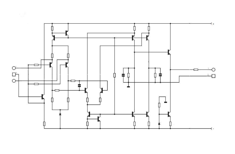

Javin5 said:I got a HD970.
(b) The analog output stage appears to be well designed, fully discrete class A. Georgehifi, you are changing that in your mods, what is wrong with the present design?Kurt
I go one better, solid state discrete single ended direct coupled class A for the output, and discrete direct coupled transimpeadance for the I/V, circuit attached.
But like I also said it is a very good output stage, and for a simple mod I would do just the I/V stage with my fav opamps the AD825's.
The standard XO clock is also very good, better than most, it will benifit from power supply improvements, a Tent XO 2.2 with it's own galvanicly isolated supply would be better.
Cheers George
