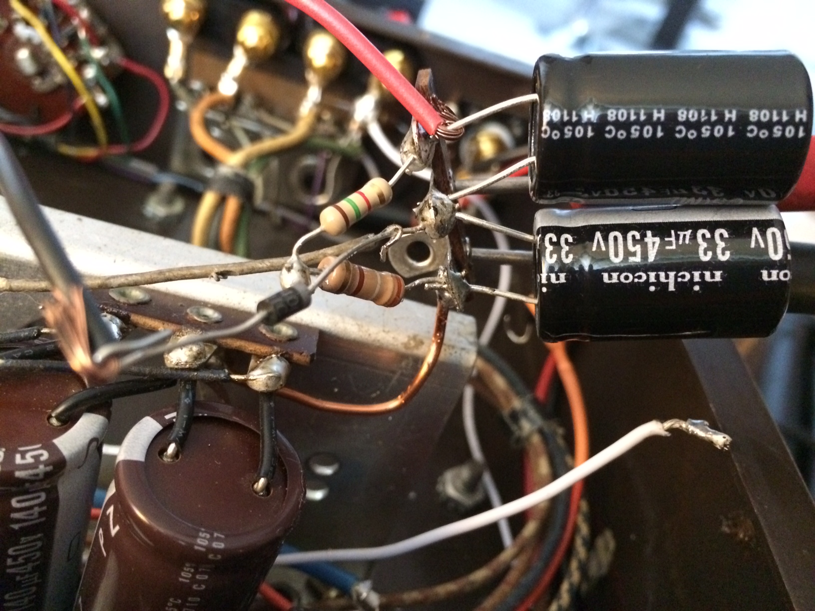

OK so today I finally took some time to finish up. The cap board is in, everything is mounted. I had completely forgotten that I had cut the bias winding wires very close to the transformer back when I went around with it the first time, so I had to extend those wires. Replaced the white wires for the feedback loops, one of them had a bad solder joint and was sitting loose on the post so glad I did!
So went to fire it up for the first time. No clang, perfectly silent startup. Now the 6550 tubes are starting to glow orange shortly after startup 🙁 I tried to adjust the bias but it goes off the meter.
I have changed R76 to 22ohm per factory schematics. I did however put in the 20ohm resistors that Jim recommends to use on his site (for KT88's but still).
My brain is kind of fried for the night, but I really don't wanna stop. Any ideas?
Bias transformer winding puts out 53v to ground from one of the wires to ground (don't have the color codes, wires blackened by the xfrmr), and the other about 10v to ground and then about 10v lead to lead. I changed out both caps as well, 450v 33uF because I have a few of them on hand.
So now I'm trying to use the extra bias transformer I have. It's putting out 86v ac and capable of around 200ma. The Bias supply is drawing 150-160ma (secondary) no matter where I position the bias pots and the tubes are starting to glow orange shortly after turn on.
I'm hooking up according to the schematics. The stripe side (negative) for both caps are connected together in the center, and to the back side of the diode (stripe towards transformer). The positive side of one goes to the 820ohm resistor, which connects to the positive side of the other, which connects to ground. I have tried it with a 1.8K like the orig schematics, and the 820K which is HK's website schematics. The picture is of the 1.8K I had to series 2 resistors to get the value.

Nevermind I got it. I had the diode backwards *BLAH!*

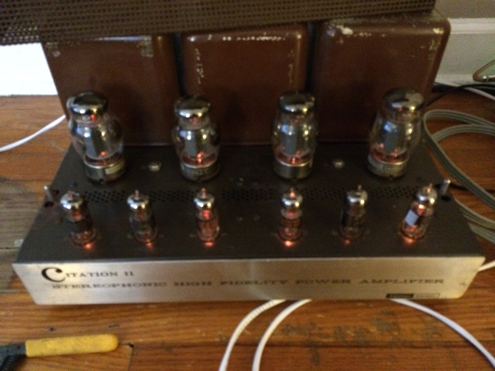

Here's a picture of the finished product. I'm using an old Pioneer receiver as a preamp right now, the Fisher 400-C isn't cooperating. I replaced the triple 30uF cap and it still has a darned hum and its distorted. Sounds amazing though, none of the digital amps I've had can run the electrostats like the HK can. The spatial imaging is astounding! I was in my bathroom and thought I heard Trent Resnor (sp?) singing in the living room.
BTW does anybody know who made the original 12BY7's? (The HK branded ones) I was hoping they would be GE because of the earlier discussion about the GE's working really well in the phase splitter position.
I do REALLY need one last bit of help with a couple final issues. First off, I wanted to see if someone could tell me how to find out how much Bias current is actually running through the tube with a multimeter (Hopefully without desoldering anything).
I also need help with the Bias circuit as well. The stand alone transformer I am using for Bias is putting out 86v AC. I know this has raised the bias circuit's voltage. E=I/R so if I've raised the voltage I've probably raised the current as well. The Bias meter at max setting will only go about 80% of the bias mark (between the AC bal and bias hashes). Is this something I need to worry about? The tubes seem to be running cool, I've been running it for hours and they haven't started to glow at all. Jim, if you're still reading, I'm hoping and praying you can tell me exactly where to put a couple resistors and be done with it if this is a problem.

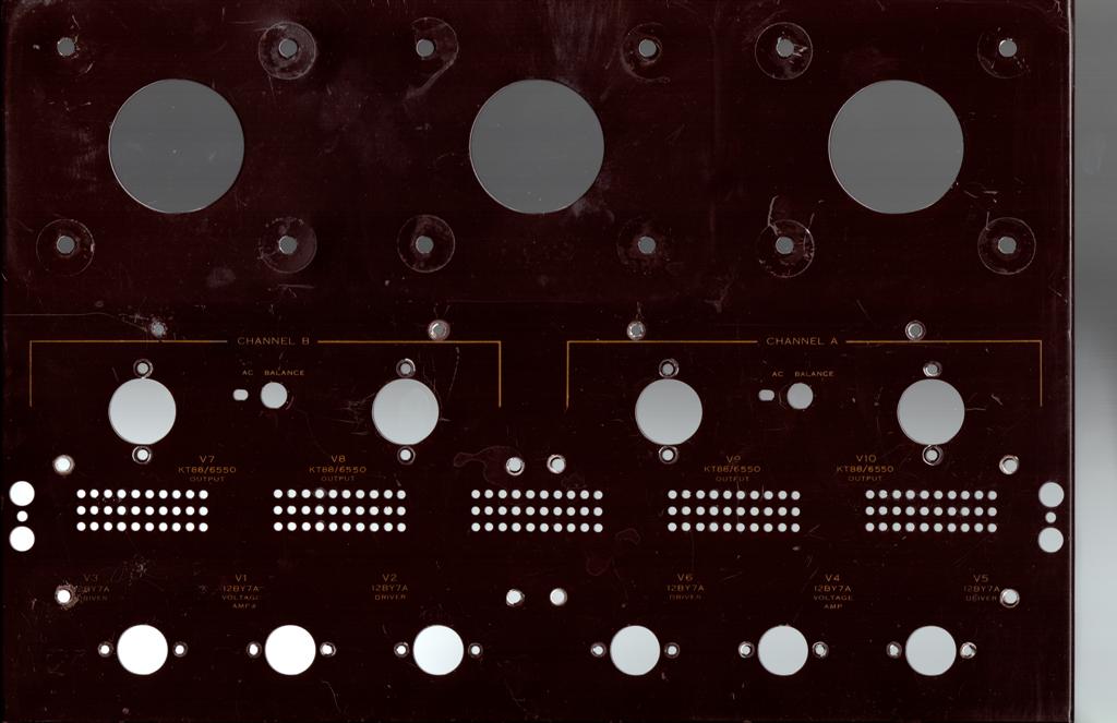

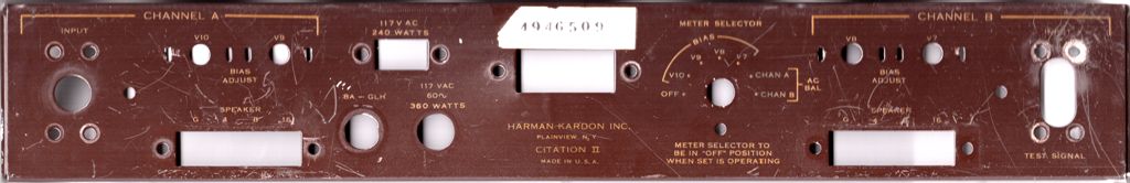

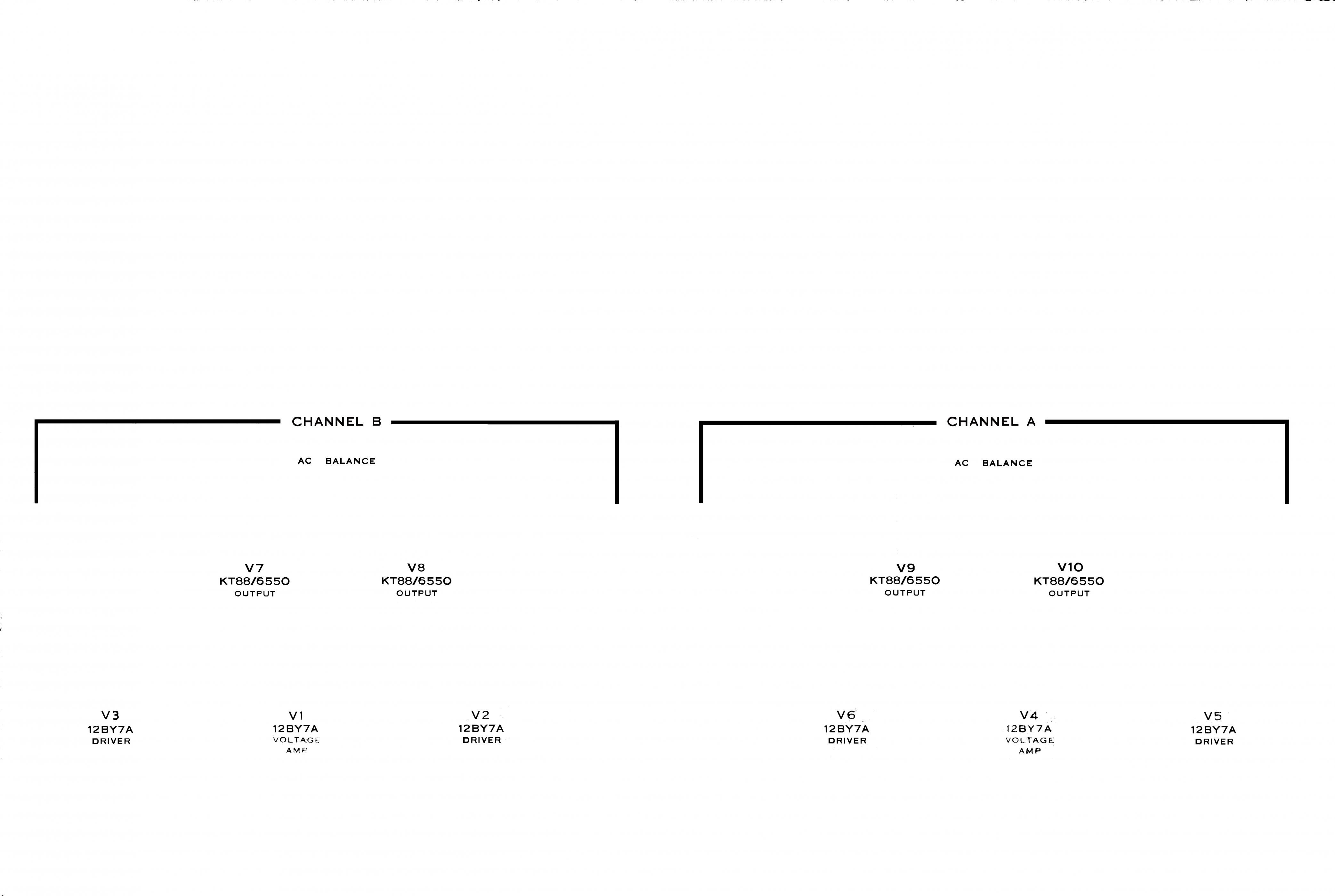

But my post concerns the process of making it look as good as it will sound. My chassis is also pretty beat up. The aluminum needs some straightening, as does the steel in a couple spots, and the lettering is really tough to even see, let alone read. I decided to try repainting the chassis and transformers myself, then screen printing the lettering on using gold metallic printing ink. I went to a local (Mesa, AZ) auto paint store and bought some base coat and clear coat. I also got some equipment and chemicals to do the printing as well. I have already scanned the chassis parts to get a full size image, and then processed them with GIMP freeware to get correct sized templates. (BTW, if anyone want the pdfs let me know and I'll post them. As I progress I would be happy to post some pics. I won't be getting it to the painting until some time next week, so it will be awhile before pics come out.
Bill
pdf scans and templates
Here are the back and front panel pdfs. On my Epson B-size printer these print out full size. The top panel file is too big as a pdf, so I'll try attaching a different format in the next post.
