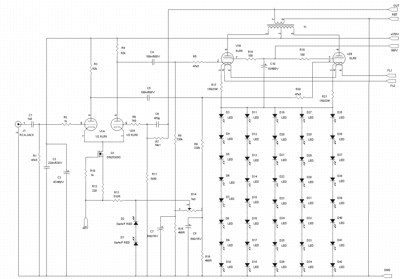

I'm still proceeding in fits and starts on this project. I've decided that it will indeed be a "Red Light District" of sorts, as I'll be using an array of GaAsP red LEDs as cathode bias for each output stage. These are the first generation dim, deep red LEDs, which have a pretty low impedance, though not anywhere near as low as an active bias network. Ill be using an array of 8 deep by 5 wide LEDs for each side, with a couple of extra LEDs for the grid bias/balance circuit.
The front end will still be a diff pair using the 6LR8 triodes and an N-Channel depletion mode mosfet current source to set the tail current. I'll be generating the screen voltages for the output stage using an extra output tap on my SMPS. This complicates the SMPS design just a trifle, and saves a lot of parts at the amplifier end.
A schematic will follow after some breadboarding - don't hold your breath.
Well, this is the schematic I'll be breadboarding, with changes as necessary. R12 is a placeholder, and will be actually determined by the Vgs of the fet in question (Q1) at 5ma drain current.The LEDs are all antediluvian Litronix GaASP deep red LEDs (part number unknown), which have tested out so far as having really low incremental resistance at reasonable bias current. I'm interested in hearing how the Wurlitzer output iron I'm using will sound. The original transformers came from some 7868-based organ amplifiers.

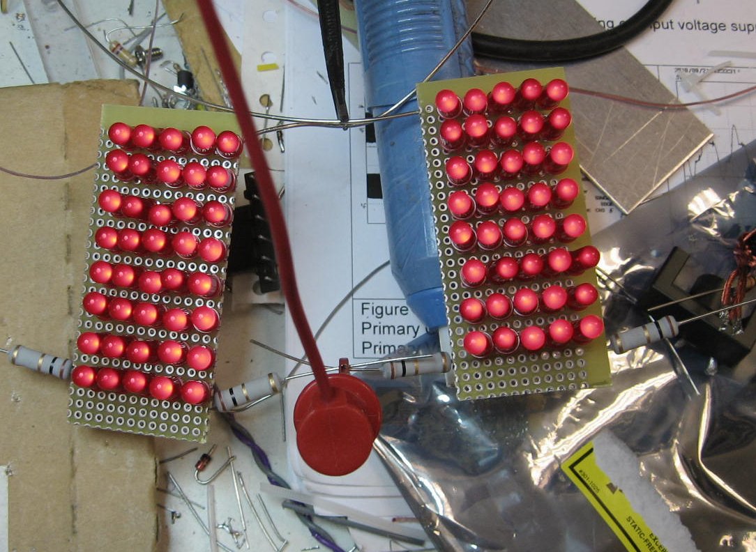

I just measured my LED of choice in the lab, for use in my cathode bias array. They are some fairly ugly Litronix red diffused parts that I can get for 5 cents apiece. The voltage drop measures like GaAsP - 1.65V at 30 mA bias. The impedance is also attractive at ~1.7 ohms. I'll use these ugly LEDs for bias and keep them under wraps, so I can save my better looking GaAsP LEDs for pilot light duty. The early GaAsP LEDs have an attractive deep red color that is unique, especially in a non-diffused package. The later, more efficient red LEDs have too much orange for my taste.
Here's the LED arrays I'll be using for cathode bias. I'm putting them under the hood, so they can be as ugly as I please. The LEDs aren't particularly bright or attractive, so it's no real loss. They do have low impedance, though. At the 30-35 ma of bias I'm intending for each tube, the bias current is 14ma/diode. That means each diode has an impedance of about 2.4 ohms, and the impedance of the total array is 2.4 X 8/5 = about 3.8 ohms - not too bad. When the amp is driven hard, the impedance of the array will actually go down.
Please correct me if I understood it wrong, but with your setup of 5 parallel branches, for 35 mA per tube / diode array, then the individual diode current would be around 7 mA. Perhaps the diodes can withstand it and you can let only 3 branches to get to that target current. However, and depending on the slope of the impedance curve vs. current of the diodes, the total equivalent impedance for the array would be higher...
Just to let you know, at 14ma per diode, the GaAsP diodes I'm using aren't really past the "knee" of their characteristic V-I curve. It takes about 25-30ma before they start to flatten out to their ultimate low impedance. Obviously, decreasing the number of diode strings would increase the current per diode and place their quiescent bias more on the flat part of the curve. However, these are first-generation parts (well, maybe 1 1/2), and I'm concerned about the survivability when I crank the volume to 11 and really push some current through the array. The 6LR8s are vertical deflection tubes with cathodes capable of high peak current, so this is a real concern. It may be that I still have one of my ancient Litronix data books still in my stash in the basement, so it might be possible to verify the peak current capability of these diodes. However, the 5 wide array should keep the peak current down to 50ma/diode or so for fat bass pulses. This sounds reasonable. Litronix was acquired by Siemens a long time ago, and the original fab at Lawrence Expressway and Homestead in Santa Clara, California (I used to drive by it when I first relocated to Silicon Valley) was shut down ages ago. It was an EPA toxic Superfund site for a while, and now is the location of a big Kaiser medical center - go figure.
