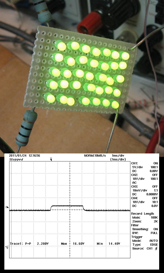

Attached is a photo of the array being hit with a current step. This was accomplised by putting the array in series with an electronic load with an internal step load feature. Quiescent current was 60mA, stepped to 150 mA. This represents a quiescent bias of 30mA/tube, then an extreme step cutting off one tube and pushing the other to 150ma. The scope picture attached shows the resulting voltage step. The overall array incremental resistance is 2.2V/90mA = 24.4 ohms. Under these conditions, each LED in the string has an incremental resistance of ~17 ohms. The LEDs are operating well within their pulsed current rating, so any decision to add more strings to the array would be based on achieving a lower incremental impedance.
The photo shows the array with a 10 ohm current sense resistor dedicated to each output tube. The array voltage shown in the scope picture was measured directly across the LEDS, not including the resistor voltage drop.

Any of the active loads that I have ginned up so far will soundly kick the LED array's butt without breaking a sweat. However, it may be that 10-20 ohms resistance is sufficient to reap the benefits of LED cathode bias. I may just put another 10 ohm resistor in parallel with the LED array and declare victory. I was guessing that the little green LEDs were about 10 ohms apiece, but large signal excitation looks different. I may try again with a smaller current excursion to see if I get different numbers. These can't be all that different from the ones SY was using in his RLD.
SHHHHH don't tell anyone....esperially SY, but a plain old 5 watt zener diode whups up on the LED's. I used a 1N5350B from On Semi. It is rated at 2.5 ohms zener impedance.
I just went back to my setup with a couple of good meters and sharpened the pencil a bit. For a current excursion of 60ma to 150ma (accurately measured) I get a voltage excursion from 14.49V to 16.35V, or a delta Vee of 1.86V. This puts the resistance of the array at 20.7 ohms, and the resistance of each induividual LED at ~14.8 ohms. For both green LEDs, and red leds, your mileage may vary as to resistance. I'll have a bunch of HP/Avago LEDs coming soon. I'll try a similar measurement with them, but with a single string of 7 to keep the tedium factor down. I also have a bunch of ancient Litronix GaAsP red LEDs that might be worth a shot. Those will need more LEDs per string to reach my 14V target, though.

This may be an opportunity to see just how stiff you need the catode bias network in order to derive some benefit.
My first experiment was simple. I connected all 8 EL84 cathodes together and wired them to a 0 to 25 volt 5 amp Sorrensen linear supply. THe supply can not sink current, so I put an 8 ohm resistor across the output and set the current limit to max. I wound up with 13 volts on the supply and individual tube currents were adjusted via the screen voltage.
