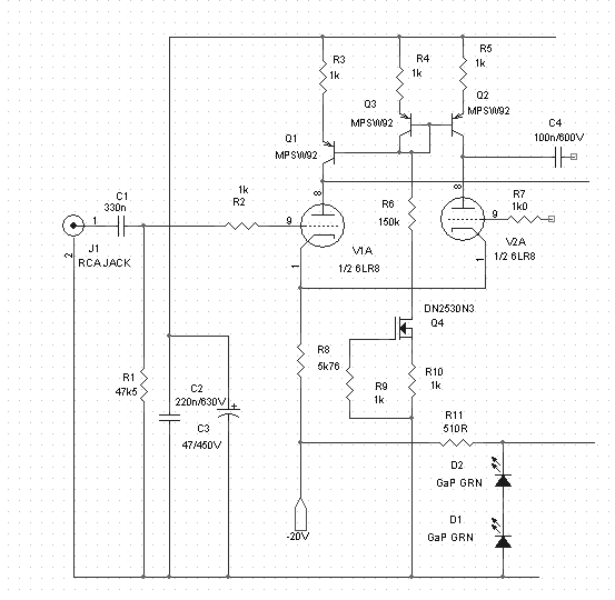

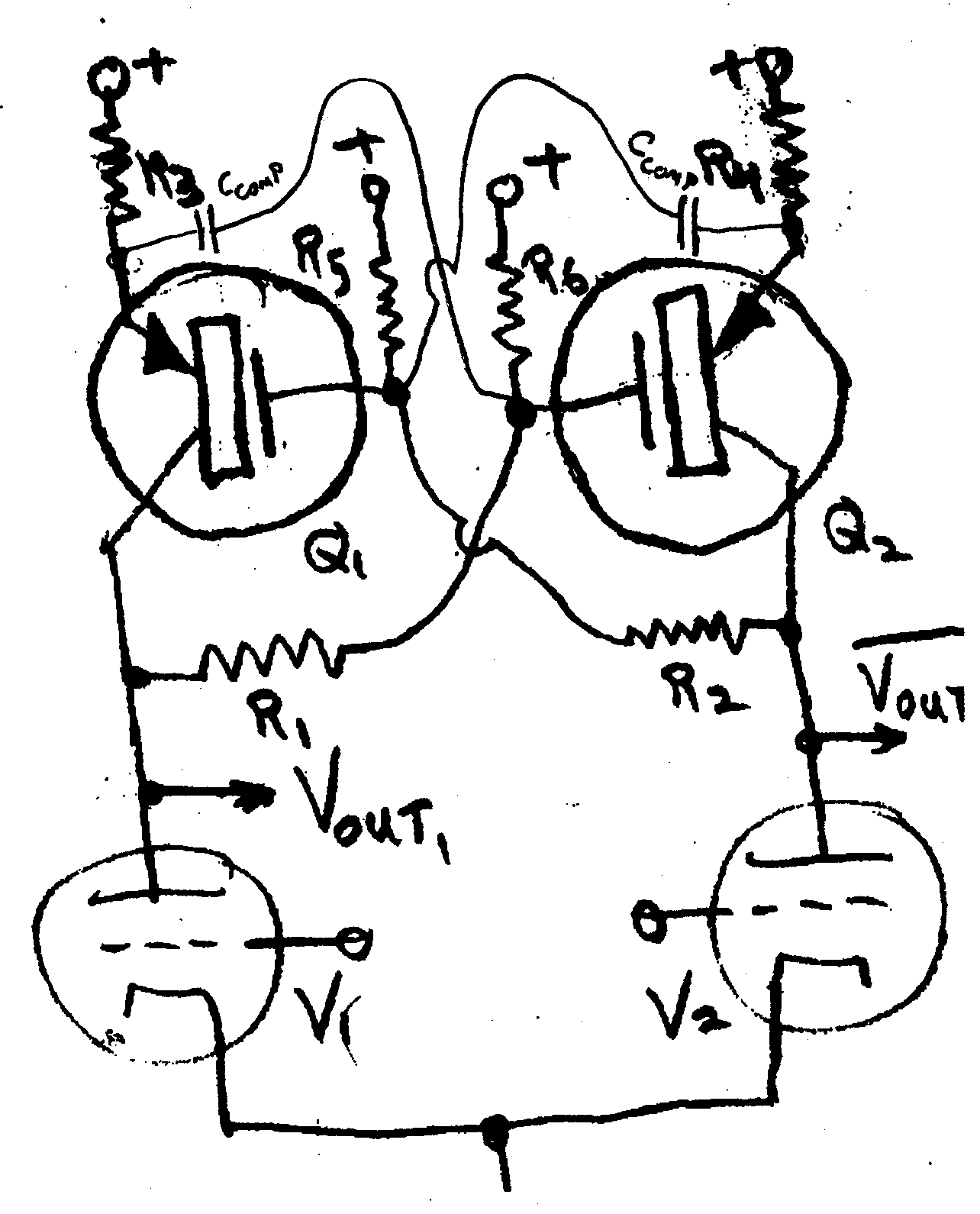

Well, been there, am doing that already in a parallel project ( an active cathode bias circuit with PNP Darlington + TL431). I haven't tried an LED array for cathode bias, so this project will employ a couple. I'm not really one for gaudy display, so I'm hiding my lights under a bushel and keeping the arrays out of sight. Since they're made using 1st generation GaAsP LEDs, they aren't all that bright to begin with, and ugly (construction-wise) to boot. I may use a prettier GaAsP LED (with ruby-red clear encapsulation) as a pilot, but I'm also biased towards some equally obsolete (though much more recent) SiC LEDs that are a rather fetching sky-blue, and will go well with the deep blue metallic paint I'll be using on the case. I have a feeling there won't be too much difference between an LED array (ohms of incremental impedance), and the active cathode bias (milliohms of impedance). Less experienced people will have an easier time getting the LEDs to function, as they can just string them together and not have to worry about loop stability for the bias circuit.
This project is rising from a long sleep, and as such, will be affected by things I have learned in the interim.

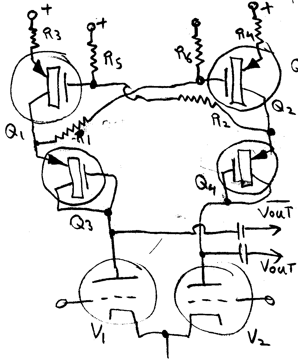

The input stage has been modified to a differential folded cascode using the triodes of the 6LR8. Cascode XSTRs are KSA1381. Drive to the output pentodes will be direct, with no intervening coupling capacitors or followers, so don't expect any heavy class AB2 action.

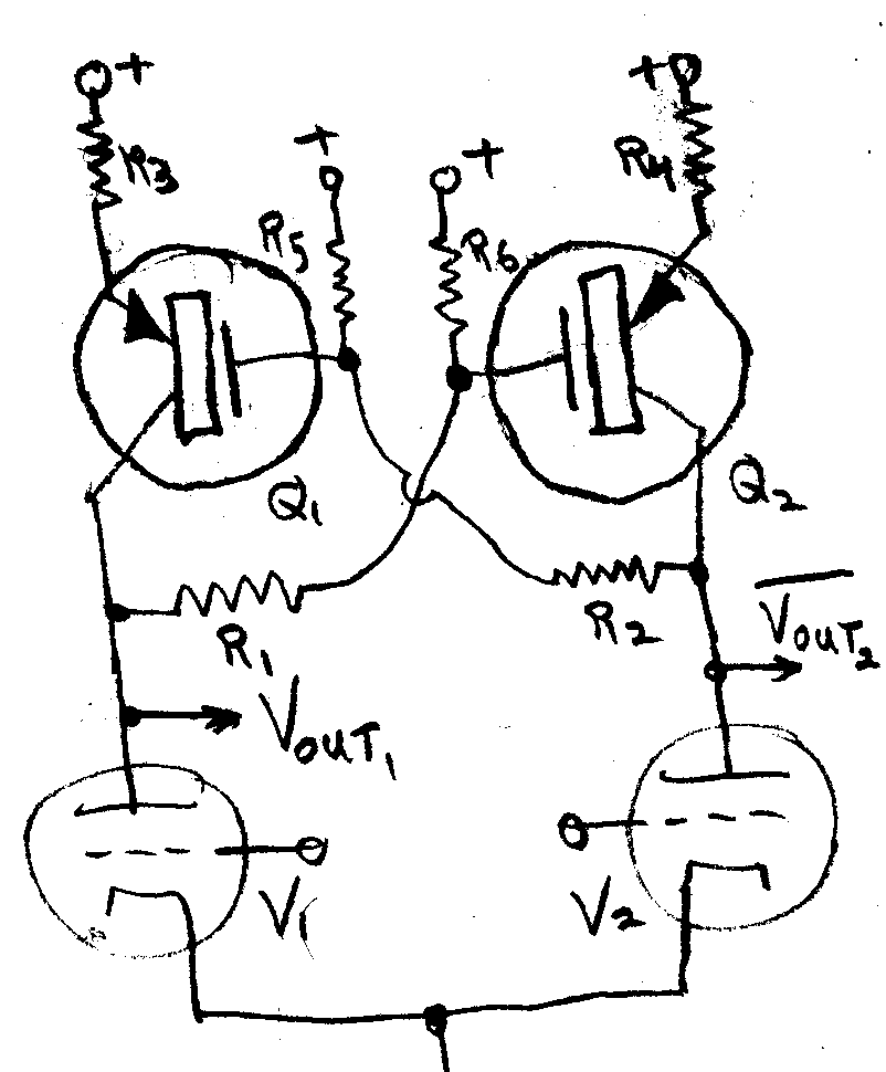

Rather than putting in a pot to adjust the output balance, I'm trying the Blumlein "Garter" bias scheme, in the hope that I can use 6LR8 tubes without matching.
I'll finalize and post the schematic when I complete my SMPS to power the thing, so that I know the bias voltages I'll be using. I probably won't wind the transformer for the SMPS until I get in to work next week.
It's got more of a max screen voltage rating for the power pentode than your classic horizontal deflection tube (300V), but the 6LR8 is still a deflection tube, meaning that the screen grid is wound to be touchy, regardless of max voltage rating. Live and learn...
With 300V screen voltage the 6LR8 power pentode needs a lightning bolt on g1 to tame it to plate currents within its power dissipation rating (at least 40+ volts for 350V/300V plate/screen voltage). Nope - won't go there - there's a reason that the tube is specified with 125V screen voltage. With 150V screen potential, things are much more reasonable.
I plan to wind the SMPS XFMR for this amp with a 40-50V bias winding - I'll run the screen supply via a voltage tripler off this winding. The low screen potential means low screen current, unless the tube gets really hammered so that the plate is below the screen potential for a substantial portion of the operating time. It's my job to ensure that don't happen.

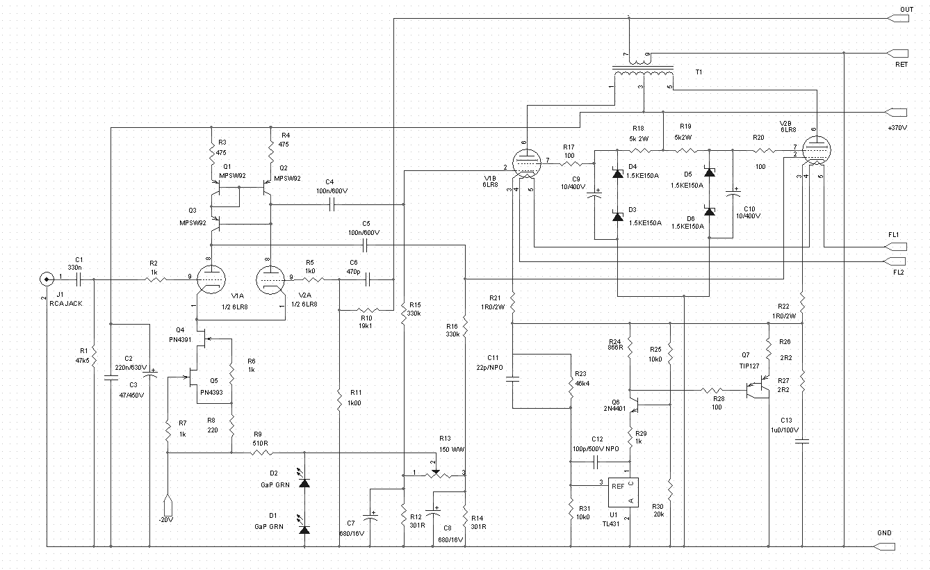

Here's a first cut of the schematic I'm dealing with. The overall topology will remain the same, but a few of the resistor values will need tweaking.
Resistors R3, R5, R15, and R16 are prime suspects for adjustment. I was going to try Blumlein garter bias on this amp, but I decided that that would be too much complexity/too many simultaneous new things to unravel (been burned that way before), hence pots R4 and R24 for balance adjustment. I may be able to ditch R22 and R23 and replace them with 1 ohm current measurement resistors once I get the output stage biasing sorted out. The SMPS I'm using to power this thing is all up and running, and the voltages shown on the schematic are the actual levels it delivers for plate, screen, and negative bias.
Clamp network D6-8 limits the positive bias applied to the output stage grids while the tubes are busy warming up. Another way around the problem might have been to use a capacitance multiplier or a separate small rectifier tube (like a 6X4) with a long time constant to feed the input stage, so that the output stage will initially come up in full cutoff. I may try that on another amp - perhaps the ST70 "Imposter", which will be using a similar input stage.
