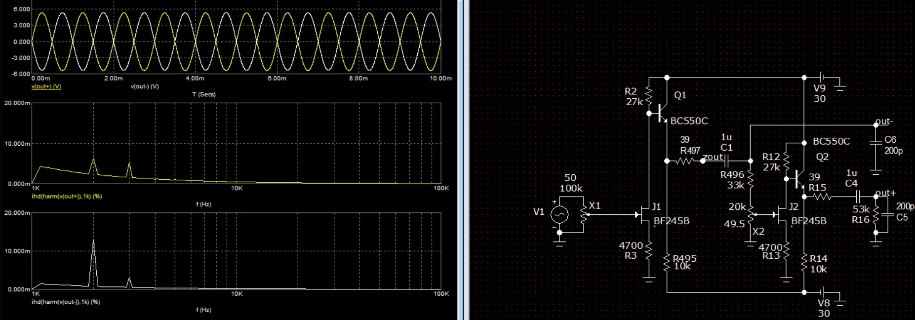

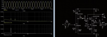

Well its sort of obvious from the symmetry of odd and even functions, but if you can't see that, here's the equationsLiterature? Data, proof?
f(x) = -(x + a*x^2), basic 2nd order distortion in inverting gain of 1, 0 < a << 1
g(x) = f(f(x)) apply twice
therefore g(x) = -(-(x + a*x^2)) - a*(x + a*x^2)^2 = x + a*x^2 - a*x^2 - 2*a^2*x^3 - a^3*a^4
If a = 0.01, thats: x - 0.0002 x^3 - 0.000001 x^4, the 2nd order term has cancelled, leaving much less 2nd-order distortion (the higher order terms will introduce some, but at a lower level).
The multiple angle formulae convert these powers to spectra,
This all requires a to be small to start with, but we hope that's the case!!

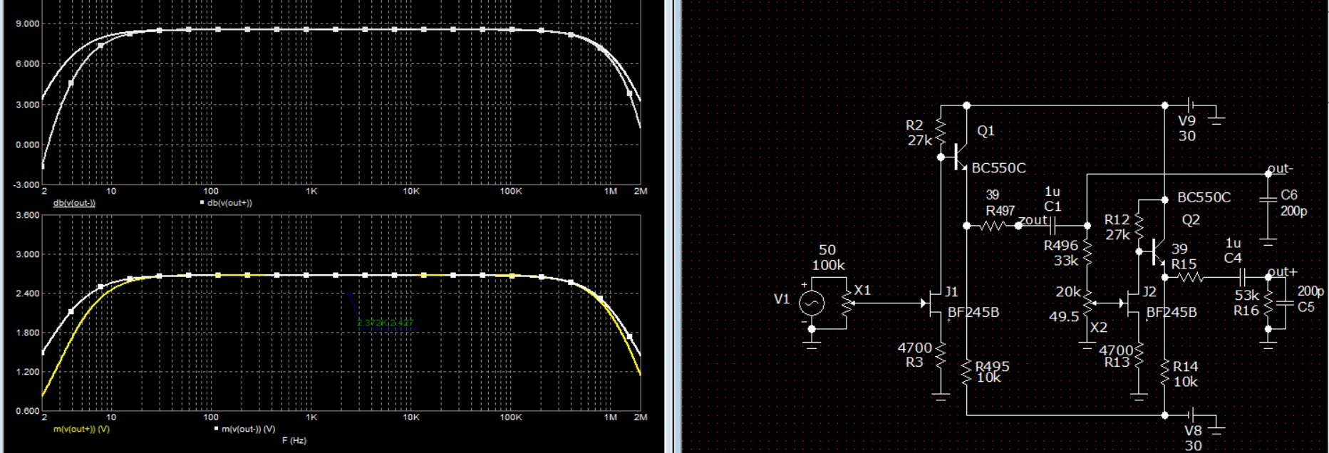

Do not want to be smart ***, but hamptone was primarily designed to be solid state pre emulating tubes, with tons of 2nd harmonic distortion. My data show anywhere to 0.6% pure second harmonic. Why would you configure pre to generate 2nd harmonic at first place, only to try to remove it?
The volume pot adds noise, so placing it first in the chain means that the pre-amp amplifies that noise and results in the lowest SNR option. On the other hand, you are only asking the amplification stage to produce the exact output you want, so is best from a dynamic range perspective.Because, everyone of you noticed, Hamptone, just like some other pre has two stages with volume pot in the middle. Why?
The highest SNR solution would be to have the volume pot after all of the amplification in the preamp, but this can have a couple of issues: a) output impedance is then dominated by the pot, and b) the amplification portion of the preamp probably would need to be able to handle larger (possibly much larger) signals and would be driven at those large signal levels all of the time. That would be the worst for dynamic range and probably for distortion as well.
Breaking up the gain into two lower-gain stages and placing the attenuator in-between is a compromise between the two extremes above.
A different approach would be to use an active volume control.
At least that is the way I see it.
When you stack your identical preamps, do you place a volume pot in-between, or do you have the volume pot somewhere else?

Principle of superposition means the even order distortion cancels in any signal at all, if it works for a single tone, it works for all signals. Again the caveat is that the level of distortion must be small to begin with so that superposition is a reasonable approximation - say 0.1% or less distortion.Btw, gentlemen, i do not care about seeing sine wave with little 2nd harmonic going up in first pre, and going down in second pre. Or matematical model.
I do not listen to sine wave, hopefully you do not either. I listen to music.
Apply very complex signal (music) to first preamp, see distortion and noise going up.
Apply this even more complex signal to second pre. See noise and distortion going even higher.
Please provide proof 2nd harmonics was lowered.
Or put another way the maths I gave is for the response function, which becomes a much straighter line when inverting even-order only responses are composed with each other - all signals see the straighter response...
