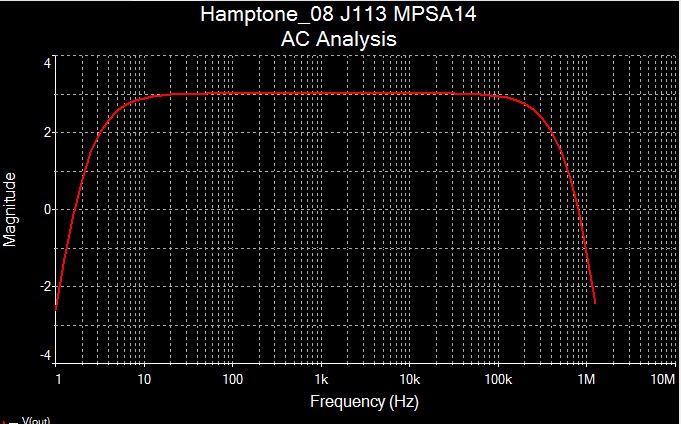

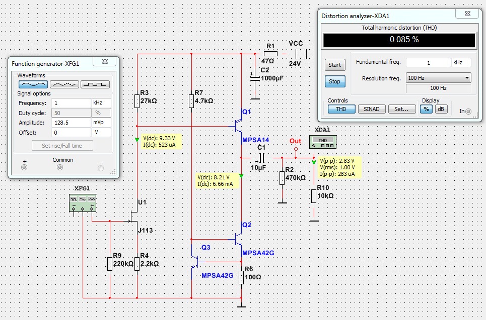

Yes, I have simulated a bunch of Hamptone.
Now I tested with J113 and MPSA14.
Got a bit better result with MPSA14 compared to MPSA42.
Also trying to have only 500uA through the J113. Seems the best.
This is the best so far.
I always test the output at 1Vrms into 10k load.
This way I can compare with same output level.

The circuit does not have global negative feedback.Maybe PMA can sketch the feedback path?
R12/R18 provide local negative feedback for input jfet.
I find it so fascinating to see the low THD without global feedback of above circuits.
Also the absence of 'bandwidth limiting' capacitors is compelling.
It's like 'super fine tuning' the actual transfer functions/characteristics of transistors.

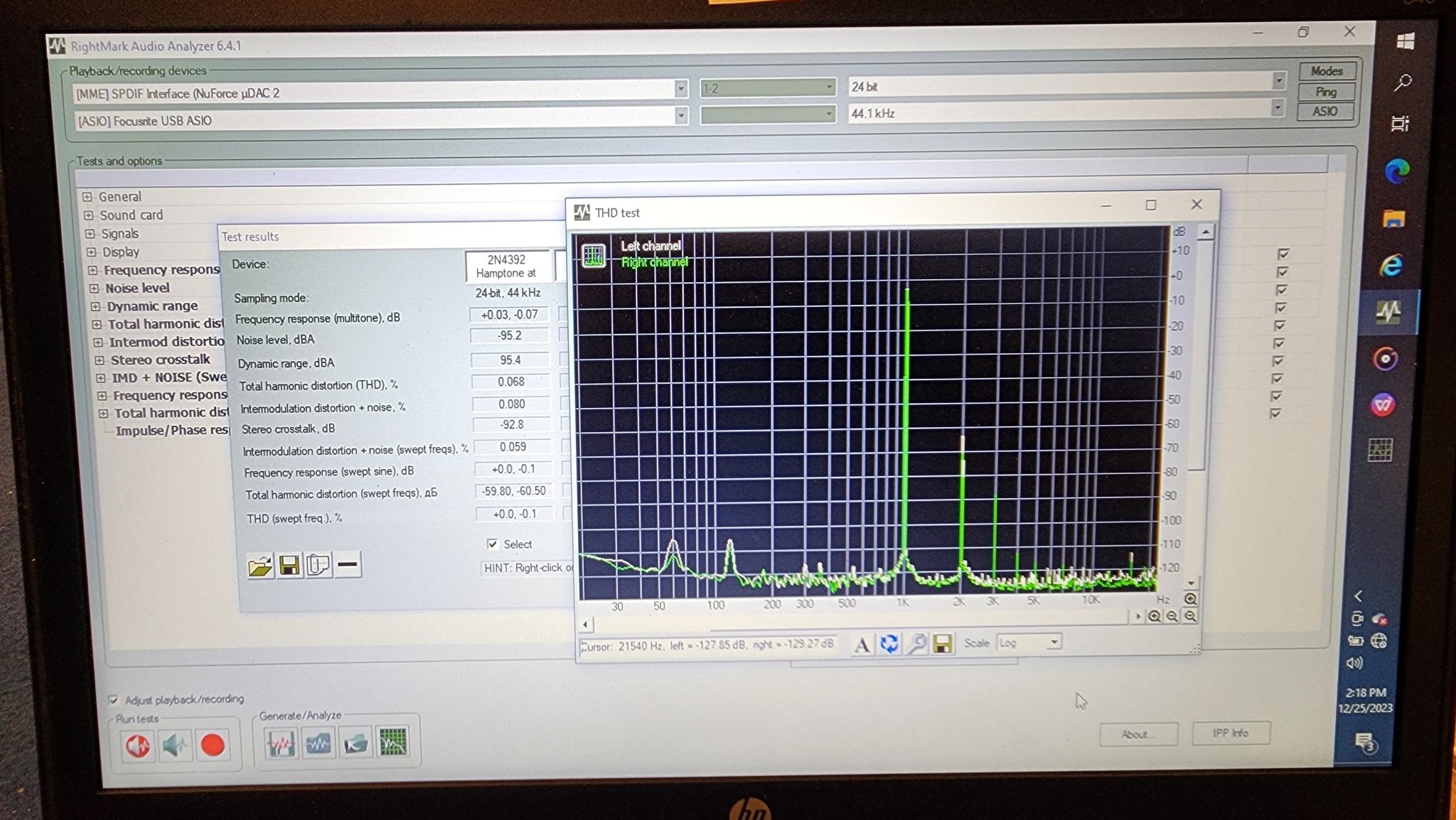

That takes me so far back in timeHad to ground the pot case, as it was buzzing when touched. Now its quiet.
Definitely worth exploring further.
It works from 15 to 25 vdc, i use 18 vdc regulated.
I can remeasure at 1Vrms and see what i get.Yes, I have simulated a bunch of Hamptone.
