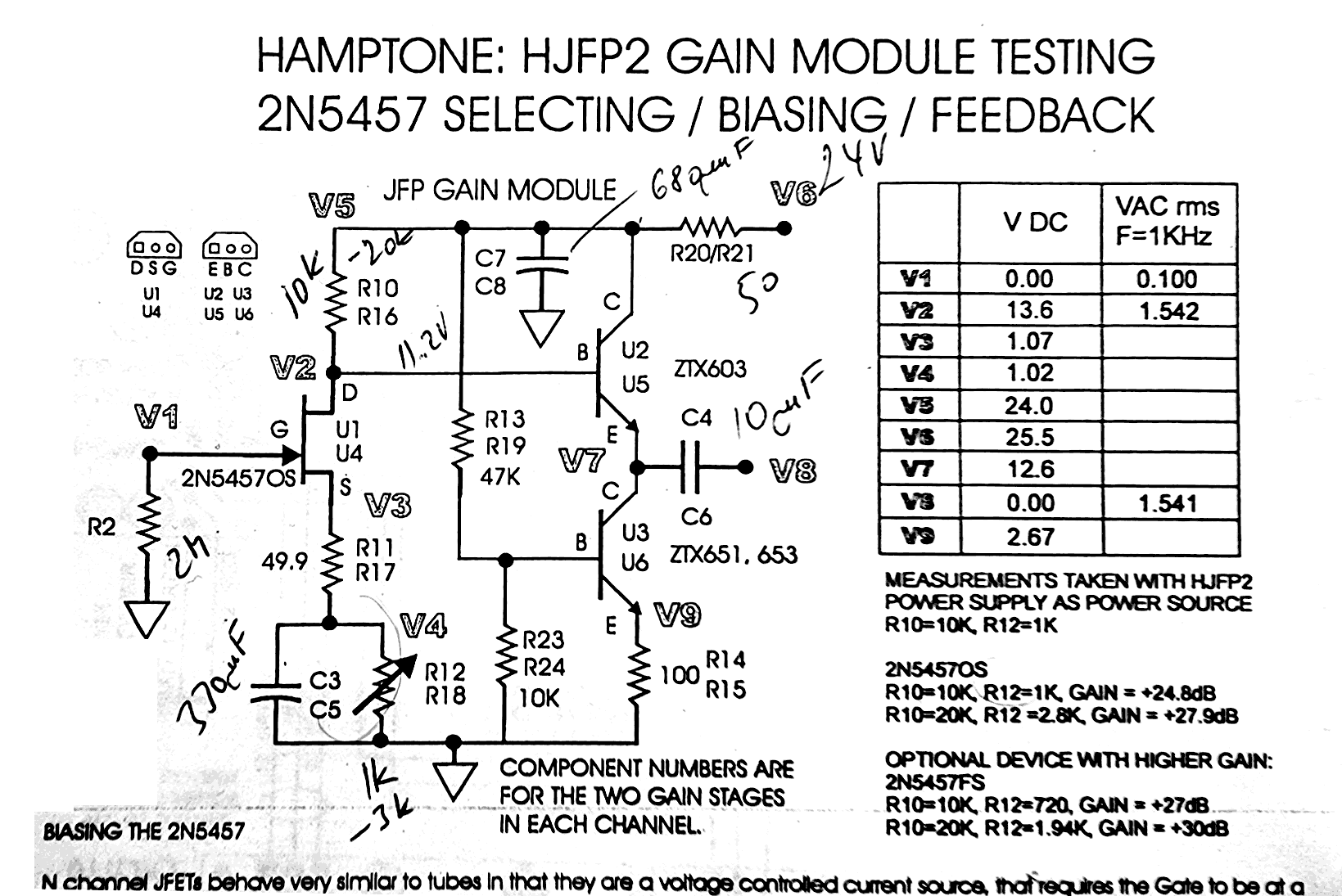

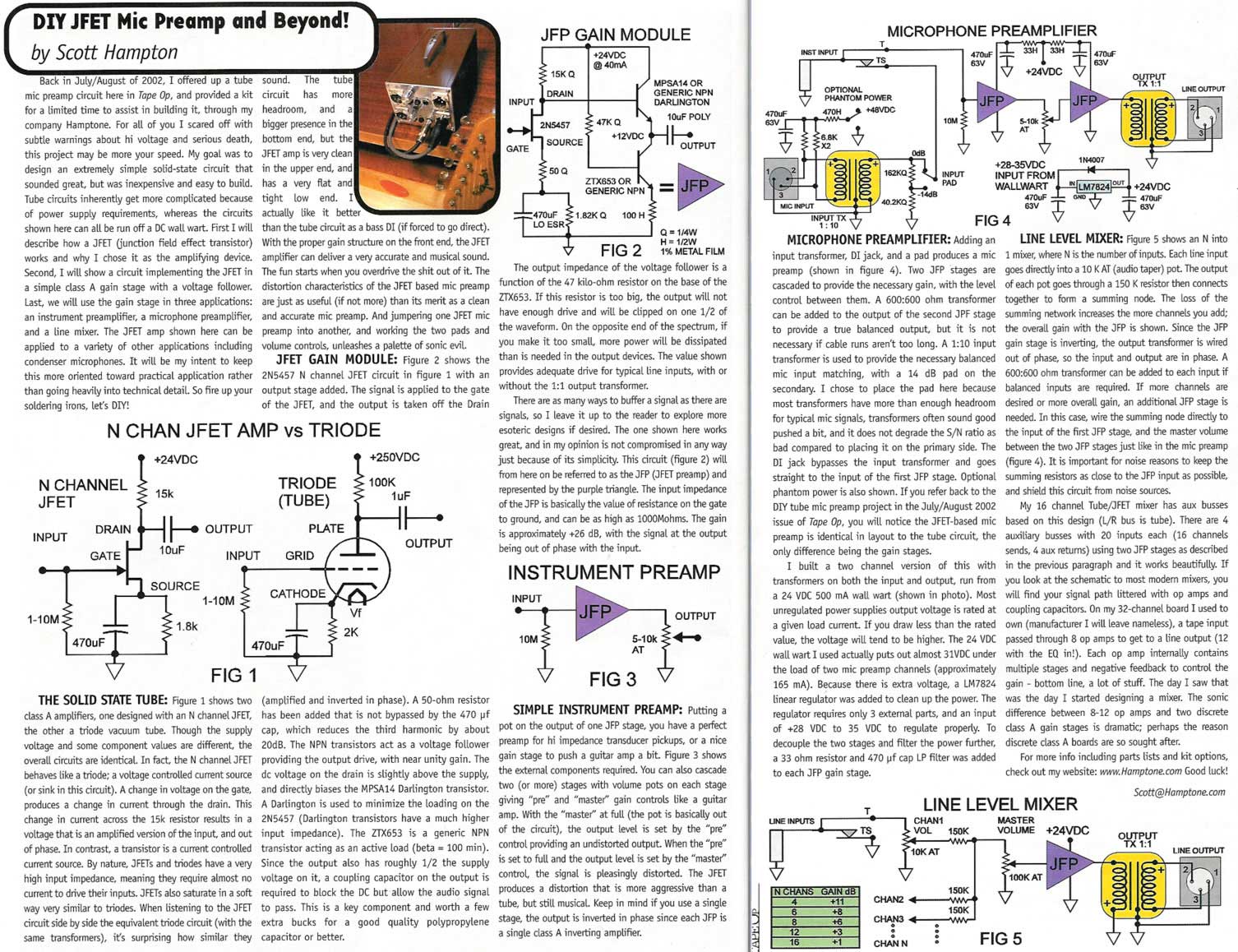

Any experiences with this little circuit?

It's allive! Well, i found 2N4392, so thats what i used.
Could not located mpsa18, so i used 2xBC550 as darlington.
Used C2705 for lower bjt as current source, since i have plenty from yamaha pre repair.
I found small pcb from other pre project, so i improvised.
It sounds juicy, musical, with nice second harmonic sweetness to it.

Ok, please do, if it looks ok, i will definitely try it.

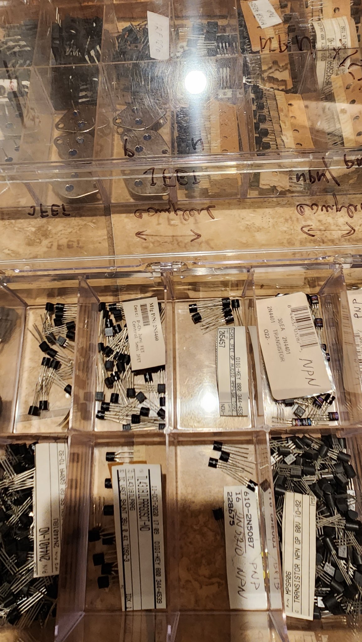

I made a typo in previous post, i was looking for mpsa14, darlington, not mpsa18...those i found plenty, as well as mpsa06, 42, 92 and others. None darlington. Hence i made my darlington from two bc550. But i am certain i have mpsa14 somewhere.
If irf610 works, i have plenty too.

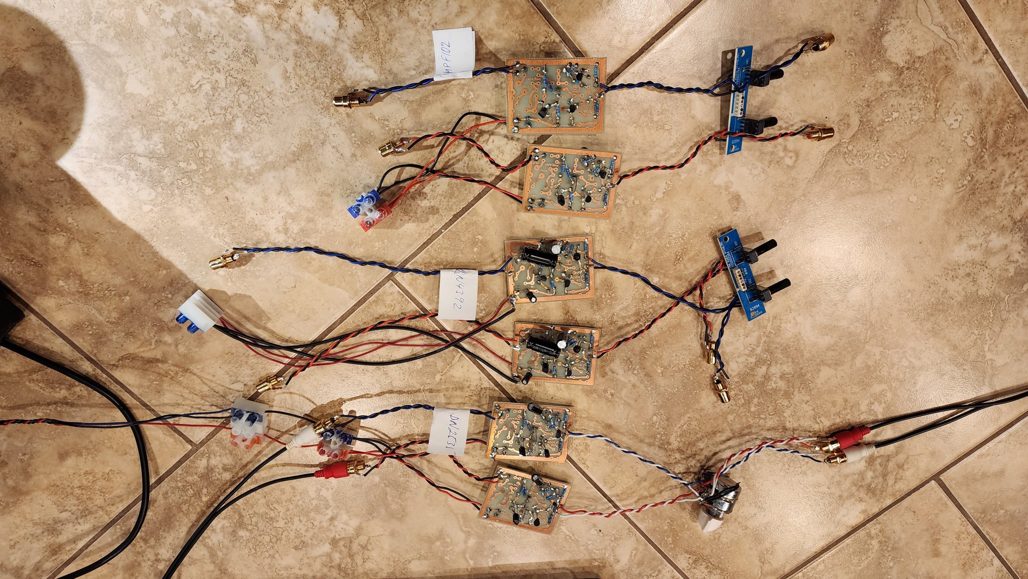

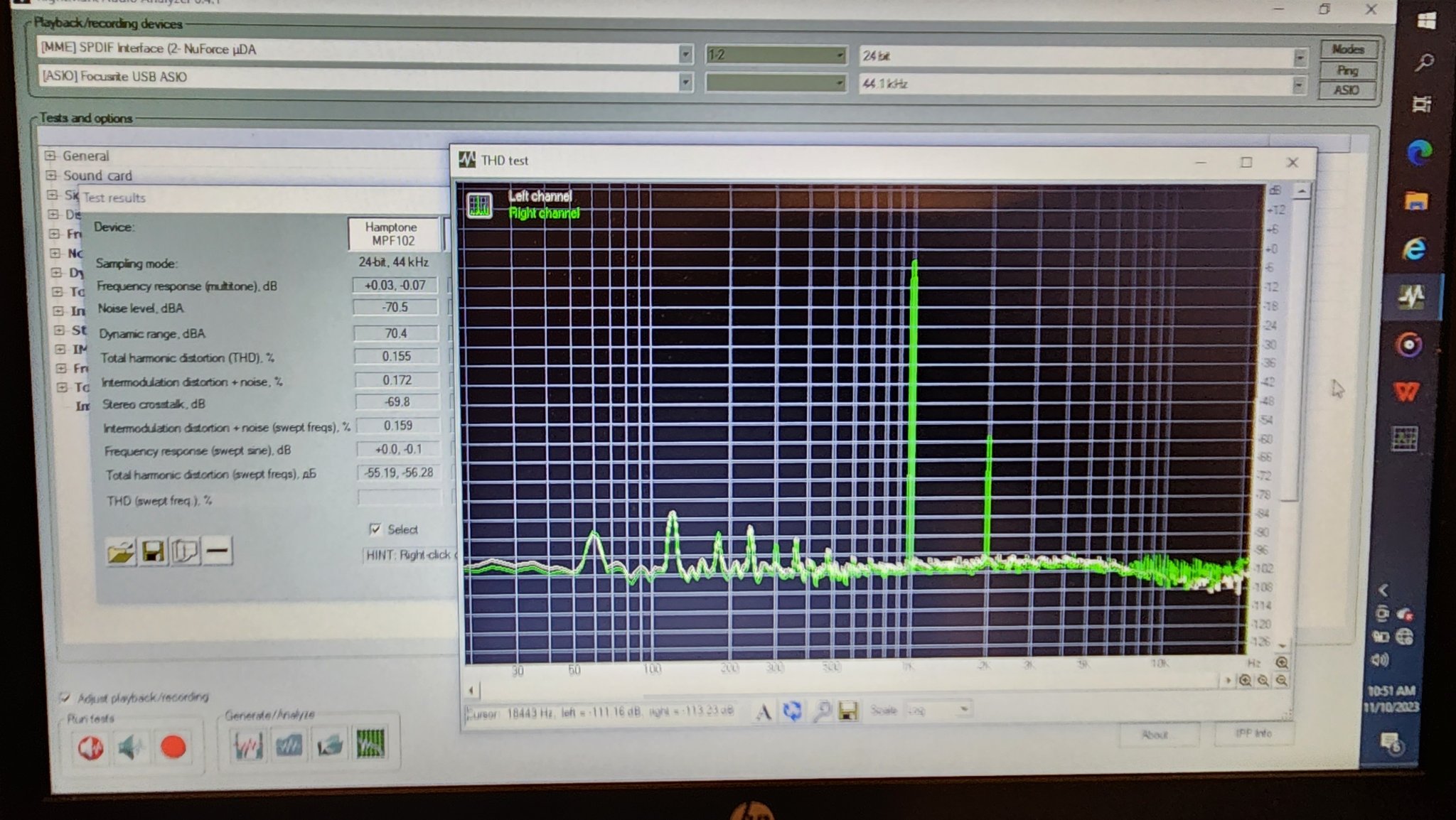

Since its raining, i made some progress. Made second set with 2N4392. Both perform well. Due to variations in jfets, there is some disbalance between channels, so i recomment matching.

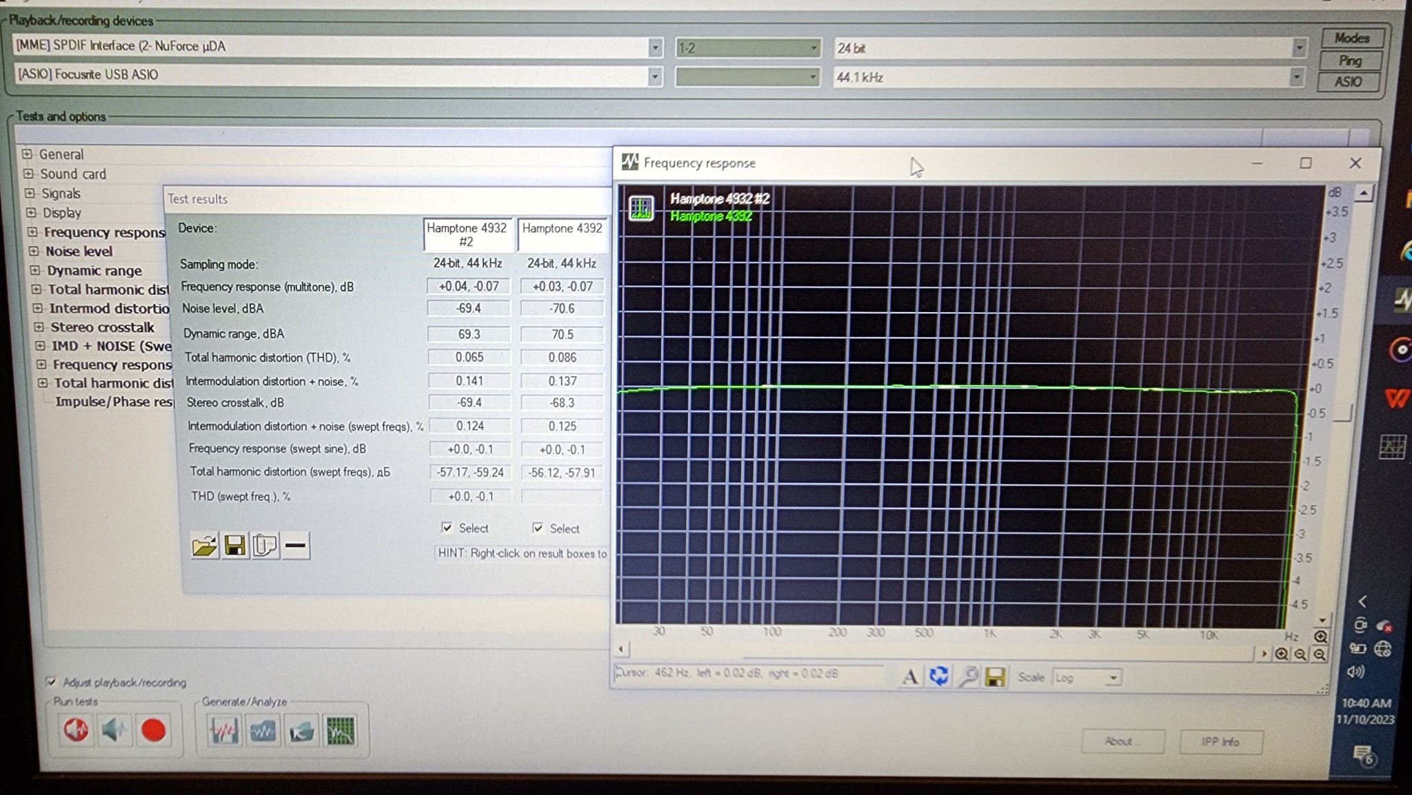

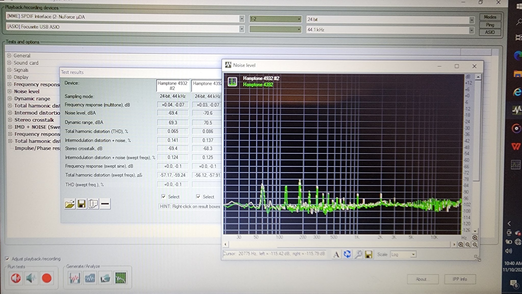

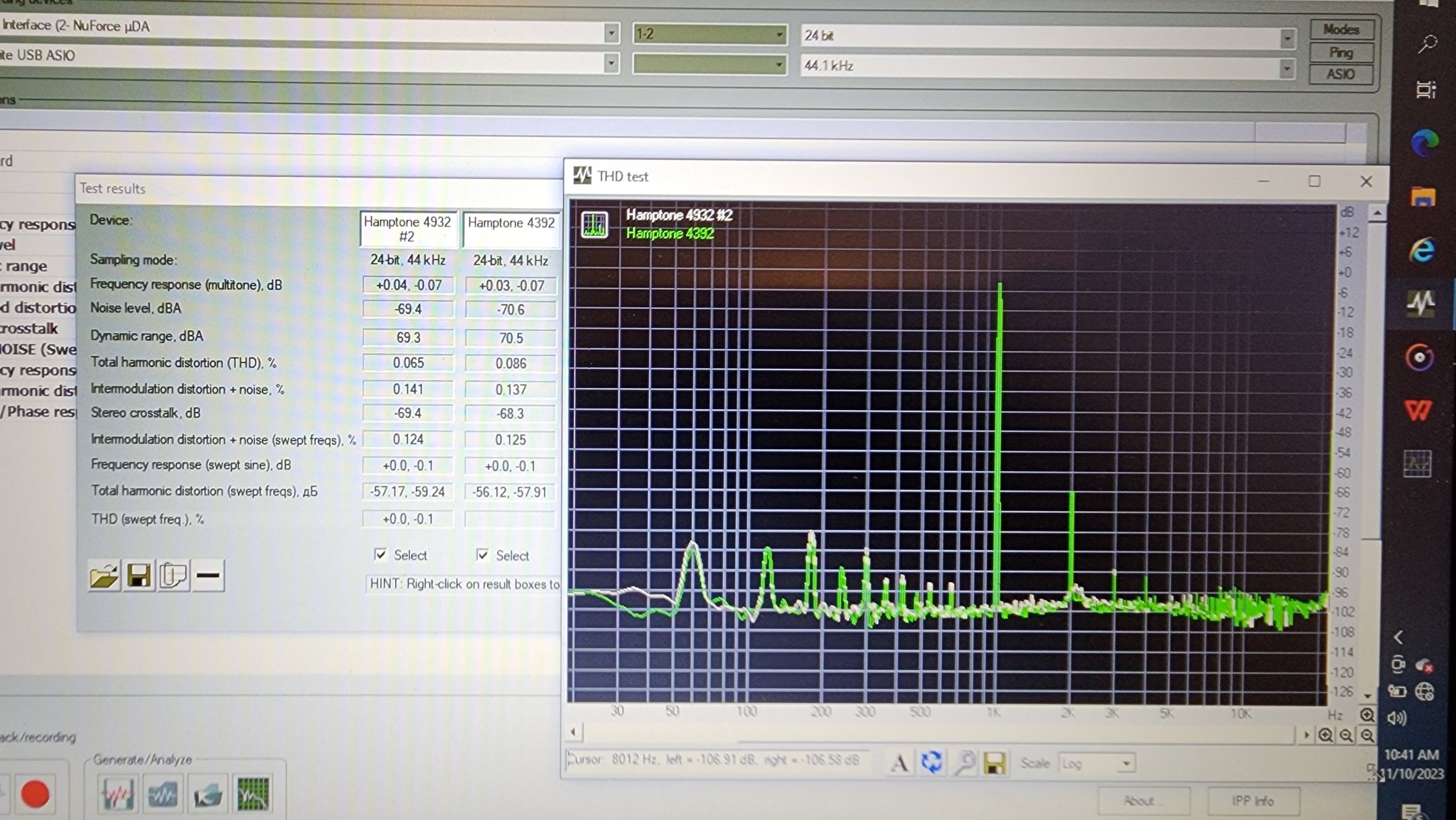

Both sound great. Thd is ~ 0.06% to 0.08%. Most importantly, pure second harmonic, very little 3rd and up.
Here are some measurements from rightmark.

Building more clones, will be testing various input jfets. First i will try 2N5457, originally used jfet in the hamptone. Than this is what else i found in my stash. I am aware that some jfets might need some bias adjustments, i am not going to individually deal with it for now.
2SK246
PF5102 (i think this is replacement for mpf102)
J112
J113
LSK170
2SK30A
Then i found some, which are not jfets, but small depletion mos, not sure if they would work here, but it may be worth the try.
DN2535 vfet
BSS129 dmos

Well, back from vacation, i am going to compare three working prototypes of hamptone preamps. With and without the caps.
All will be measured at same pretty high level, to utilize full scale of sound card and satisfy rightmark software. At 388mV rms, 1.12V pkpk.
