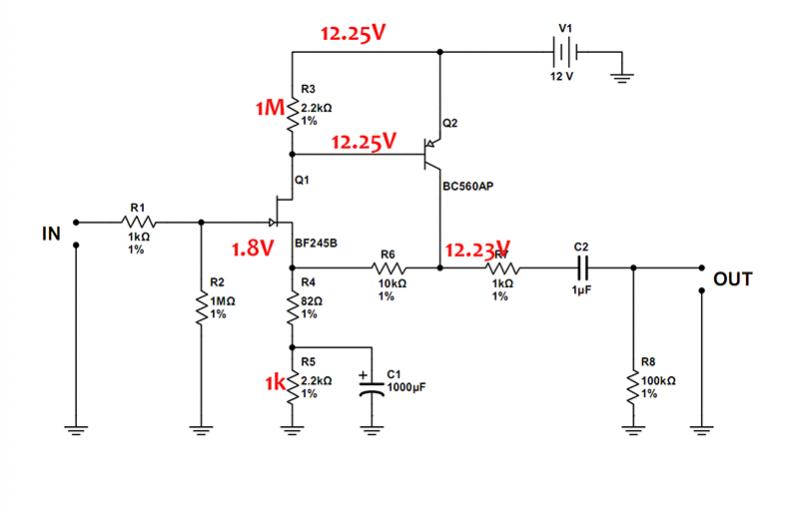

Anyway, i have made further modification to the circuit per your and PRR suggestions and these are my voltages ( Not good i cannot dial 6V on Q2. In fact i cannot dial anything down from 12V on the collector);

Just to confirm: R6 is 33k now, and R4 is 270 ohms, correct?...Not good i cannot dial 6V on Q2. In fact i cannot dial anything down from 12V on the collector);
If so, the result you just obtained is actually good: remember, the goal was to increase the current through Q1, allowing you to use a smaller value than 1M for R3. (1M is absurdly large, as we discussed before, it means Q1 is flowing only a fraction of a microamp, which is about a thousand times too little for it to work properly.)
The changes you made have now increased the current through Q1 (yay!) But you have not yet decreased R3 to match. That's why Q2 collector voltage is stuck at 12.25V.
So the trick now is to find out what drain current Q1 is flowing, and pick R3 so it turns on Q2, but only just turns it on - that way, you can dial Q2 collector to 6V with your 5k trimpot (R5).
I'm going to make a guesstimate, based on the voltages you posted, and walking in small circles scratching my head and thinking for a few minutes. Try 680 ohms (not kilo ohms) for R3. I think this will get the circuit close enough to balance that your 5k trimpot (R5) should do the rest.
But lets suppose I guessed wrong. You used 680 ohms for R3, and the collector of Q2 still stubbornly remains above 6 V. This tells you R3 is still too big, so try 560 ohms. If that doesn't do it, try 470 ohms. Et cetera.
Suppose, on the other hand, with R3=680 ohms, the collector of Q2 now sits too low (2.5 V, say), and cannot be raised to 6V with the 5k trimpot R5. This means you need to increase the value of R3 - so try 820 ohms. Still too low? Try 1k.
By now, you are probably cursing under your breath. So am I - all this fussing and fiddling is the result of a marginally designed JFET circuit, which is not tolerant of any significant change in JFET parameters. (It is also a circuit with limited headroom before it clips, as we saw earlier - IMO 12V is far too low a supply voltage for a modern preamp. It's even too low for a modern guitar FX pedal.)
Anyway, I think this will finally give you your happy ending. At the least, you should have your preamp working as you were originally expecting it to work!

Yeah, there are a couple of little mistakes on that diagram. But you can figure out what's happening from the text and the history of the thread so far.So how can Q2 fully conduct without any base-emitter voltage?
I bet the base of Q2 is actually near 11.7 or 11.65 volts now, not 12.25V.

After a long time i can reply as it would seem quite rude to leave without the conclusion.
Unfortunately i had to take a break from this preamp project ( Gnobuddy said it right. I was starting to seriously "curse under my breath") as in the meantime i was switching careers, renovating my work space, living arrangement and basically starting something new.
Anyway, i did not forget this preamp project as i am a very stubborn man so i would, once again, like to share some numbers.
Results from today;
Q2 Emitter 11.70 V
Base 11.70 V
Collector 6.61 V
Q1 Drain 11.70 V
Gate 0.00 V
Source 1.85 V
I hope i tied the pinout names with voltages correct. In regards of Q1, the voltage i was stuck before (0.77V) now i managed to adjust to 1.85 V

That sounds good! Glad you finally got it working properly!Q2...Collector 6.61 V
