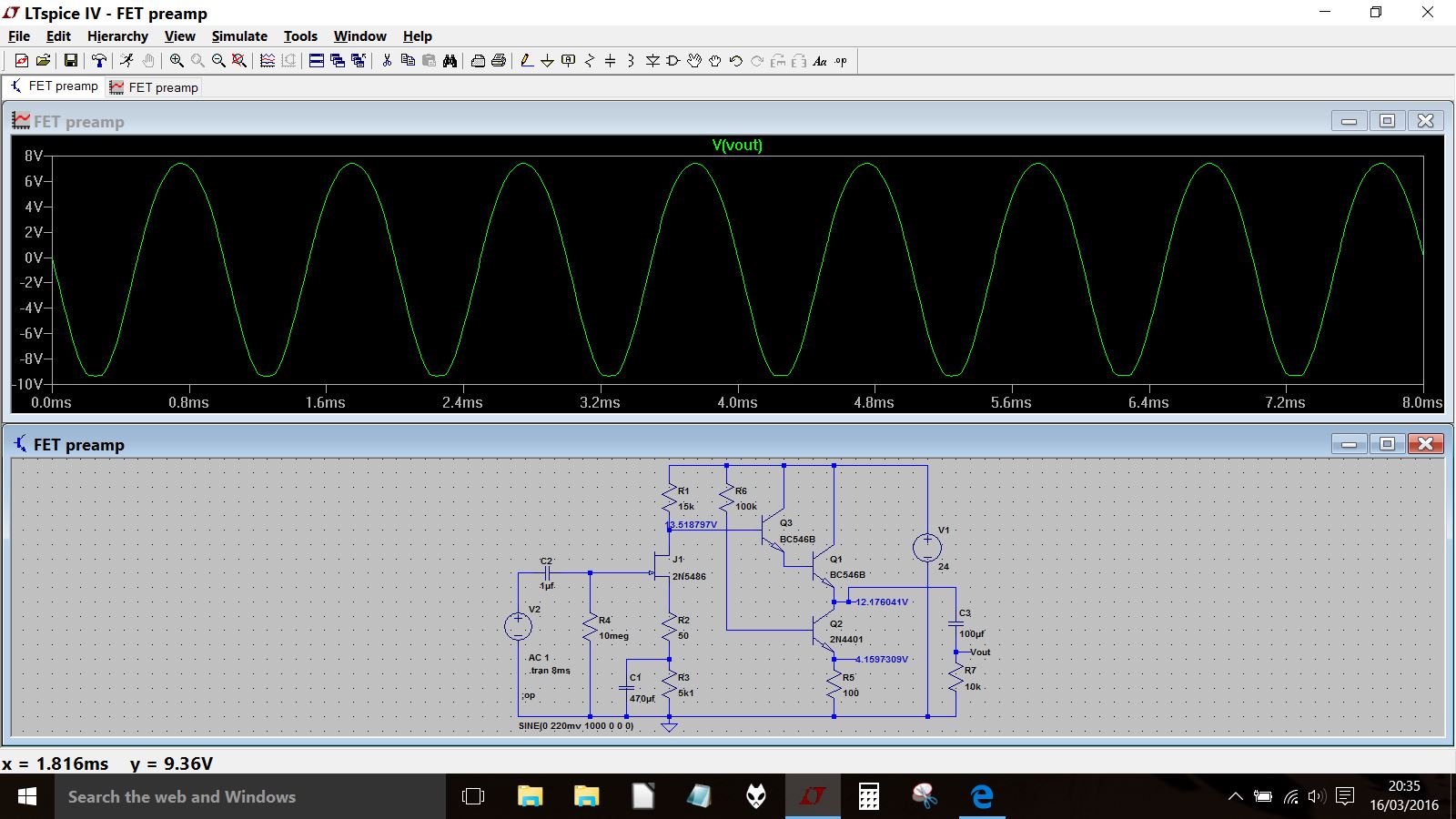

Symmetrical clipping... give me a minute and I'll try it.
Last post for today 🙂

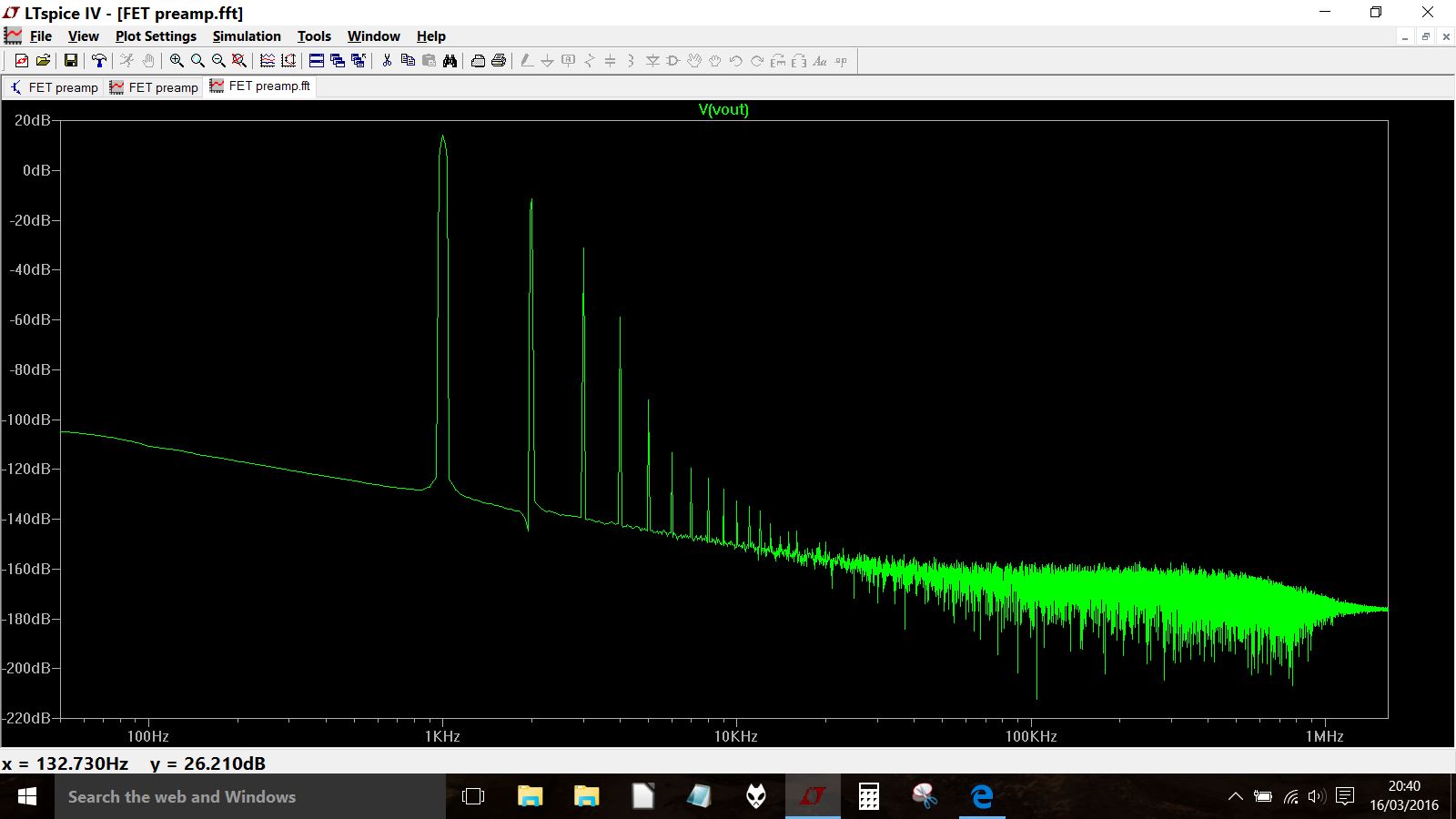

So... the clipping is definitely assymetric even when overdriven grossly. You can see the waveform taking on the classic look of lots of second harmonic distortion. You can see the DC voltages I set up for this.
And here is the FFT plot with the amplitude reduced below obvious clipping.
It would be interesting to try and optimise it at lower levels... one for tomorrow maybe.

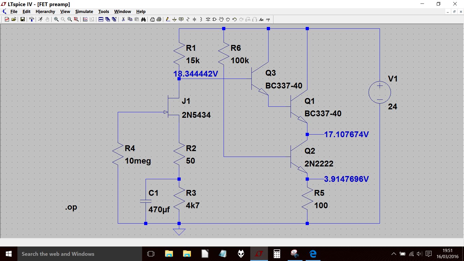

The one adason posted looks much better at a quick glance. It should be far more reproducible and with more consistent results. Another major disadvantage to the first one is that the gain is somewhat dependent on the individual FET used which is not good.
Ideally a (simple) circuit like these should work consistently well with pretty much anything you throw at it parts wise.
I am not too worried about different gain using different jfets, since I have been measuring and matching jfets using the runoffroove technique and calculator from their article on the Fetzer Valve. I know that given that that design is slightly different, the gain won't be the correct number, but it will give me relative comparison.
But could you explain how is it that the one Adason shared is NOT dependent on the individual jfet? Is that because of the feedback?

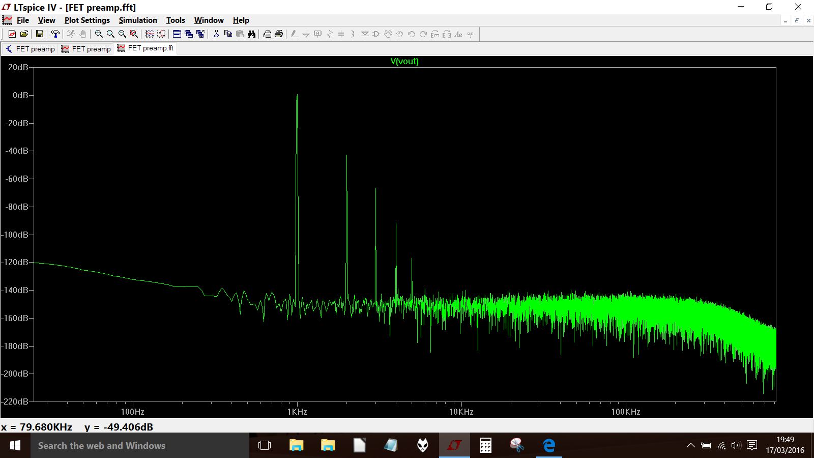

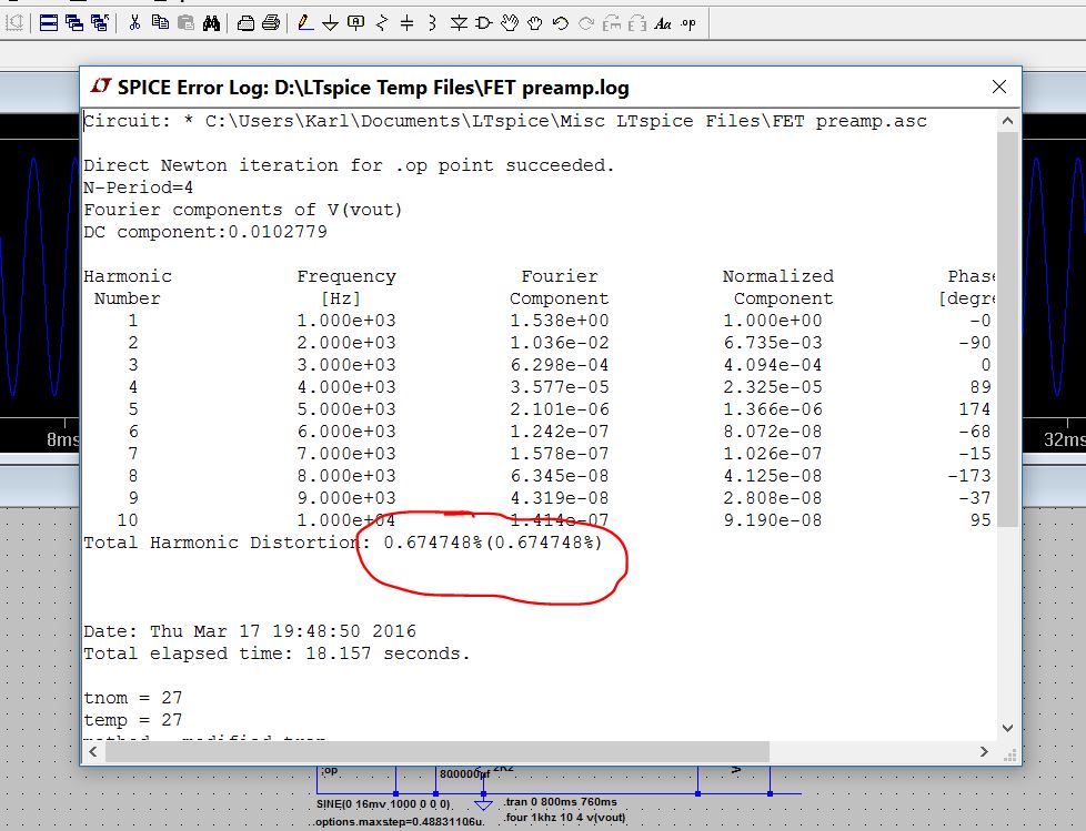

Well I threw this one into the simulator as well and it's perhaps not quite as 'good' as I first thought. The gain is still a little FET dependent which is a concern when you need to build a stereo pair. You want both channels to be the same.
This shows the distortion for 1 volt rms output into a 100k load.

If you want a bit of colour in your recordings then I think either of these two would fit the bill. I'll attach the LT spice file of the preamp as it stands now and then if decide to have a play you have a head start.
