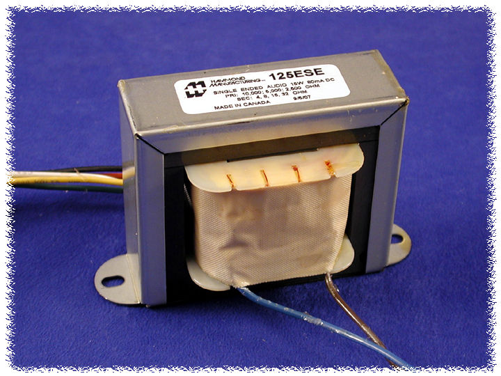

from Japan? Hammond 125ese

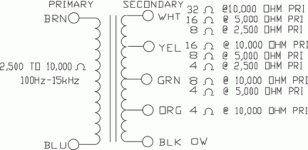

For the OP ( post #5) , check with Jensen for specs of the p12s- they should have it.
https://www.jensentone.com/search?search-value=Jensen+p12s

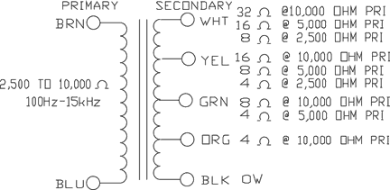

https://www.jensentone.com/frequency-response-comparison
All versions of the P12 have response that starts dropping at 5khz and are 20+ DB down by 10khz.
Steve
"Extended" means a bump at 5kHz-6kHz, which is "high" for a Twelve.Jensen p12s is extrended range speaker from 50´s, i don´t know response curve.
NOT "full-range" without a tweeter.
Put any decent 2-way speaker on that amp. 15KHz is plenty for cymbal, and my one experiment with 125ESE did not show a real droop at 15KHz.
