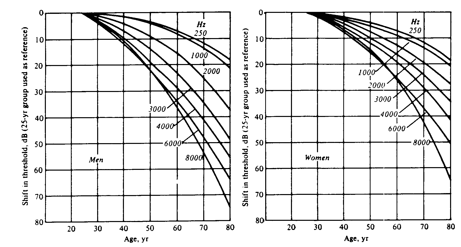

So it sounds like John007's problem may be either the speaker, or something listed in post #20.

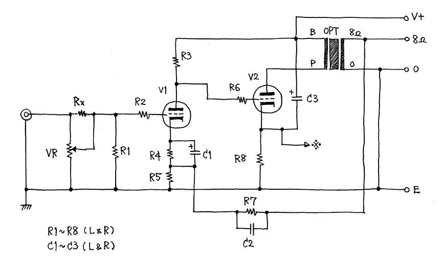

Schematic time; picture of the inside of the amp time.
It could be the front end, tone stack of the amplifier and nothing to do with the transformer. Or it could be the coupling between stages. To find the fault you really need to sweep each stage etc.
Lastly even with an OPT of limited BW of up to 15khz ish high's should be well audible; anything in music content over 10khz for most of us is irellevant.
Andy.

I agree with this gentleman. I have a 12B4/6au6 triode SE amplifier with 125ese transformers. Your thread had me check them with the signal generator and scope. My results are the same as above. I have three possibilites for your consideration. 1.) Check your hearing. 2.) change your speakers. 3.) Change your amplifier circuit.
My 6AU6/12B4 is not lacking in response with my garage Altec model 9 speakers. My hearing being 65 now isn't what it used to be. I respectfully suggest that you check your hearing first followed by posting the schematic of your amplifier and the particular speakers your using along with their specifications.
