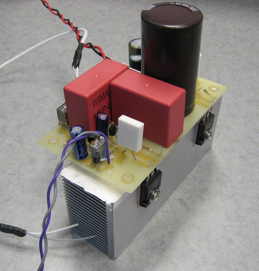

Here's a pic of the breadboard for one amp channel for the newest revision Half Nelson that I'll be using for initial tests. Since this amp (just one channel) will be blowing about 50W when set up properly, there will be a fan blowing full tilt on the heat sink. The real deal will be situated on a much larger heat sink (probably with a slow fan), but that's for later. The circuit uses a Semisouth 085 depletion mode fet and an IRFP9240 in the output stage. A schematic will follow when I'm satisfied with test results.

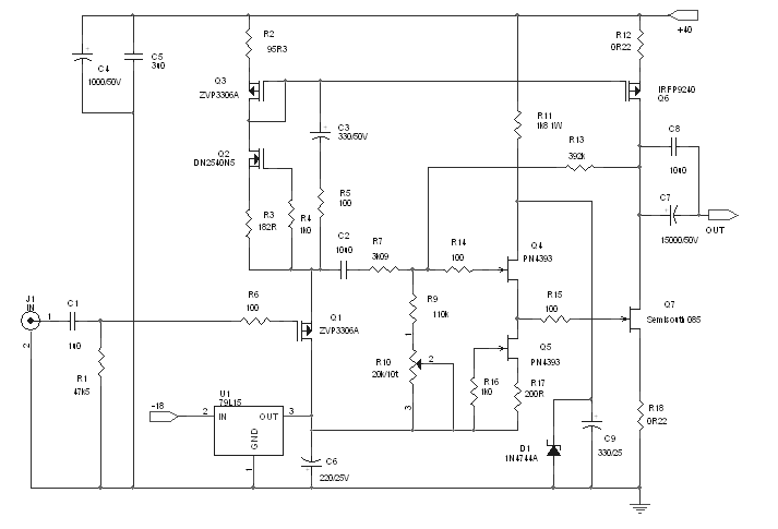

I was interested enough to try simulating your earlier posted circuit but couldn't get an amplifier out of it after swapping a couple parts for what I had models of. I think I found that either its a pretty finicky circuit or that I don't understand it very well. Looking forward to the next schematic.
It's not a particularly finicky circuit, either in simulation or in practice. Take a cue from the schematic in post #7 (which actually works fine in simulation - it was the one used to generate the subsequent simulation data) and use a current souce in place of the LM317 or Supertex depletion mode mosfet used in the actual circuit, and it should simulate just fine. That's probably what's tripping you up. I've been setting whatever current source I've been using to 10mA, so that's the value you should use in simulation.
I've been using PSpice for my simulations, which has models for all the rest of the semiconductors, including the Zetex ZVP3306 mosfets I'm using for the input buffer and output stage biasing. Those are relatively important as well. If you use a larger device (say, for example, the IRF9510), the bias point for the output stage will be different. It can be made to work, but you'll have to change the biasing resistors around.

The breadboard amp is settling in on the bench as I write this. It's running right now at about 40V Vcc and about 1.3-1.4A bias current - stable so far. An 80mm 12V fan a few inches away from the heat sink is enough to keep the heat sink just warm. At home. I'm using a 120mm, 12V, 0.14A fan to cool the original Half-Nelson amp in my living room. Run at 6V, the fan is barely audible, and keeps the heat sink almost stone cold just sitting on top of the heat sink with no sort of cowl or air guide whatsoever. I think the 120mm fan will adequately cool whatever heat sink I decide to use with the second version of this amp, even though it will be dissipating about twice the power of the original.

Here's the schematic I'm working with - very similar to the original Half Nelson, but with a negative supply added so that I can properly bias the Semisouth depletion mode fet. I also took the opportunity to return the drain of the input p-channel mosfet to the negative supply to give it some more voltage headroom. A current source has been added to the jfet driving the output fet gate, more or less because I could. The pot it used to adjust the centering of the output top 1/2 Vcc for maximum symmetric operating swing.
The amp works (it amplifies!). However, I'd like the gain to be a bit higher (it's around 11X at present). Also, I'm not getting as much undistorted output swing as I'd like. Finally there's some well damped overshoot in the square wave response. I'd rather have a slightly overdamped square wave response.
Anyway, these matters are more than likely fixable, I'll just have to sit down and probe the intermediate stages to find out what is going on. A qualified success, anyway. Also the amp comes up when I switch on the bench supply without going berserk or blowing up, indicating that the supply sequencing may not be as critical as I thought. I intend to use a capacitor multiplier to smooth out the +40V supply this will also slow down its rise time, which may be beneficial. It certainly got rid of the turn-on thump with the first revision of this amp.

The original "Half-Nelson" is being fitted with a +40V (or thereabouts) Vcc supply and a fan-cooled heat sink, and will be slouching its way back to Burning Amp this year to tangle with Nelson's slot-loaded speakers and Berndt's pricey setup. The fan is a 12V, ~120mm beast powered extremely cheaply and cheerfully by a 6V, 100ma adapter picked up for a song or two at Halted Specialties. Running at about half voltage (the output of the little unregulated adapters is quite elastic depending on load), the fan still moves quite a bit of air, but is almost silent. Nobody's going to be blistering themselves on my heat sinks...
The beast has been refurbed, and has been pumping tunes in my basement for the past couple of hours. The fan is reasonably quiet (still looking for ways to quiet it further), and the heat sink temperature is merely warm. A picture will follow tomorrow at a convenient stopping point, as I'm now going all out to get Le Mutant into a case, followed by the "SiC Puppy".

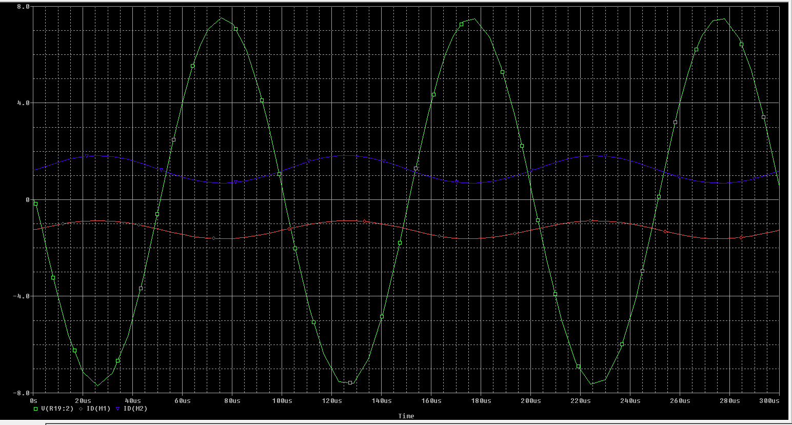

Here's what I have so far. I'm halving trouble with convergence with a high resolution sim, so there's more work to do before I can show results for a distortion sim.
