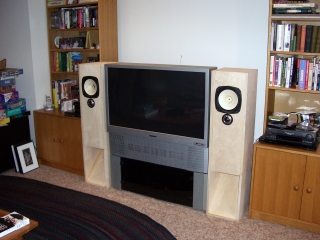

Half Chang build
Actually, I've got a huge mess of braised short-ribs in the oven that will be ready around 4 pm EST today, along with some scalloped potatoes and sauted carrots. Then there a several bottles of wine. Even with family here for the holiday there should be plenty for another visitor or two.
Maybe a bit late to catch a flight from AZ, but you are welcome any time, just drop me a line!
Bob,
I like the new arrangement!
I'm close to gluing the front baffles onto the HC's so I can do the final tuning of foam lining and BSC. Looks like I have to deliver them to the kids w/o completing the staining & finish, as the weather has turned too cold now. That will give me another excuse to go spend time w/ the grandkids while I complete the finishing at their place. 😉
Merry Christmas (and happy new year too,)
Jim

I won't speak for Martin, but when he was at my house to listen to the half-changs I seem to remember him speaking favorably of the Half Changs in comparison to the ML TLs - at the least in terms of LF response. Maybe he'll chime in here.
OzMikeH -
Our 2 cats don't bother much with the speakers except to rub facial scent on the corners and to peer at the lower openings, completely perplexed, during some vocals.
I think the half-changs are a step up from the ML TL in terms of bass output. The amount of BSC required for the ML TL is very high, it was much much less for Bob's speakers. The half-chang is an excellent design that I would definitely recommend for a FE-206E driver.

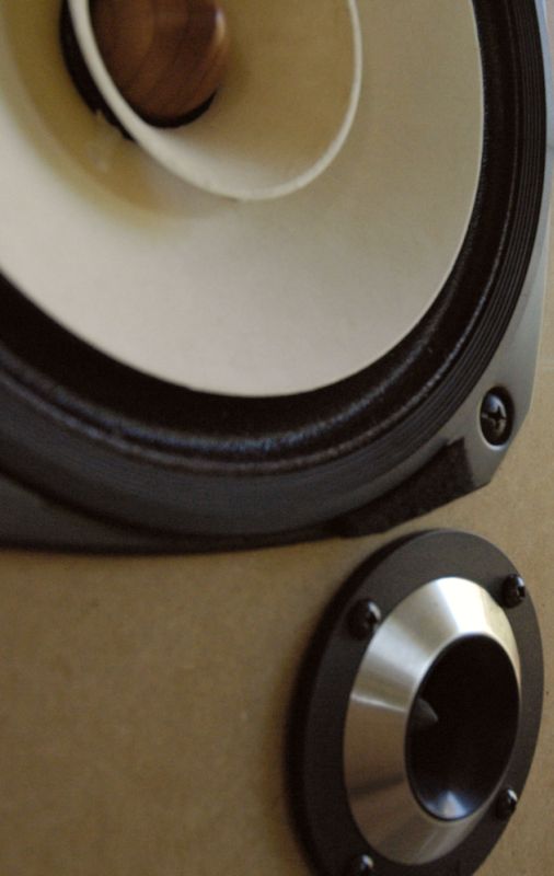

Tweeter placement with B20 half chang?
I'm going to be building a set of half-changs this weekend using the Pioneer B20 driver and the small tweeter from PE.
Where should I put the tweeter on the baffle? Above in the center or to one side? Other options?
I put them below.
Above or below, closest to ear height. Best not to put them on the centre line. same distance to multiple edges doubles the diffraction effect of the edge.
I measured across my baffle and put them at at the golden ratio point across it just for the sake of picking a number.
for example, if the baffle was 161.8mm I would have put it at 100mm from one edge.
My Marantz PM550DC has a hum problem 🙁
I wish I'd never sold my gold ??500?? power amp with the vapour phase heatsink and big VU meters. can't remember the exact part number. At least it went to a good home.
edit: these Fe207 and 206 require phase plugs and a good thrashing before they are any good. If I bought another pair I'd take a knife to them straight out of the box.
