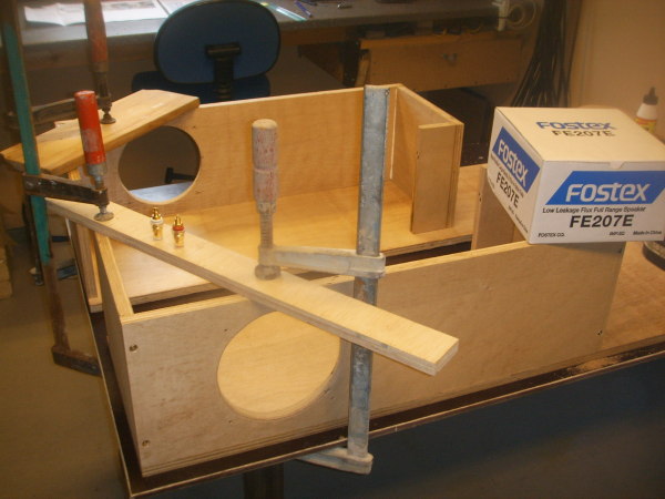

I cannot ressist putting a picture of my ongoing project ... sry ...😉
I was so lucky, that the compagny, where i work, just got a new pro. circular-saw. It's a giant, with a nice big sliding table, with mm-indicator (what its set to you get excatly within 0,5mm 😉) so cutting wood is very easy. Also the circular-saw, has a small dual/opposite rotating backside cutter (English ehh??) So no damage is made to the ply, on backside when cutting !!!...
I took a picture, assambling some wood, for HalfChang. The finish, when done, will be the same as Bob Trancho's.
Jesper.

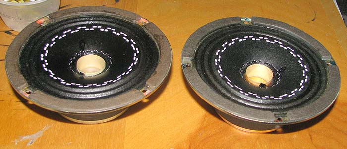

PS: that gift batch is finally starting to march thru their last service here (example below)...

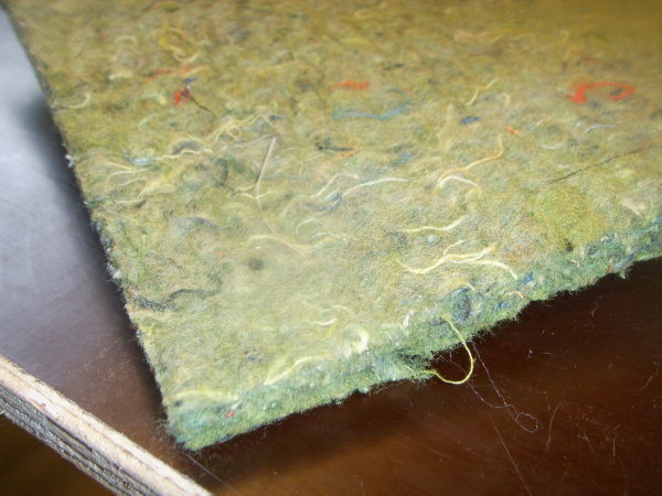

As this ''woolcarpet'' damping material is kindof hard to get here in DK, i found some lookalike, used to damp noise in cars etc...
Do you guru's 🙂 think it's ok to use this ?
Jesper.
EDIT: Size 8mm.
