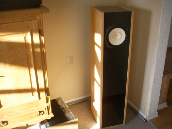

Soo, here is my final result! - Nice BobTrancho clones 😉
I have been listning to them, for 4~5hour's now(No burn in), and i must confess, that i find them very clear in sound... well allmost to clear for my taste i must say.... Dave told me this before in this thread :
Don't judge the bass until you have at least a hundred hours on them. But you will need a woofer to get the last octave. Using a woofer for the last octave & a half or 2 will improve the mids if you roll off the bottom of the HC.
dave
Well, i have only been playing with them for around 4~5hour's, as i told before, but is it really true, that the sound will change dramatically after some hundred hour's ??? - I find it a bit hard to bellive through.
I was writing in another post in this thread, that i was really satisfied with them, but i kindoff changed my mind a bit about that, after listning to them intensily. I think the sound, is like a bit distorted, but not with all music !!! ... Most modern pop-music sounds worse on thoose speaker's, than on my old one's. Is it driverbreakin time? is it the purity clear sound (Real i think) which is problem, or is it just me?? or is it, that i now can hear bad-recording's very clear ???Please help me out 😕
I tried different thing's, to sort out my problem, thirst i was thinking it was an Amp problem, so i disconnected all my PassDIY gear, and attached my LeachAmp directly to my CD Variable out... The sound is still strange to me... so it was not my amp's...
I will try to descripe what i found not to like my taste :
A bit (only bit) lack off bass (proberly come after breakin, as Dave wrote)
Guitar-distortion like sound (hard to explain)
Very high Top, and topend sound. (A little distorted i think, but not with all music)
Jesper
Get a 100 hrs on them and then you tell us.
With these SS amps you probably want to run solid skinny speaker wire... no firehouse stuff...
dave

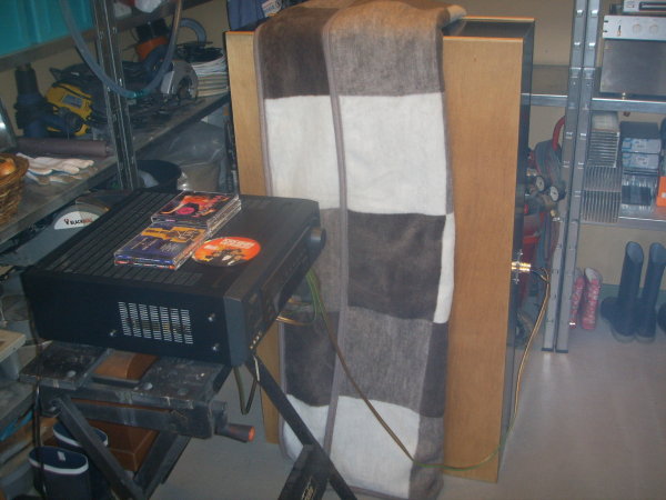

"but is it really true, that the sound will change dramatically after some hundred hour's ???"
It's not too hard to find out for yourself, if you have a spare little amp and a basement or other section of the house that is little used. Face the speakers together, wired out of phase, turn up the volume until it doesn't quite annoy you in other parts of the house. Leave em playing the radio for a week. Particularly if you are not pleased with the sound of them at the moment, it'll be over before you know it. Beats suffering with them while they break in. Play 'em while you're at work if you don't have a spot to hide them while they make noise.
If you do it quick like that and don't listen while they're changing, you'll be more likely at the end to be able to say that the speakers have changed rather than that you have gotten used to them.
Ok Dave, as you say 😉
Ok AdamThorne I'll do what you told me too, for a week or so 😉
Thank's for keeping my mind (and ears) up guy's...
Actually, i have just ordred some different coils, and a resistorsort-box. It is a speakerproject, i do for my mom and Dad, repairing theyr'e old B&O loudspeaker's. Replacing the Tweeter/Mid and Bass with a Visaton BG20 fulltone, which fit's in that very old B&O chassis.
I will try, to make them sound acceptable, with or without a BSC filter, so what's left from coil's/resistor's i have to experiament with, with my HalfChang's, when they'e done burning in (6-7 x 24hour's i guess)... I will let you know.
Jesper.
