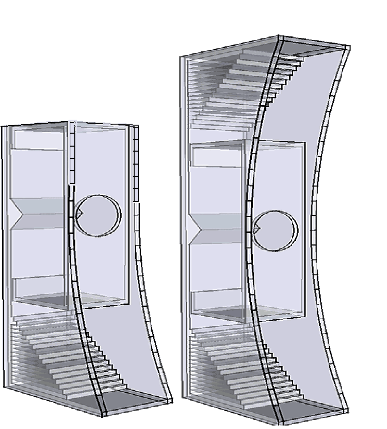

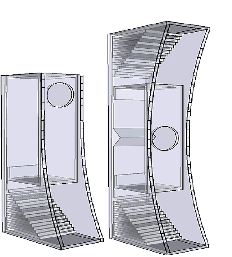

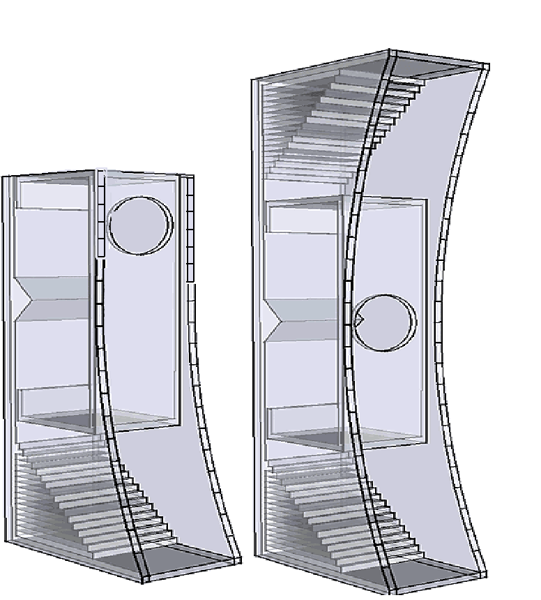

Why have you curved the front of Half Chang?
It looks cool. I don't know really. But would it affect the sound? It kinda takes away that boxy look and adds a bit of a curve to it.
Peter C.
Peter C.
Yes; I haven't checked properly yet of course, but I would anticipate that it will throw the alignment somewhat out of kilter. The curve on the full cabinet is not an aesthetic addition, it's functional.
