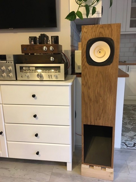

Hi all,
Let me present my Half Changs Fostex FE206En, finally completed yesterday.
Initially built with an exotic plywood, which didn’t look well, so I covered them by oak veener and finished with hardwax.
Now playing with 3.6R resistor, but going to add an 1mH inductor to smoothen mids and hights.
I have read whole the thread looking for the mods and I found a few.
Could you guys please share your thoughts which mods are most impacting the sound, best to start with them?

@gallileo1982,
Besides proper lining of the cabinet, you really need Baffle Step Correction. BSC makes a huge difference in the sound for a HC w/ FE206 driver. Notes from my build in 2008 using the FE206e:
--Baffle step circuit (BSC) consists of 1 mH inductor in parallel with 5 ohm, 12 watt Mills resistor on the positive lead of the driver.

Thanks Jim.
That’s what I’m going to do - add the inductor.

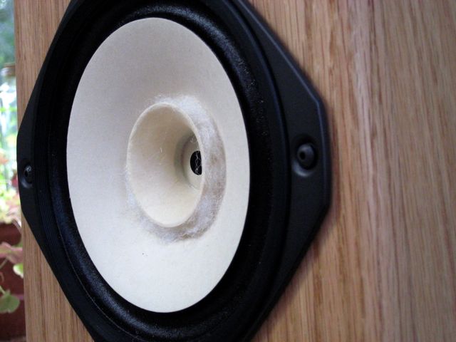

No, never tried phase plugs. Could never bring myself to cut into the cone/dust cap. I did use the 'bearded' whizzer tweek on a pair of FE167e drivers though. Just a little fiber fluff between the whizzer and the main cone toned down a small resonance that bothered me.
Cheers, Jim

I have the same concern as to cutting out the dust cup.
Could you post a picture of the whizzer tweak?
Also, what the wire gauge inductor have you used in the BSC?
Here is a photo of the FE167e with Parts Express AcoustaStuf fiber damping around the whizzer; it is well teased out, and nothing extra to hold it in, so it needs to be gently pushed back into place from time to time.
As far as I can remember, the 1.0 mH air core indictors were 18 gauge.
Cheers, Jim
Cheers, Jim

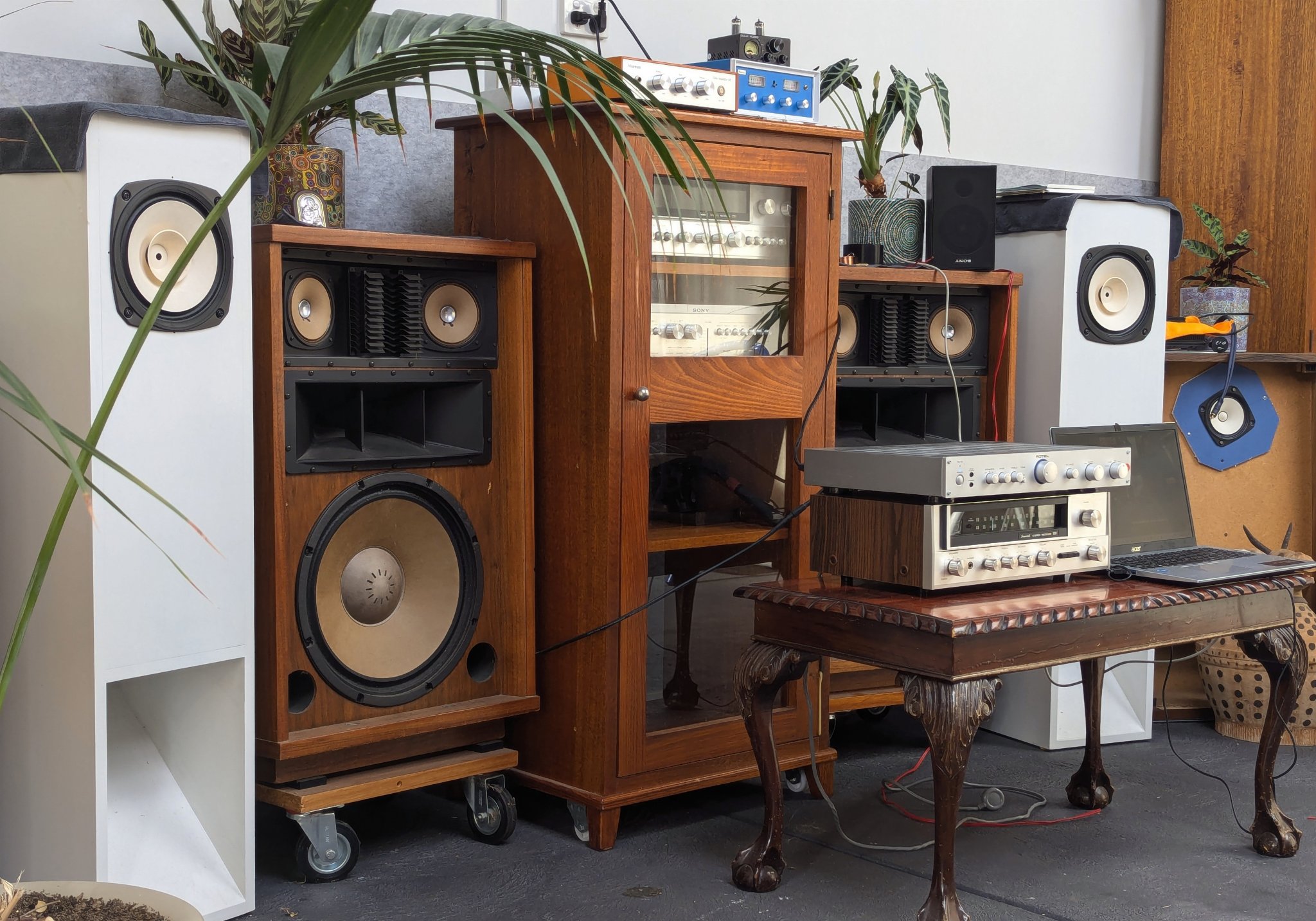

I think NV2 is pretty good replacement for older FE versions. I had few full rangers before and still have 208 sigma , FE126nv2 and SB Acoustics that i want house as well. Two low watts amps i have didn't worked well. It's just like you would connect solid state amp to Fostex206En, maybe not to same extend but that's what i thought (My friend use to have 206en in factory horn). Two vintage Sansui receivers 771 and 331 didn't do the job either. Rotel A10 was in last spot. But little handmade Push-pull Tranzistor amp with only 4watts into 8ohms work really well, maybe a little bit hot on the top but it has lots of bass and its really transparent. Mind you I'm 60 years old so my hearing it's not top notch anymore🙂. I forgot that little cheap D-amp did well as well. In my opinion law watts tube amps won't work as good as with En version driver. Not all amplification work with all speakers. Now i have question to Scott, can you design mini Chang for Fe126nv2? 🙂.
