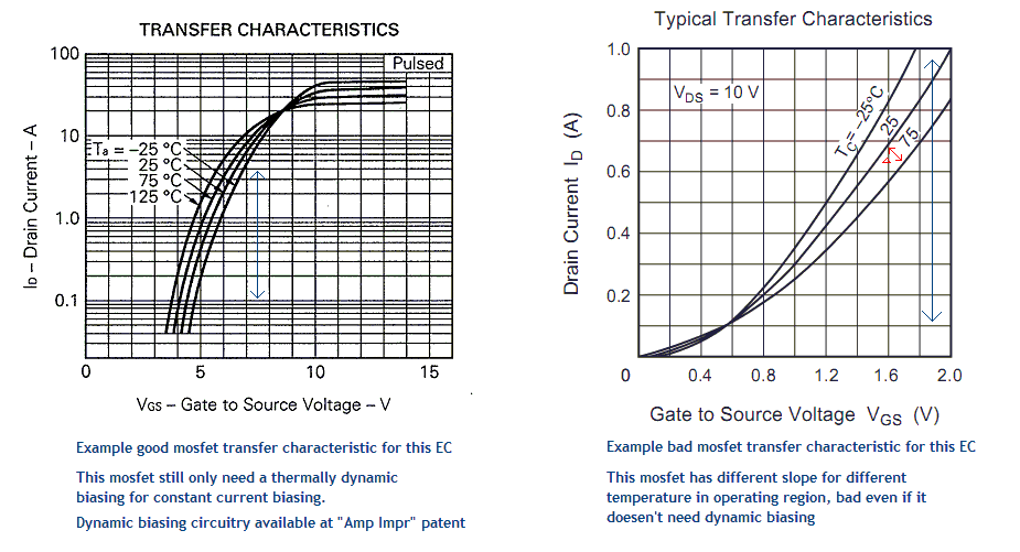

Mosfet guide: Lateral mosfet is not good here 😉

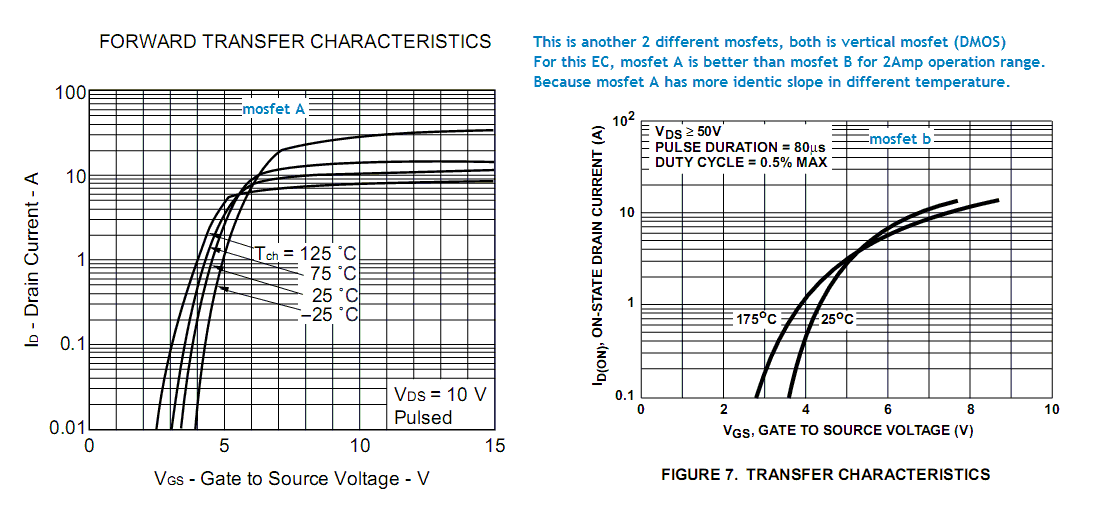

Ok this is another example, mosfet with same transfer slope vs temperature is better, because linearity will not affected bu heat, if not it will be less linear.
now with equal current mosfet.🙂

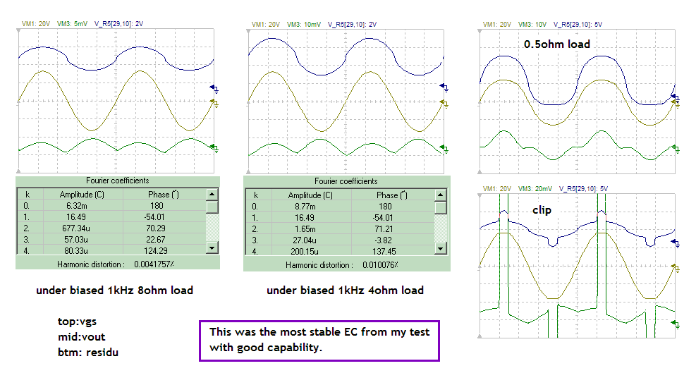

I just get lower distortion figures in my current work, and going to the next step for speed up and smoothing crossover. But I am just think about it is really worth?🙄

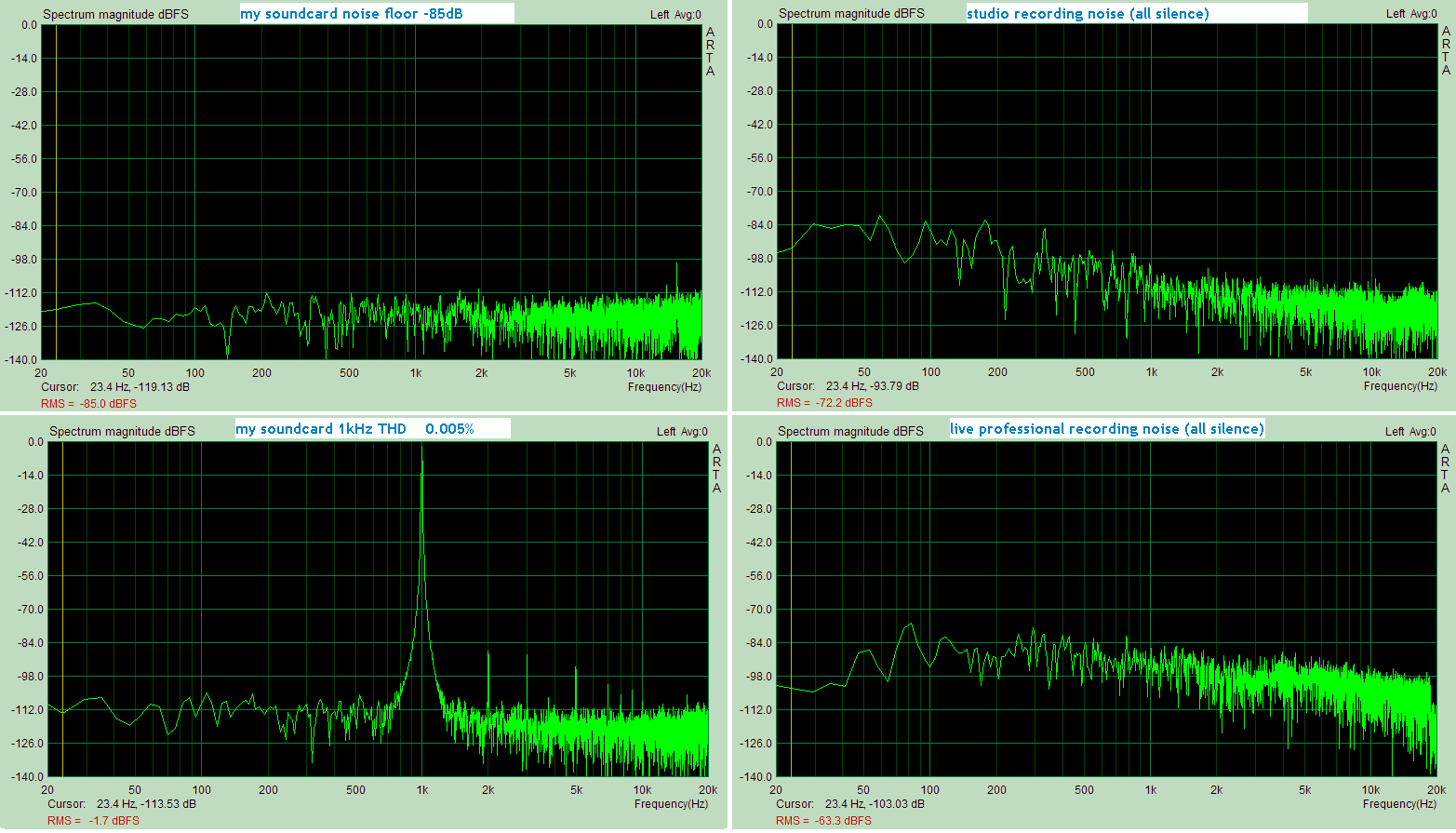

When some very good equipments just with 90dB S/N ratio or even worse to 80dB. For this reason may be 0.002% THD is more than enough.
Then at recording environments and total equipment noise might much higher than that. So, why people just try to get 0.000x% THD, IMD, and noise figure. May be it is not really worth, and again why they trying to get that 0.000x% for 20kHz, that most of us can't really hear it, and is part of heavily filtered band in recording.
Is it really worth? Thanks that was good question, and I hope someone could give some answer.

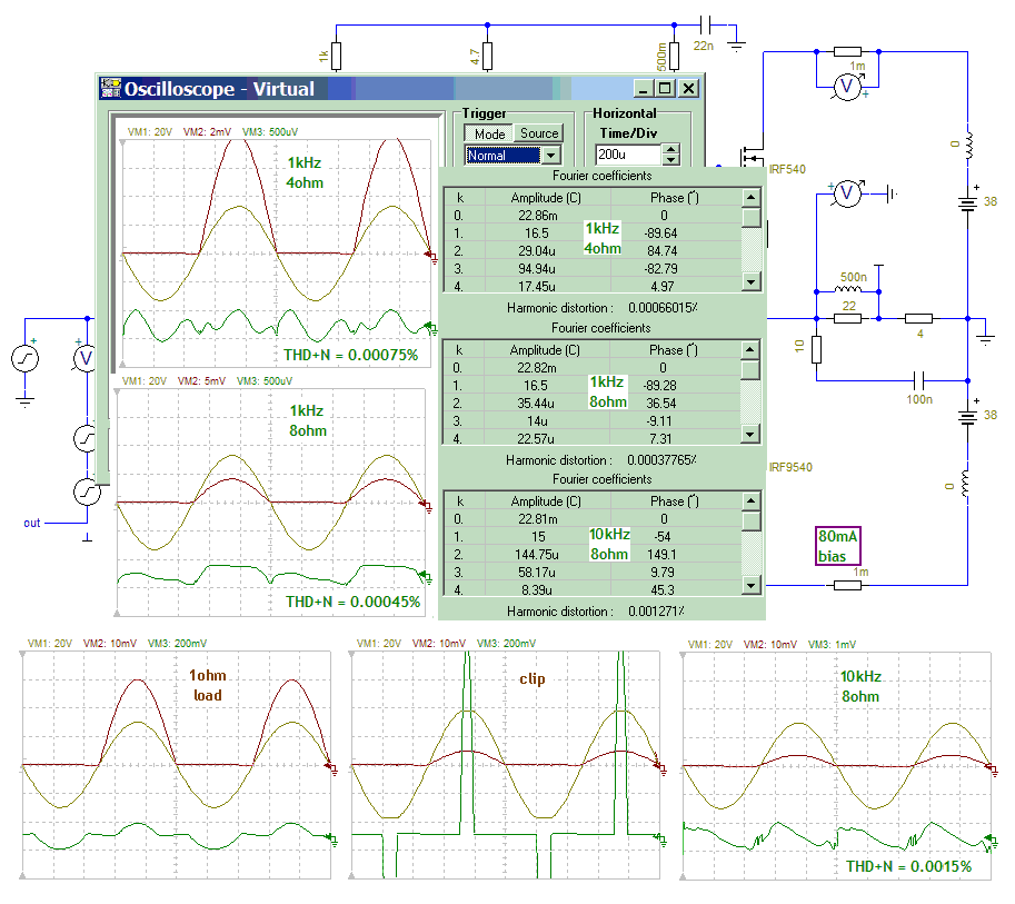

This is my current work last results. Just want to show that with EC we could get 10times lower THD easily.

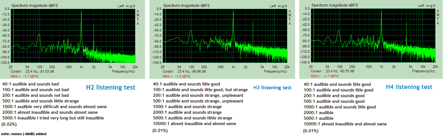

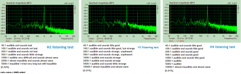

After doing few things simple with ARTA, and it is most easy. I got that most recording has noise around -60dB and -70dB. Also harmonic distortion 0.01% is difficult to compare by listening.
May be we could say that 0.01%THD is the margin, and 0.005% for IMD because it has more spread spectrum may be twice maximum.
Then half of that, an amplifier with less than 0.005% THD and 0.0025% IMD is perfect and amplifier with less than 0.0025% THD and less than 0.001% IMD is just too much, and that figures are useless when compared to 0.0025% THD and 0.001% IMD. Anyone agree or disagree?
Yes there are many things happened, THD and IMD is just two of them. An amplifier with 4% THD isn't only amplifier, but it attached with effect box at 4% FX volume. In this case it will depend on how the FX change the sounds.
Ofcourse an amplifier with less than 0.01% THD has its purity from FX, if the other things not make it worse. Looks like that the other things are more dominant.
