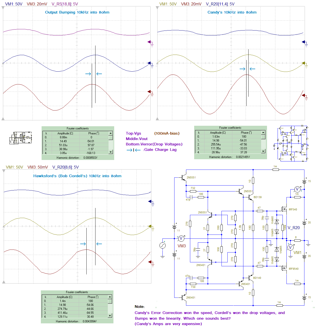

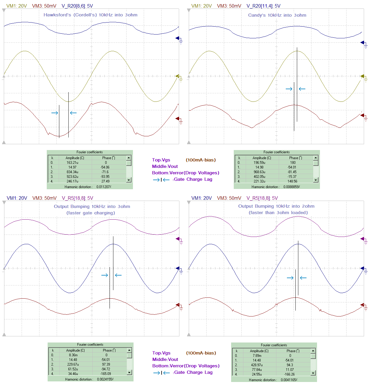

I am doing some comparison, take a look.
Also with my bumps style error correction result.

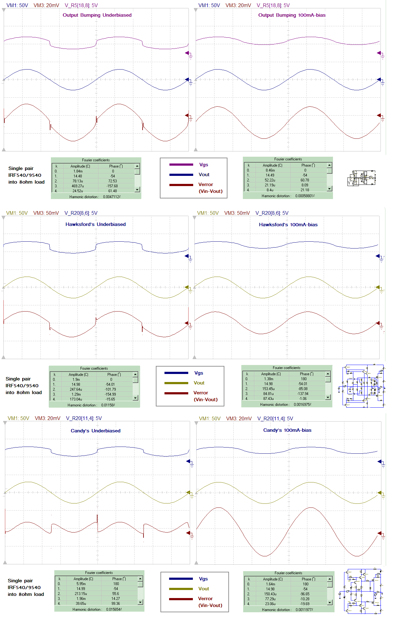

I've tried to tune candy's EC, but ended for just 0.001%THD both candy's and cordell's not as good as my bumps feedback. May be my models not very good or something, because Halcro says reaching ppm scale or less than 0.001%THD at local output stages assuming they using 20dB global NFB.
This is another results, and also showing my improved bumps feedback results.

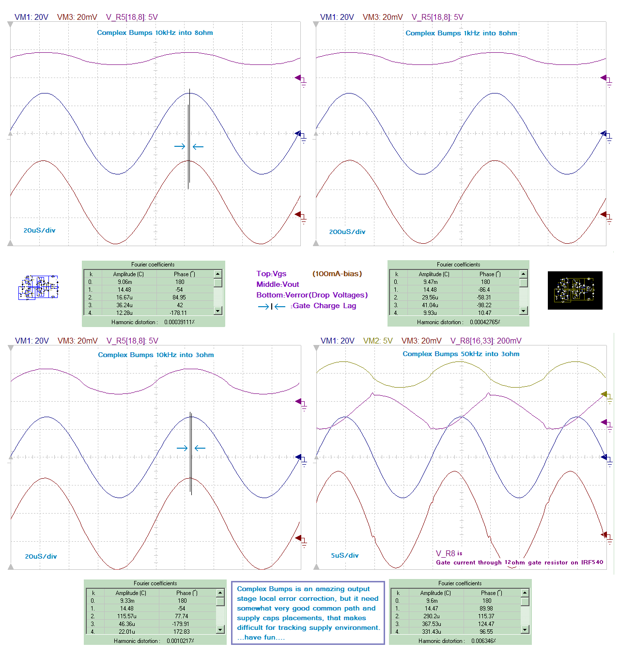

Bumps EC is originally designed for mosfets to deal with non linearity and gate charging effect, unlike the hawksford's based that designed first for BJT's in very long time ago.

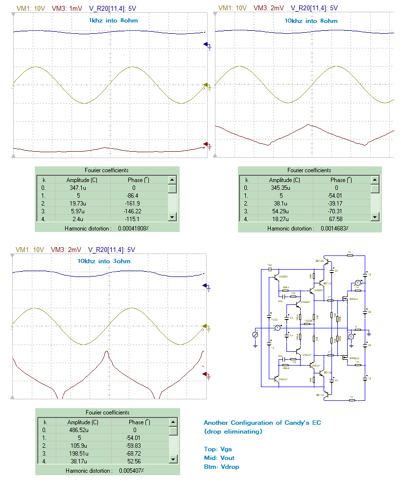

My,, I forgot to add bootstrap on candy's EC. Here bootstrap added with different configuration, this configuration may the correct one because that VR is adjusted to eliminate drop voltage instead of linearize it. Now reach 0.0004% THD.
Anyway, lack of bass isn't caused by current limiting. Also they are not any same between Candy's and Cordell's EC. They have very different each other.
