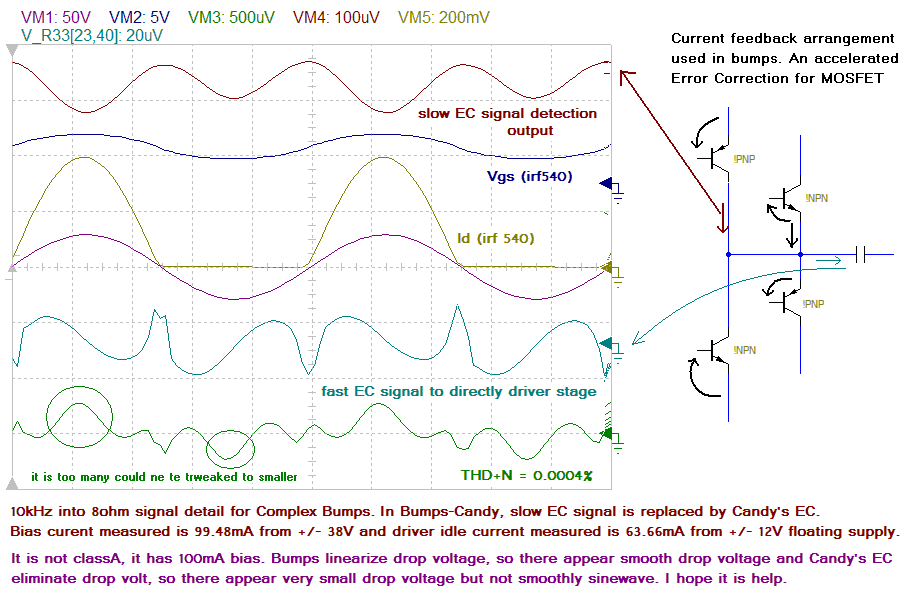

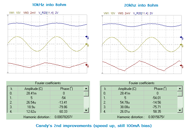

Bumps is just a current feedback arrangement, I like to call it Bumping Feedback because it has two collector and two emitter connected in single node together with capacitor leg as additional output (five branch node).
Crossover distortion normally increases by load, also it just micro volts and output filter is not present. When output filter applied it will smaller.
Umm...Don't no, Is it ok showing complete value of patented schematic😕. also it isn't real values, just coming from tweaking.
@Bonsai
It is already very small, and halcro added more feedback(GNFB) to reduce it.
@Jcx

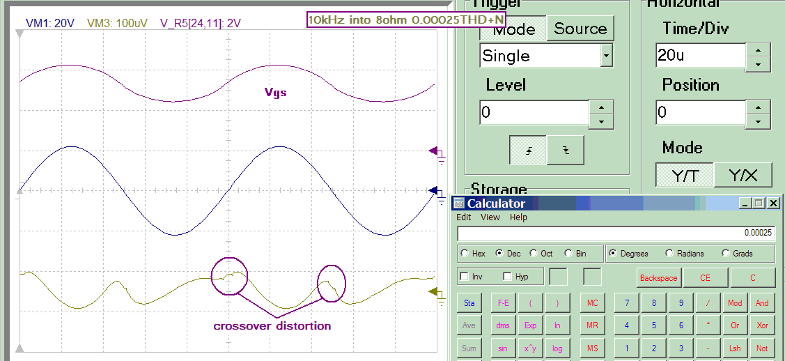

GNFB could reduce distortion and normalize HF components and output filter could reduce HF components, but good EC will much help. No doubt class A has no crossover distortion.
This one is 8ohm load at 10kHz Bumps-Candy's EC, crossover distortion is much smaller. (still no output filter). I am still tweaking it, it is fun.

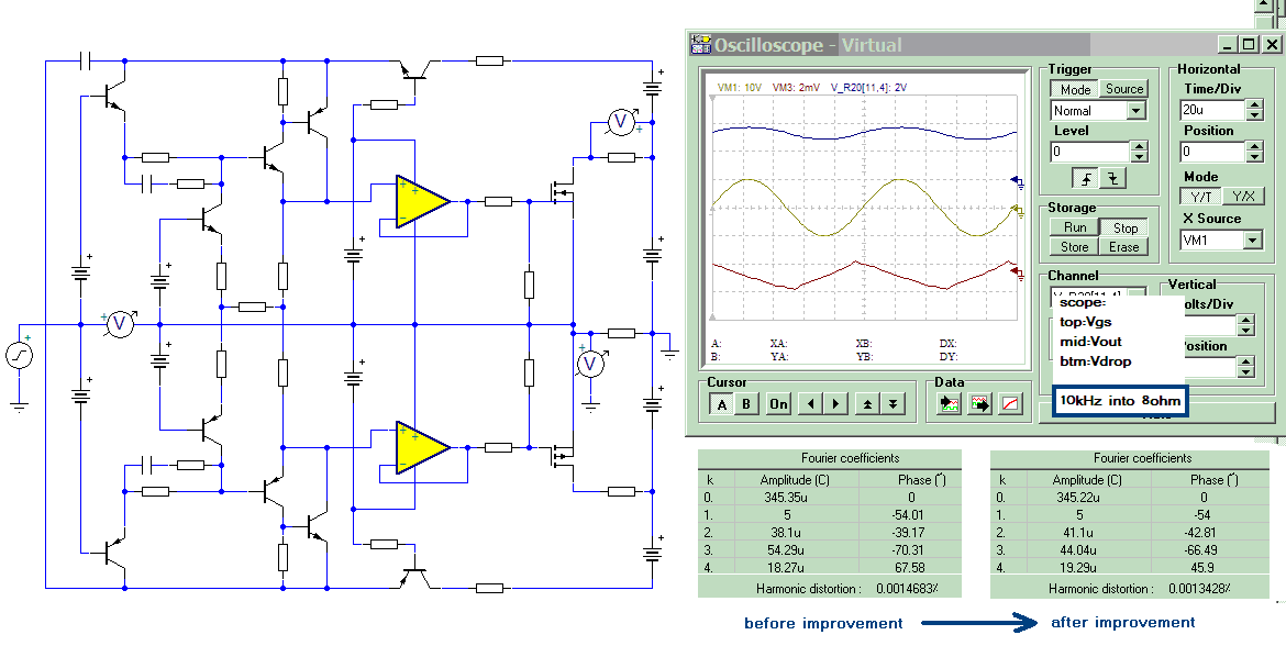

I am now reads US6798285 at wikipatent. Looks like this patent is used for this amp, most in output stage improvements, including mosfet gate buffer (driver) and dynamic biasing circuitry. Funny, using opamps for mosfet drivers😱.
This is the first Candy's EC improvements, but only tiny differences. May be something wrong.
@bear
I am just limit bias output by 100mA. Surely with 250mA they are very good, but it doesn't showing the special use of good EC.
Sorry, no values. I don't want to have problem with them, for complete values, use PM. Can't "make, use, sell". Just don't want supporting "make".

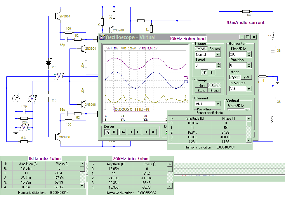

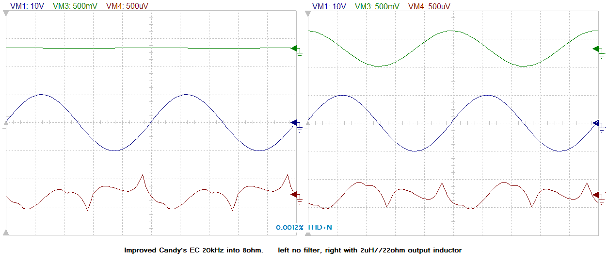

This one is differences between using output inductor and without it. Big enough, 2uH. Seems that the output inductor is help for global negative feedback application, and not for crossover distortions.
Top trace is drop voltage:

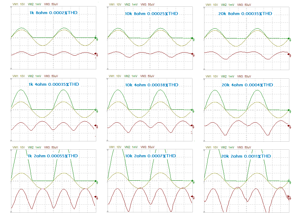

Ok, this is the last things to do to speed up this error correction, Like I said before, it is good EC, Candy's is not comparable with previous hawksford's.
Reaching 0.0002% THD+N, with: easy tweak, easy built, no need component precision and matcing, simpler and so... baadd.... He got it patented.😀

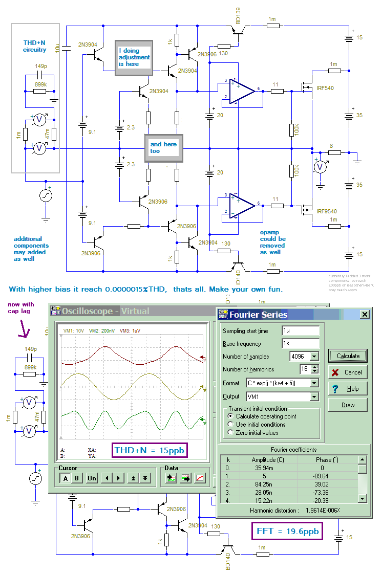

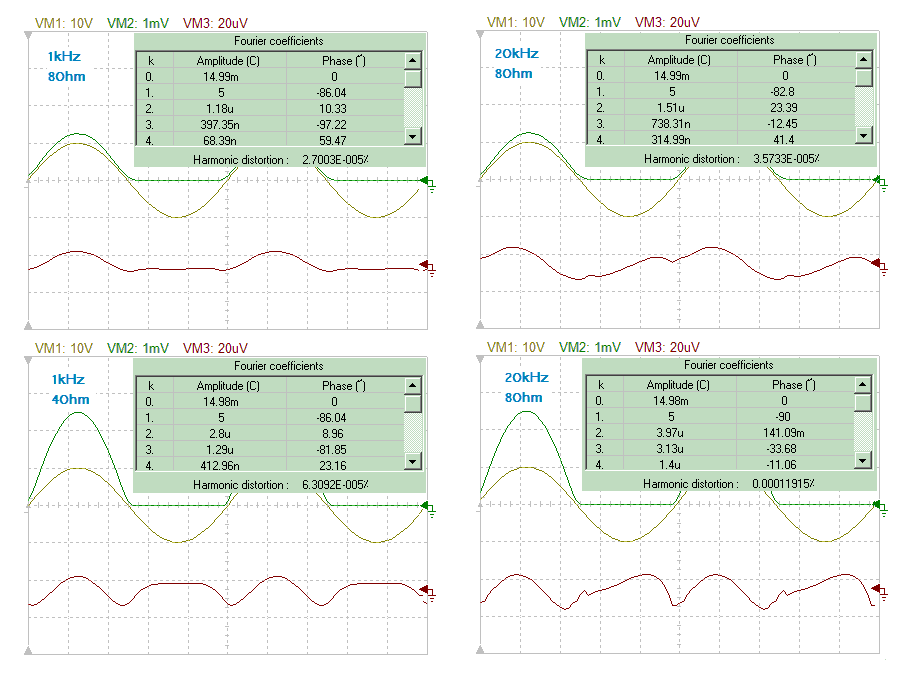

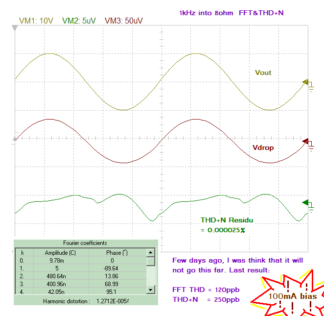

Now the 4th improvements. Now the target is linearity. Reaching lowest THD I ever simulated 0.000027% or 0.27ppm or 270ppb. That is close to their claim to be achieved distortion.
The output stage is still 1pair IRF540/9540 with 100mA bias. All other transistors is 2n3904/06 with fast opamp as mosfet driver as picture at previous post.
So halcro amp must have very small amount of global negative feedback, and GNFB may just applied to refine its sound quality, instead of THD figures.
improvenebt 4: 0.000027%THD:

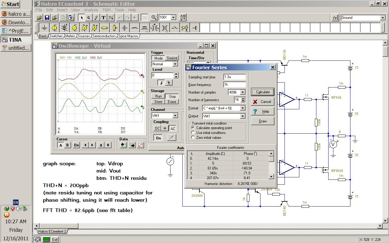

This the last things, yes schematic. This is what I currently simulate for those results.
The next is VAS stages, but it is seem useles, i have already similar things. and many other also has similar too, and simulate it in other threads.
