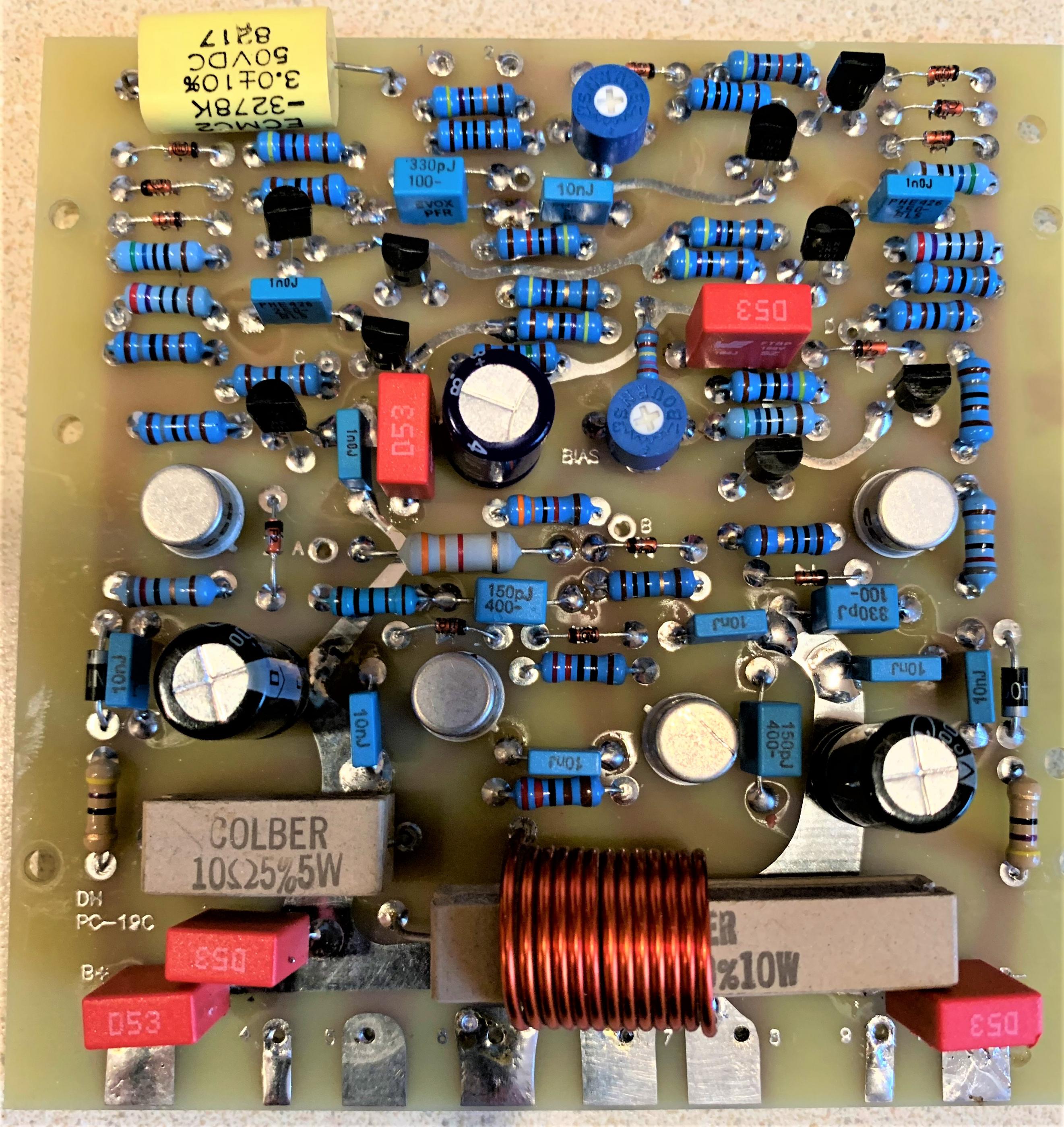

I was having problems with my amp that had the old style driver boards without offset adjustment pot. So I purchased brand new stock blank driver boards (last version made) and stuffed with new parts. I can bias the amp OK, but the DC offset is 26-27 volts in both channels! Also, don't understand why my relay clicks on with all this offset. The DC offset adjustment pot does nothing when turned. Any idea where I should start looking?

Pictures of the actual board top and bottom are very helpful.
Sounds like you either have a bad component, solder bridge or incorrectly installed transistor (wrong type or wrong way around).

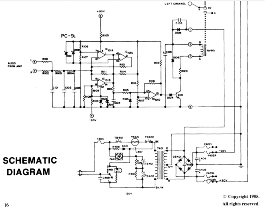

The voltages at IC101,pins 7,8 set the threshold for DC detection.
I'd have to calculate what they were designed to be or you can measure them.
D101,102,106,107 are 10V zeners and divided down using R106[109]@22k & R107[108]@3k9, so that works out to be ~1.5V.
Need to check all your voltages.

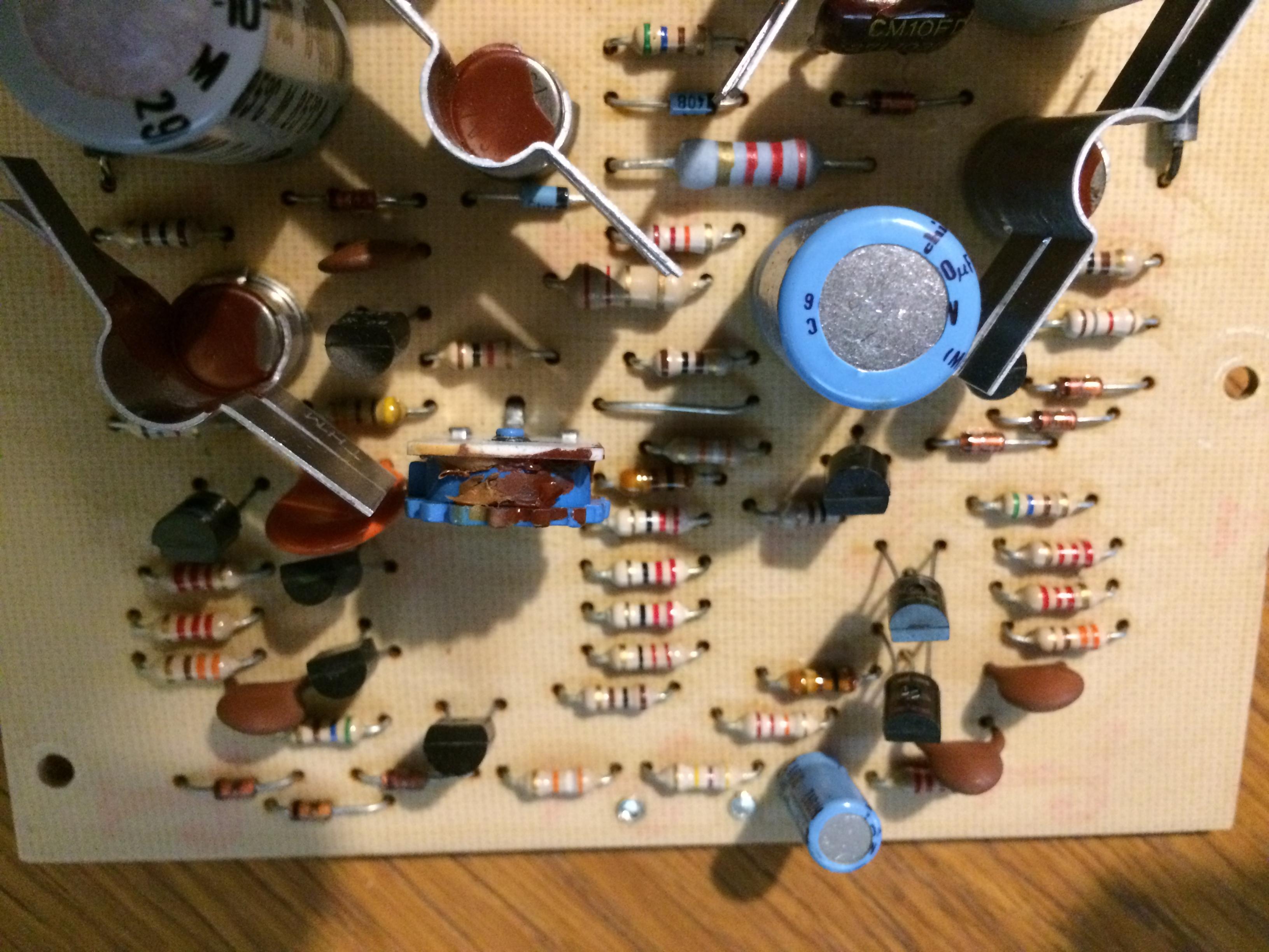

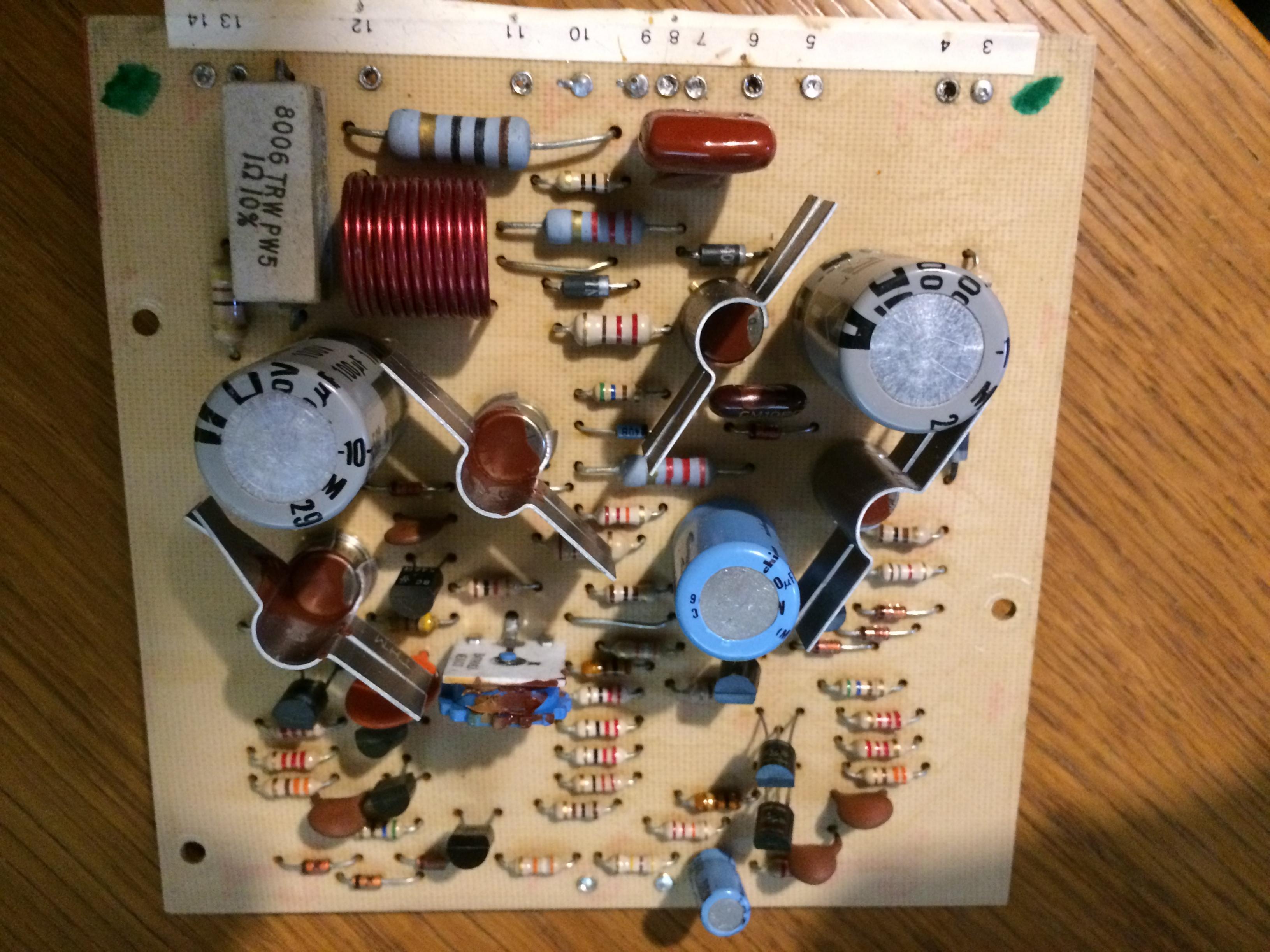

Yes main voltages are good and I can bias the outputs to 350ma. The protection board that is in the amp now is on a PC-9 board, from the original old boards. I know Hafler used a PC-9C on the driver boards I have installed now. They are slightly different. I would not think the protection circuit would be the problem? Here is a photo of the driver board and a schematic of the old protection circuit I am using and the newer one I am not using.

Look around the offset adjust circuitry. Voltage at the base of Q3,5?
See what is up with that offset detection ckt not releasing the relay?

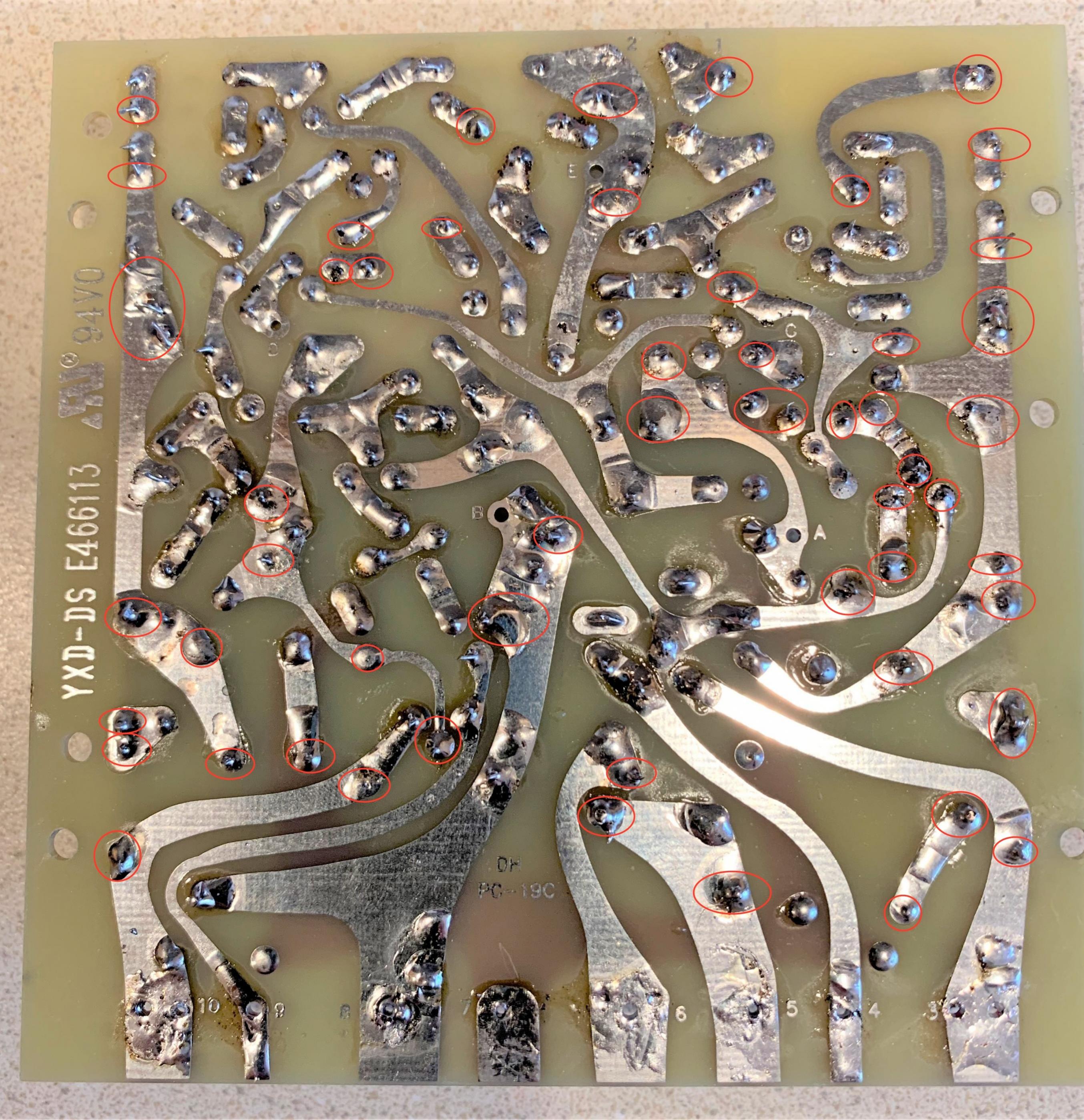

Clean off the flux on the PCB and check with a good lens for solder tails shorting between traces?
Looking at the board photos that were posted, you can tell this board's been through quite a bit of soldering and parts changes. I've marked the suspicious joints with red circles. Some may be the camera angle, others might be shadows but I think I would suggest a thorough reflow and check of the soldering.

As stated, I just purchased the boards blank and installed new parts. No parts changes. It's weird that both channels have the same problem and the fact the relay closes with all that offset. Also, bias pot does bias the outputs. I will check grounds, re-solder and clean pc.
