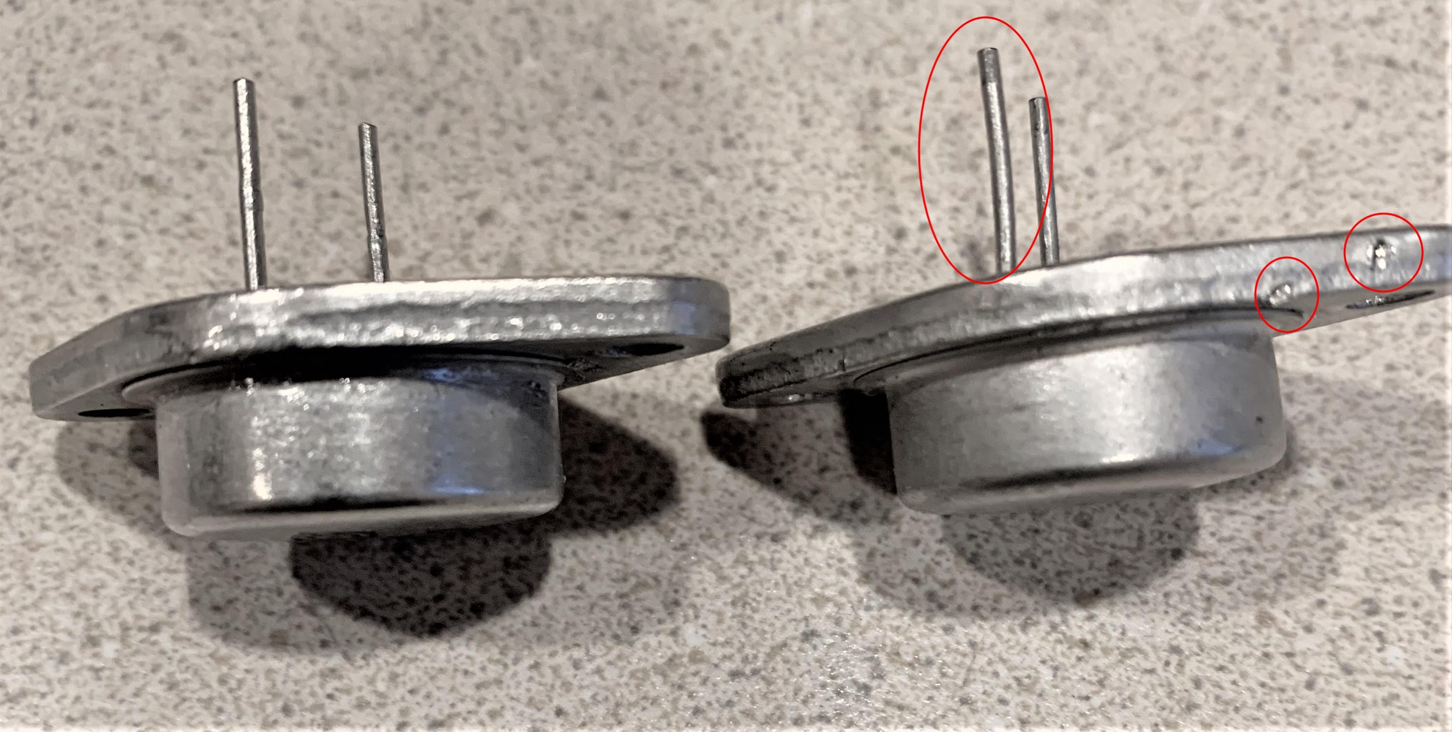

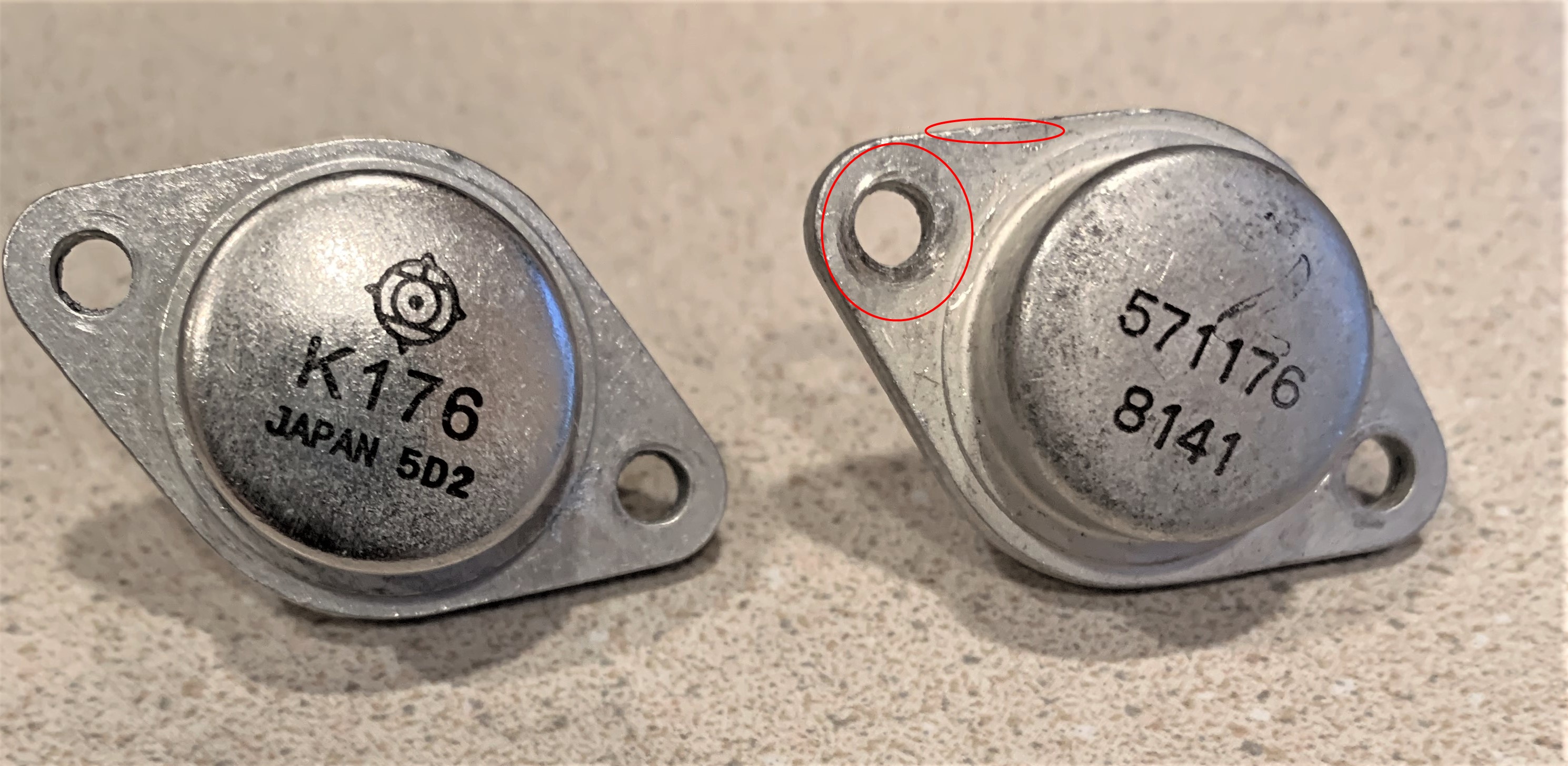

Seeing that your source for those output transistors is chinese - I can guarantee that they are fake - unless they are obvious pulls from scrap gear. Even with genuines - you would need them matched.
There was another thread where someone bought cheap Chinese laterals and when tested on a component analyser where in fact vertical mosfets !
New Mosfet on the left, old original on the right. What do you guys think? Feel about the same weight.
Actually there are several hints the ones on the right might have been recovered parts ... taken from other devices.
Yeah, more annoying red circles... 😉
The ones on the right are original. I purchased the amp new as a kit 31 years ago.
