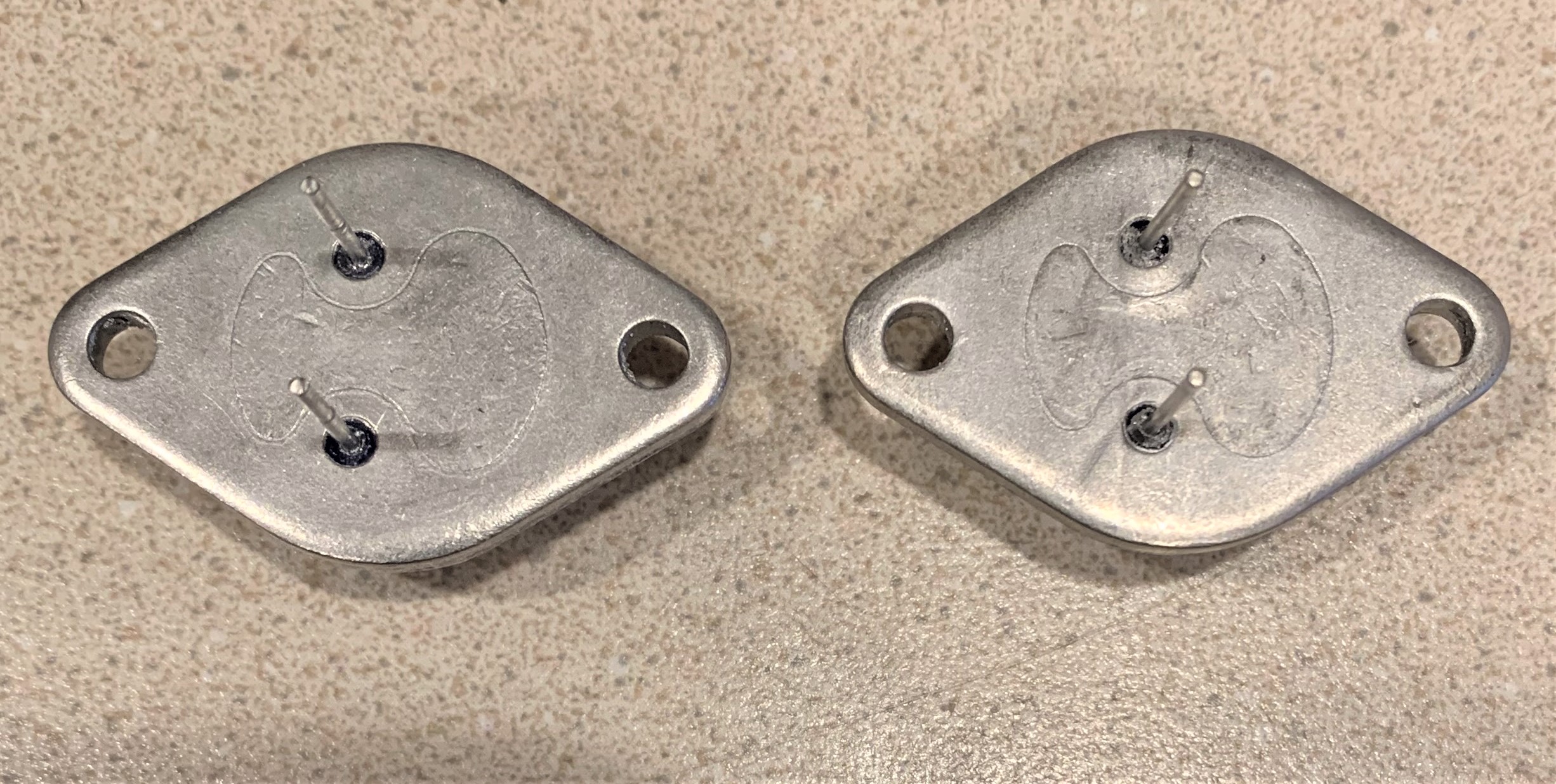

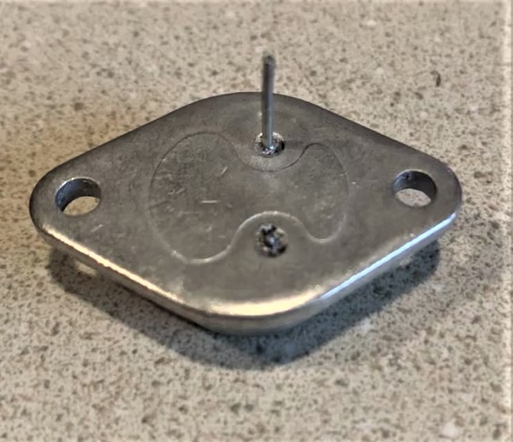

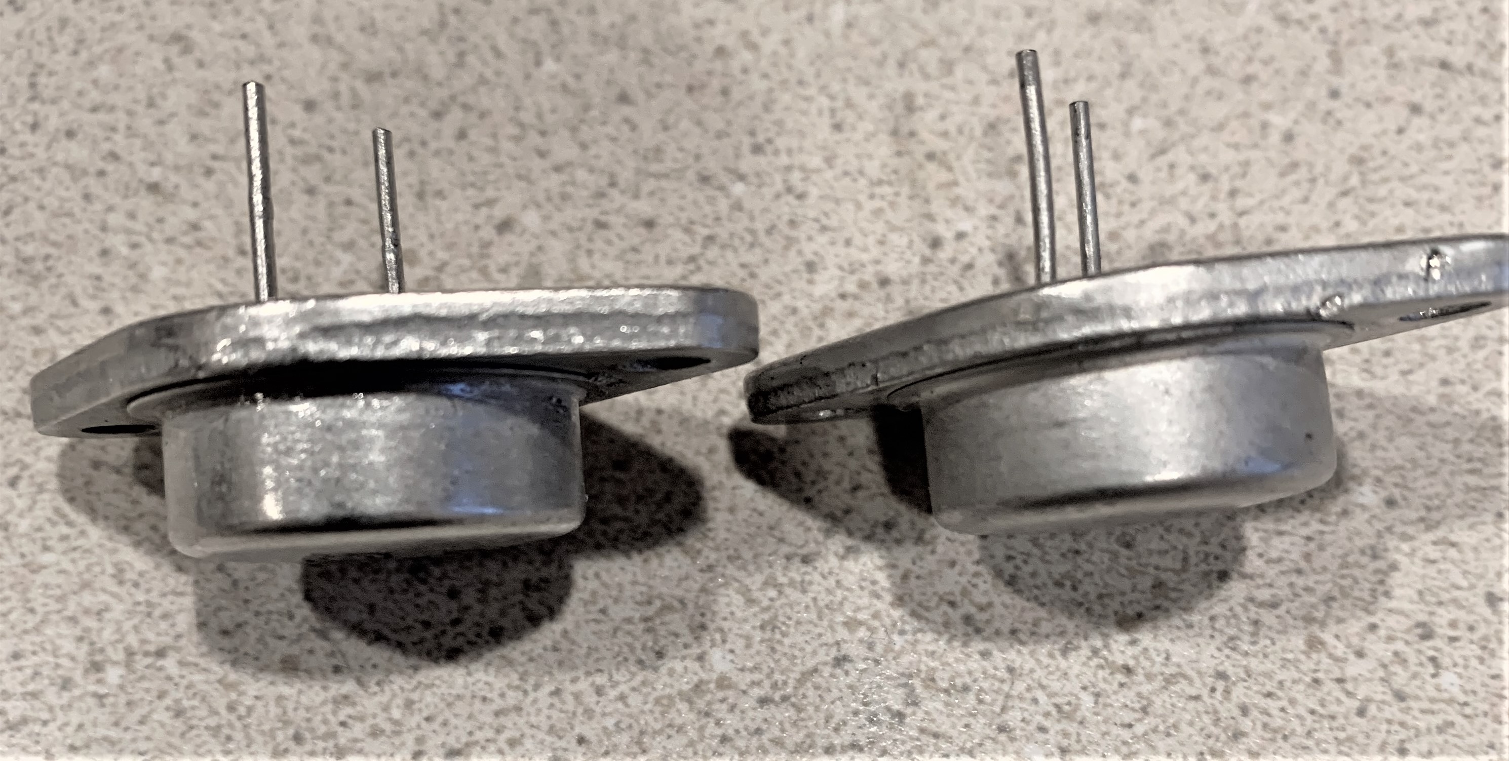

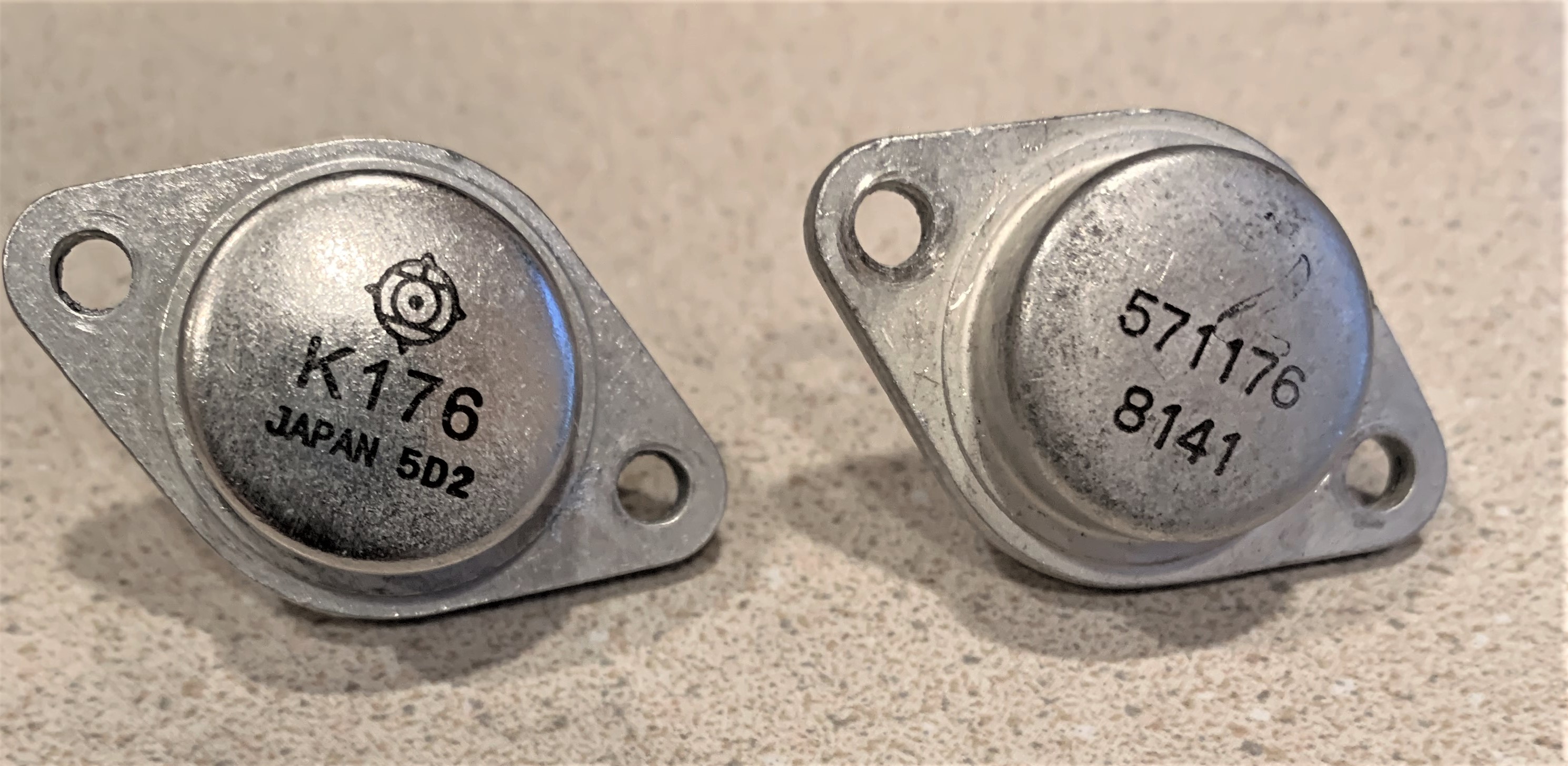

I can not tell if they are genuine or not. Certainly look new and not old or tarnished.
I see in another thread someone weighed them and found out there were differences.
Not sure if that is a good way to tell because they could have changed the package construction during there run.
The best way to tell is to measure them and compare the measured specs against published.
BTW where did you get the mosfet's from? just curious.
Seeing that your source for those output transistors is chinese - I can guarantee that they are fake - unless they are obvious pulls from scrap gear. Even with genuines - you would need them matched.
I did a ton of research when sourcing TO-3´s for a DH500 - including ordering samples from a few china sources. Curve tracing the supposed Hitachi against the originals was worth the money in laughs.
By now I´m sure there are chinese festivals in my name - paid for by all the counterfeit crap I´ve bought from them.
Get a refund from that company - and go with the Exicons.

The pin broke off, imo near impossible for the driver to do this, you have to treat it like an wild animal in order for it to do that. More tell tale signs of a questionable part.
Like said before, contact the vendor, show them, demand a refund, issue a case with eBay and even Paypal if you have too to get your full credit returned.

Well the pin did not break off when I removed the mosfet, apparently the device blew up. The heatsink was black. I did hear something when I initially powered the amp up. I did not see any smoke and I could not see anything burnt on the driver board.
