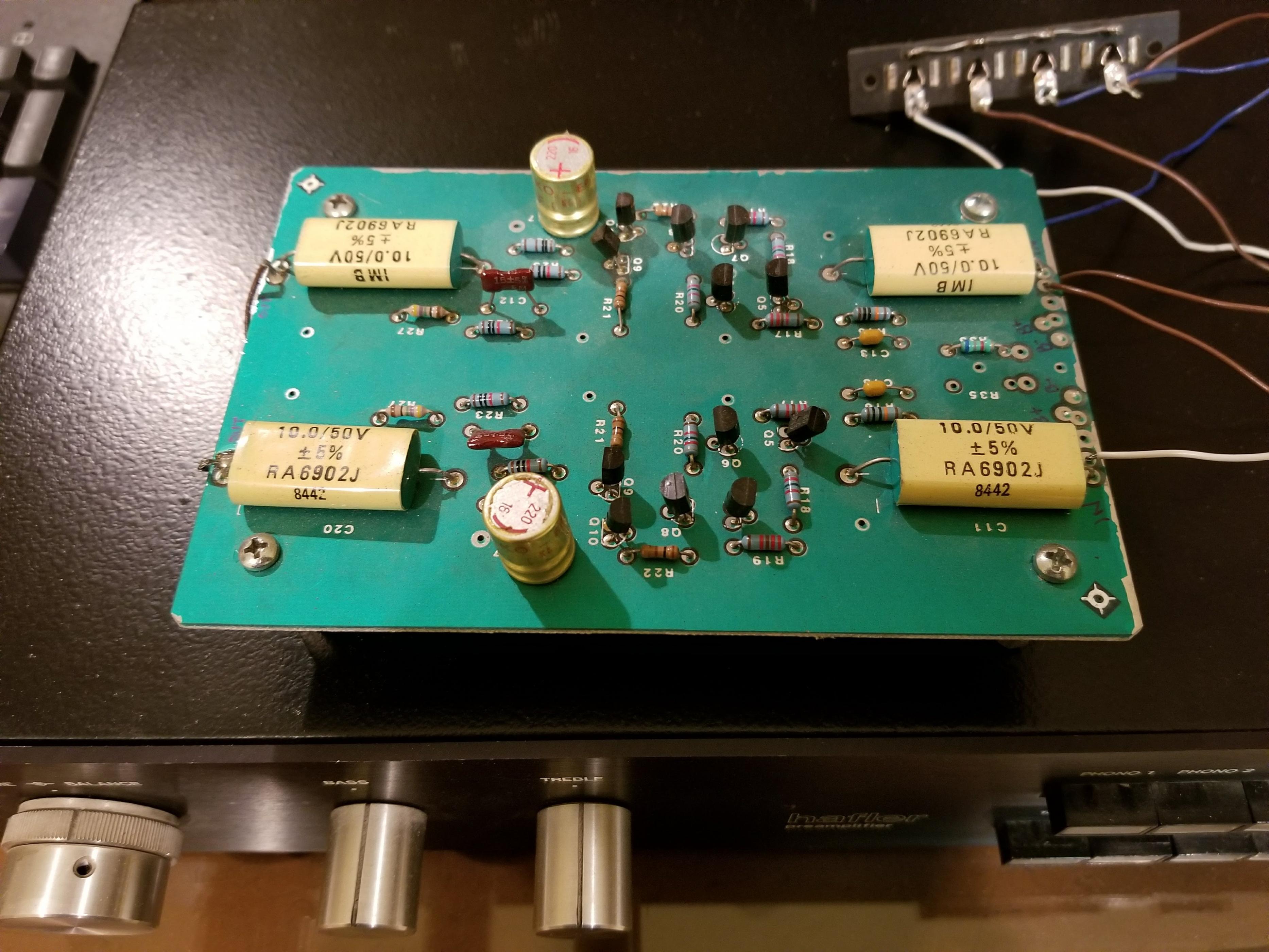

While I'm not an expert I really like this little pre. I liked it so much that I took the AA mods, removed the tone controls, updated the RIAA and had boards made. I built a few pre amps. One is at a buddy's house.
For me the case is always the hardest part of any build. Here is a board. Not sure if I ever used it. I also did a PS board and phono board. The phono sounded great.
