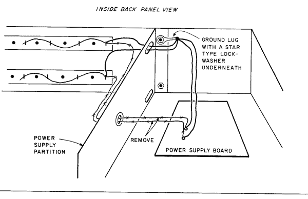

DH-101 Grounding mod from Audio Amateur years ago
Attached is the grounding mod for the DH-101 published in Audio Amateur many years ago. Somebody asked about it earlier and I don't think I ever saw it. My apologies if this has been put up elsewhere.
Thanks, it is very useful.

Where to make star ground for DH 101
I see on some modifications a star ground to the chassis whild on others a star ground to a point on the PCB. Is one a better choice?
