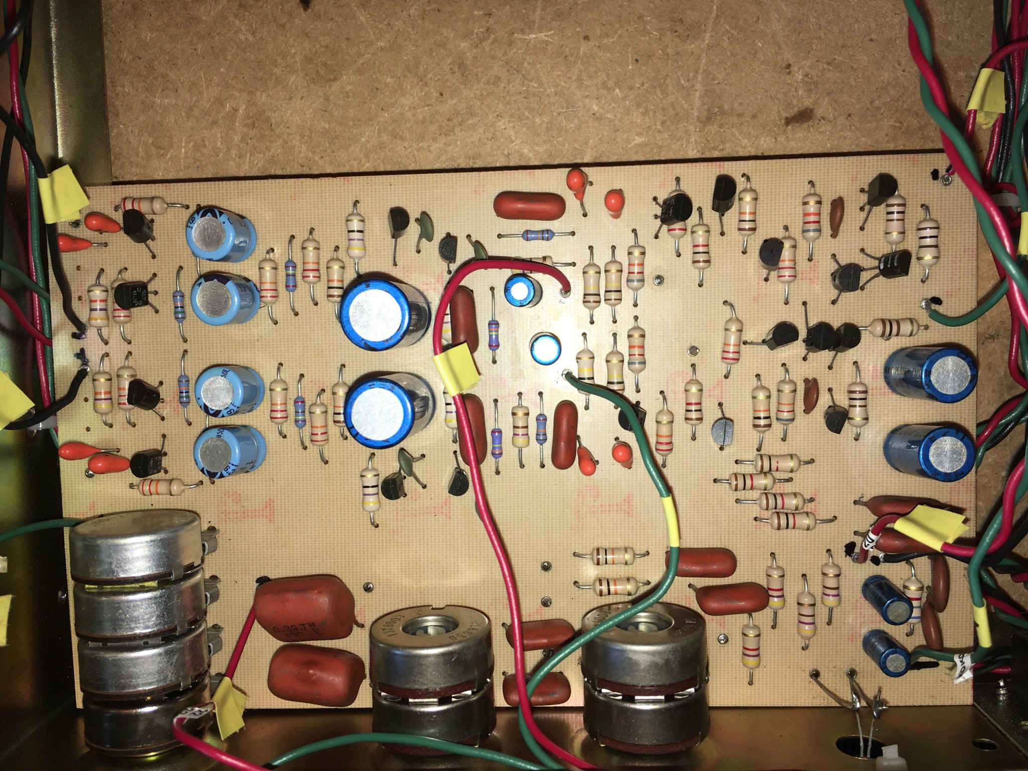

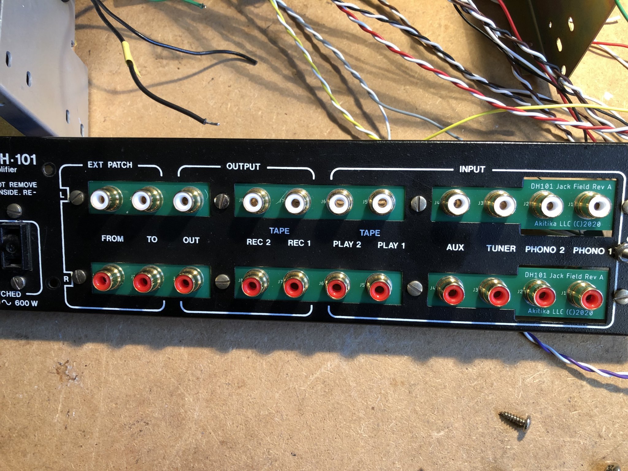

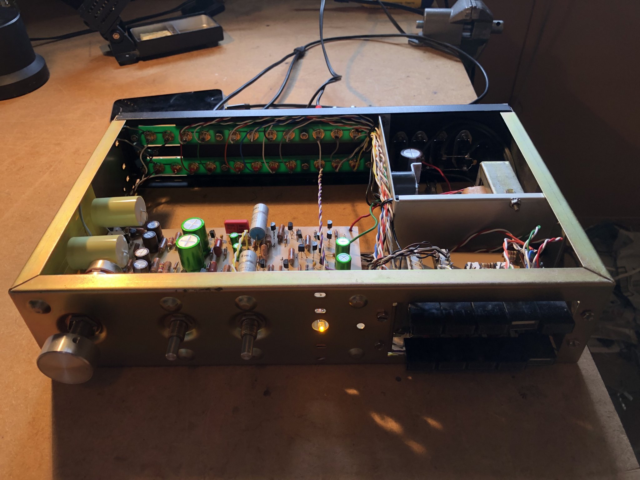

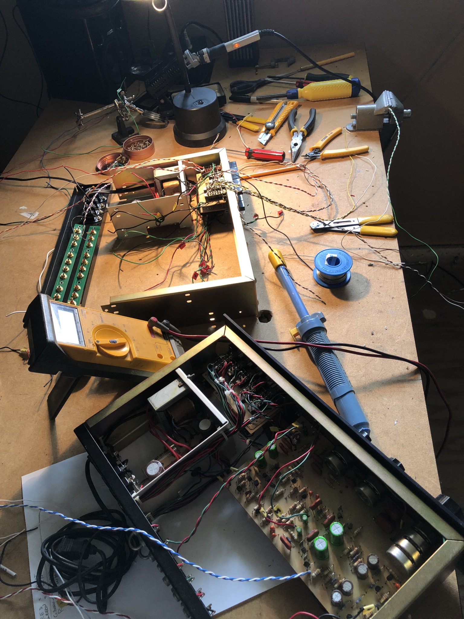

I am sure the answer is buried in this thread somewhere, but how can I bypass a wonky balance control on a stock DH 101?

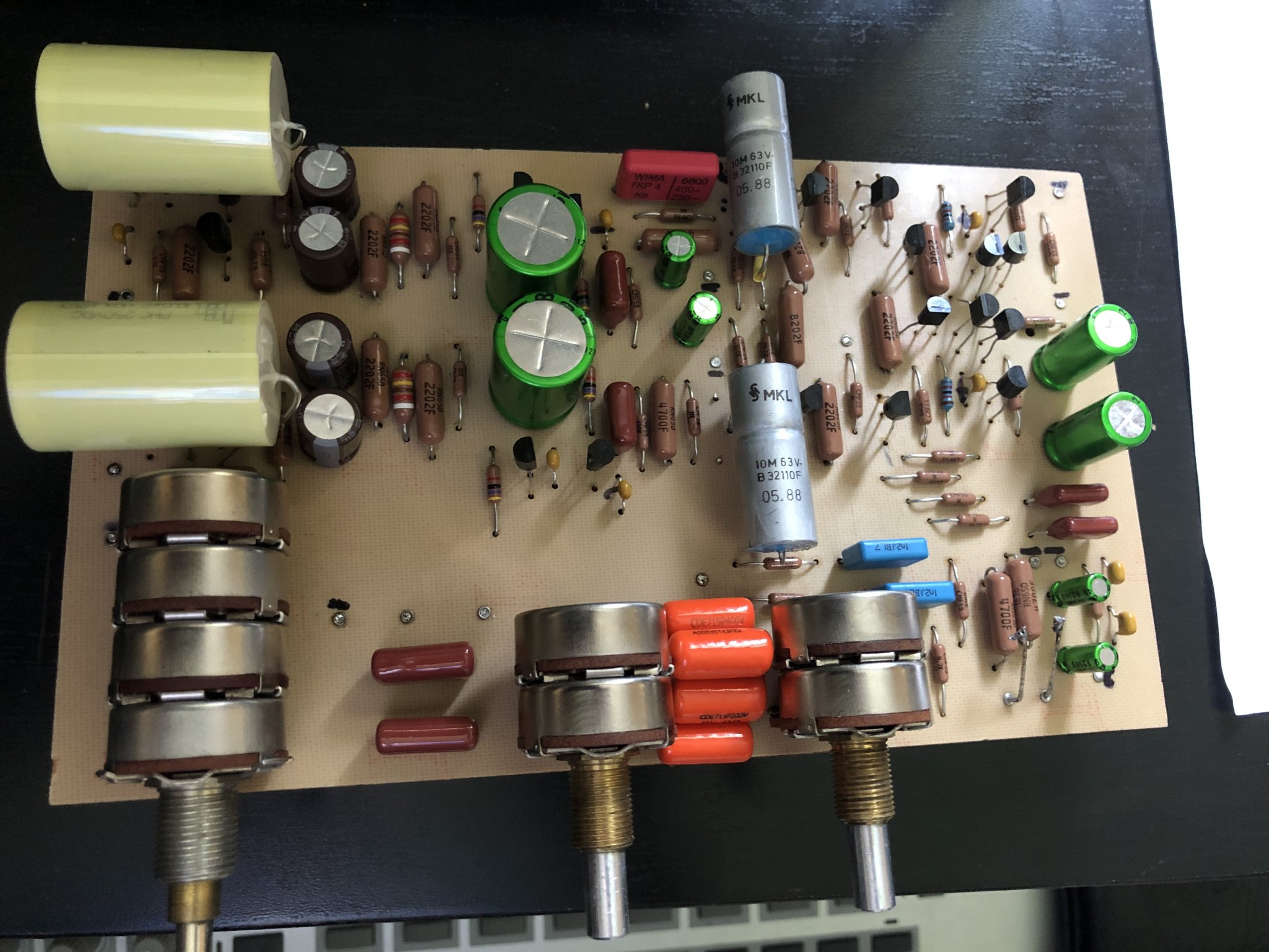

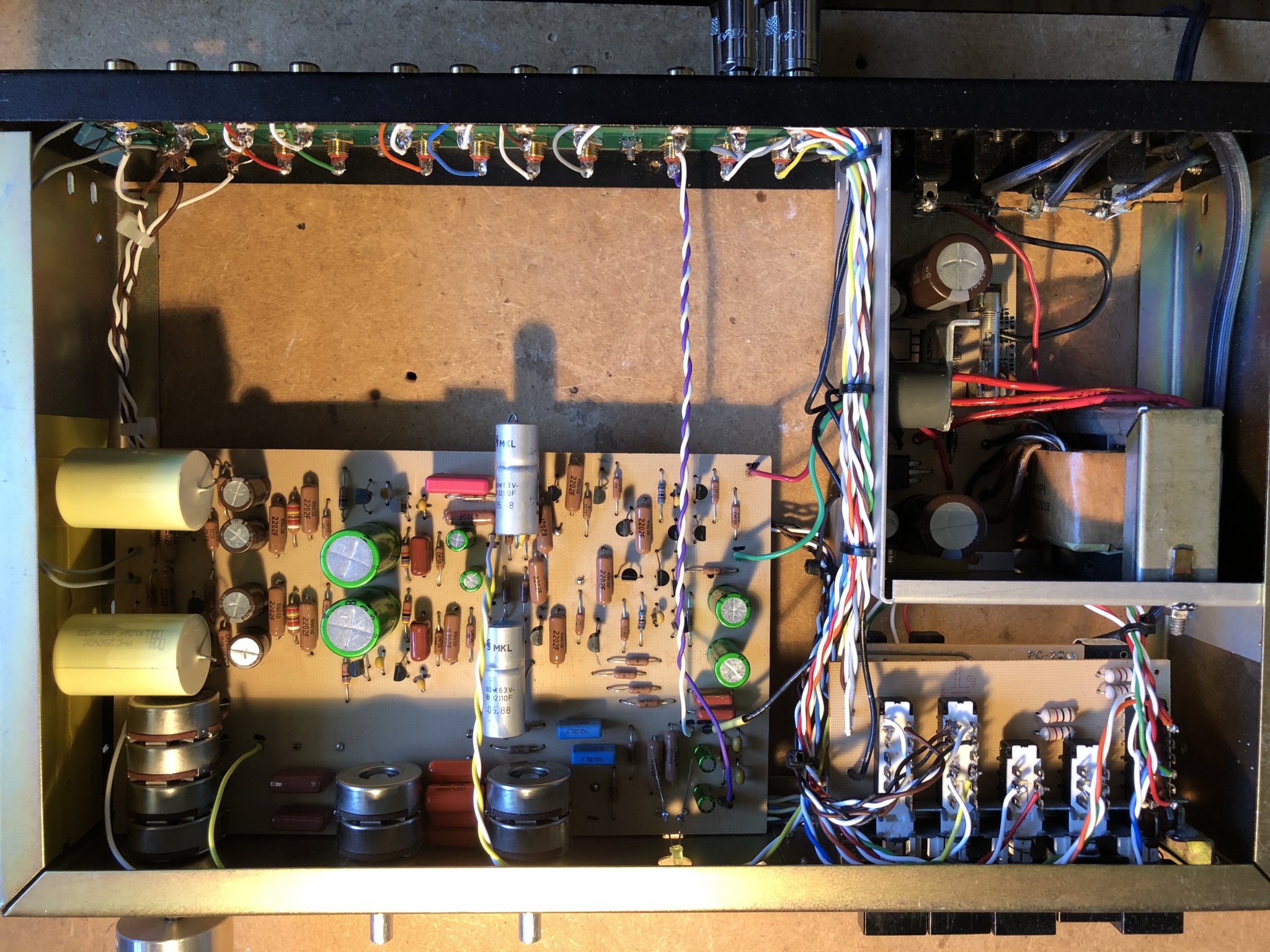

Just finished my second DH101. The previous one only had the psp rebuilt and a recp of the electrolytics.
On this one I stripped the main board, installed metal film resistor, all new capacitors (mostly polypropylene), rebuilt the psp, upgraded all of the transistors to the equivalent of a "106", replaced all signal wiring with "Radial" studio wire. I also replaced the rca connector patch panels with ones from Musical Concepts.
Got rid of the tantalums and replaced C2 tants with polypropylene, replaced C11 tants with MKL Klanghelms.
I'm also going to replace C20, C13, and C14 with polypropylenes I found some Wima's that will fit C13, C14, and I can squeeze some other poly's in above them for C20.
The preamp sounds noticeably better than the first one which I also thought sounded really good. This is just that much better.
Until I turned it on and ran a signal through it for the first time following the rebuild, I had no idea if it would even work. Having a second unit that was working properly to refer to along the way was a huge help.
