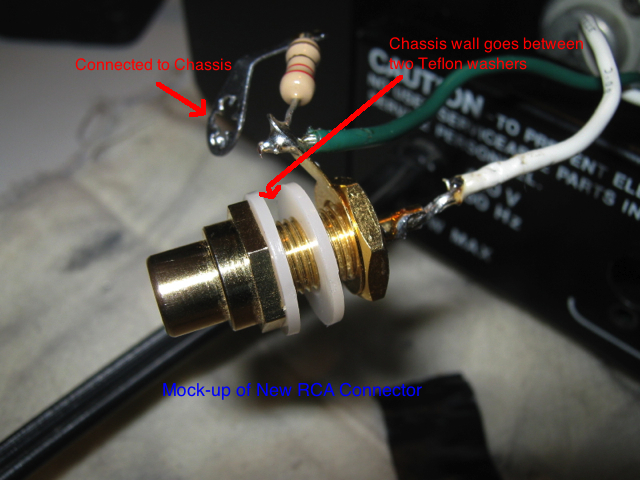

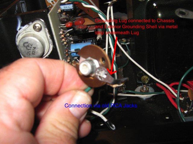

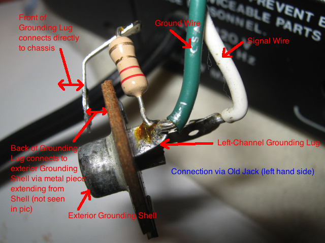

I want to upgrade the RCA input connectors on my DH-200. While taking apart the old tin-connectors I noticed that the left-channel grounding lug of the connector is connected to the chassis via a resistor. I also noticed that the exterior grounding shell itself is directly connected to the chassis. See pics below:
attachment.php
attachment.php
attachment.php
When I install the new RCA jack should I solder the resistor between the new grounding ring on the connector and the chassis? I'm not sure this will be the same circuit connection as the old one because the old exterior grounding shell was directly connected to the chassis. The new RCA connectors are designed to keep the exterior shell isolated from the chassis via spacers.
attachment.php
Not sure what I should do. Can I just forego the resistor altogether and just wire it up the normal way (green wire to ground lug/white wire to center pin)? Or should I wire it like the pic above?

someone please correct me if I'm wrong but the resistor to ground to separate input to chassis ground to keep hum out of input...I have used it on all the haflers I've had and will continue...

The input jacks were moved and grounding on the 220 changed to eliminate this insulator and resistor.
I suggest using a reversed polarity parallel diode pair (1N4000x OK) to prevent this resistor from failing, as it frequently does. A 0.1µF film cap should also be in parallel with the resistor-diode pair.
