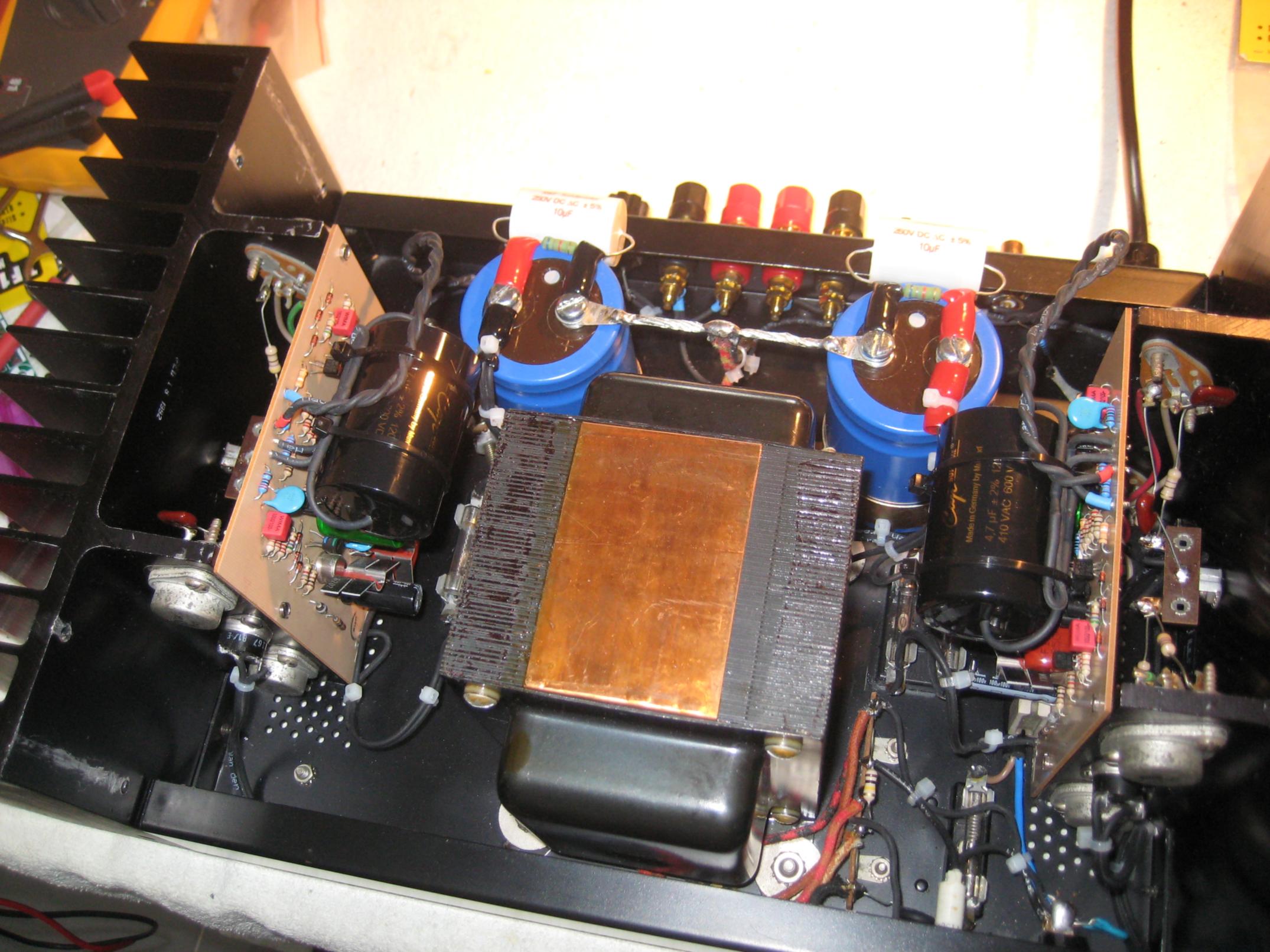

i have made a few adjustments to my DH200 as well. I cut the fuse blocks in half with a Dremel tool & then mounted them to the Driver cards. Also using Quick Disconnects while i try different parts to save the boards solder pads.

I decided to put Mundorf Supreme 4.7 uF capacitor (very large) but I come into possession of several capacitors of different capacities. Otherwise, being a combination of

Now my first impressions, what I was pleasantly surprised midrange playing unreal good, the middle is so compelling that it's amazing, simply captivating with how easy this capacitor plays midrange.
How Middle extent this capacitor is very nicely behaved in the upper and lower part of the range, high is transparent and swaying a bass was extremely accurate, wide scene and depth adorn this capacitor.
Definitely Mundorf SUPREME one of the best capacitors that I had the opportunity to try and hear. After a few minutes of listening I find myself tapping my foot to the floor, I decided that there is simply no need to add more of a capacitor in order to achieve a better and more complete sound picture, sound was fluent and easy to listen to. My recommendation of the capacitor would be between 3.3 uF and 4.7 uF, HAFLER DH-200 has worked very well in the whole range however as you will see in the picture there is a very big problem to mount this giant capacitor to the proper place so that I think simply the best solution to make a PCB and then set somewhere as close as possible.
While i cannot afford the Mundorf Supreme's, i also ended up with 4.7 uf. So far they sound the best to me.
Of course Rick G, the ideal value would be around 3.9 uF.

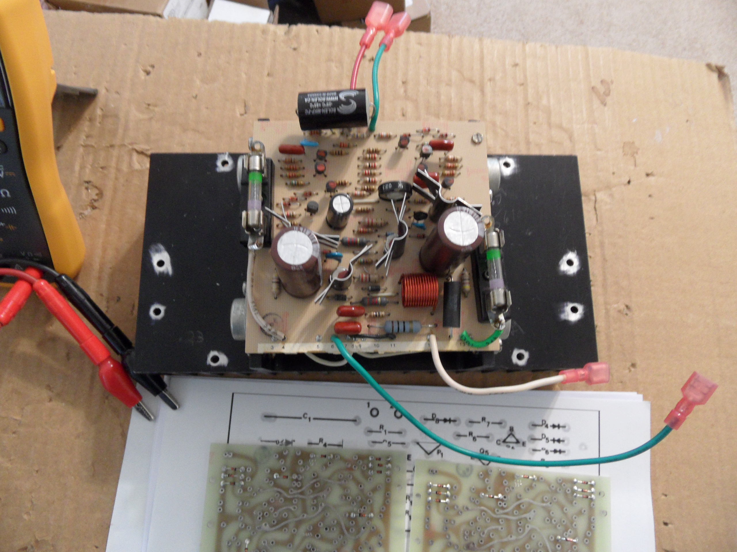

I installed spade terminals on the board. This allows the board to be removed and powered on a lab supply with current limit adjusted to any value.

WSJ...I noticed 3 aside in your output trannies and moved your heat sensors howsabout a schematic for that set up just the output section????
please, pretty please.....
regards, Elwood
It's a Hafler P 230. The only mod I made was adding the 1212 terminals and replacing a few low grade caps the previous repair shop installed in an attempt to repair the amp.
I bought it on eBay for $47, someone had spend a long time trying to fix the problem with all the solder flux on most of the board. Then gave up selling it for parts. It was interesting troubleshooting the problem. One side had a low bandwidth problem, when I removed the board for the bench test it was normal. Do you have any idea what caused the low bandwidth problem?
