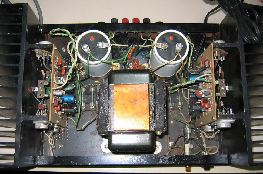

I am sure that some of the pros out there have seen worse, but I ended up with a DH200 that was just downright nasty.
It was such a mess that I didn't even want to plug it in to test it
An obvious kit build that was poorly done, wiring all over the place and it had rust everywhere, even plated components and fasteners were rusted.
It was even nastier than the picture shows, as someone had spray painted over much of the rust, including a bunch of overspray on various components and the heatsinks themselves.

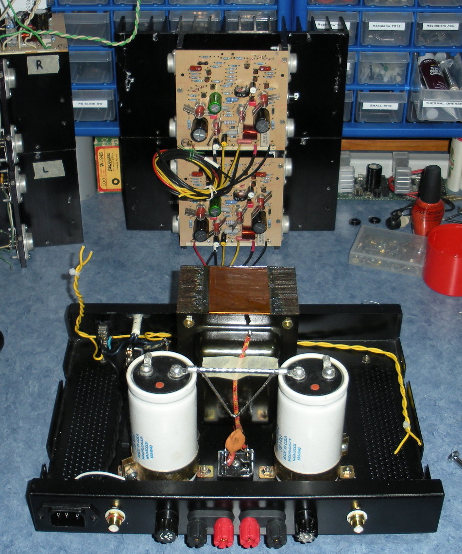

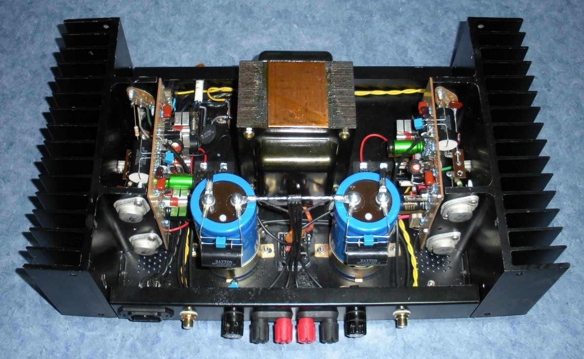

I tore it right apart and replaced the nasty stuff with spare parts I had from other builds.
I took the bare chassis and cover over to a buddy that had a sand blasting booth, I stripped it down to bare clean metal and then primed and painted.
The heat sinks were stripped down, thoroughly washed and then cleaned with solvent, sockets reinstalled and output wiring cleaned up and soldered properly.
Installed new heat sink compound and output insulators, upgraded electrolytics & bypass film caps, metal film resistors, larger bridge rectifier, ground wiring & buss improvements, better speaker posts and rca input jacks, inrush limiter, new heavier duty switch etc.
I also have new larger power supply electrolytics, but will install them at the very end to avoid possible dripping of flux and solder on the new caps.
Although it was in pretty rough shape to start with, these old Halfers are just too nice to throw away.

Finally got the DH200 all together and tested.
It sounds good, and is even quieter than other Halfers I have had.
Not sure if that is because of the cap/transformer ground arrangement, and hate to pull it apart to find out if that is the case.
I should be able to confirm that on the next one I rebuild.

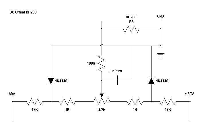

The DC Offset is 9mV on one channel, 30mV on the other, which is well within specs.
I would like to do a little better though, and add a DC Offset circuit to be able to set them both close to 0mV.
In previous posts it mentions a circuit that was in an Audio Amateur Magazine 1/83, which I have not been able to locate.
I made up a sketch of how it was described, but would like to confirm that it is correct.
It also mentions a small pp cap to help reduce noise, I would like to confirm its location as well.

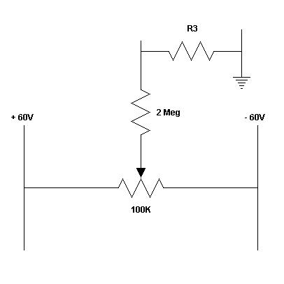

Make your offset bias voltage divider, add 2 equal R's to either side of the pot, calculate for a V range of say +/- 50mV, when the pot is at either end.
and use a multi-turn pot too.

Thanks rsavas, providing for built in limiting at either end of the pot range makes perfect sense.
Those resistors are also included in the DH220 board design, as R5 & R6.
Does the C3 cap between the pot wiper and ground apply as well, for noise reduction?

Yup, just like they did on DH-220, now that I look at it. yes the cap (C3) filters noise and makes for a smooth adjustment.
Now that I think about it some more there is no regulated supply for the front end so by rights, the dc offset ckt really should be from a regulated supply and not an unregulated supply. So make a simple +/- regulated supply for the offset adjust ckt, by using some equal value zeners and heavilly filter the zener noise using some big ecaps, 100-220uF. Should be easy enough to do, just need to calculate the R & zener power dissipations.
Haflers DH-220 method is okay to follow since they used D7,D8 as crude voltage regulators. Obviously, the best method is to have a constant current supply to the zener's, so that supply V changes do not change the zener voltage, since they are driven from a CC source or use a precision zener such as a TL431 and you can do away with the CC sources. Supposedly the Onsemi TL431 are the lowest nose of the available suppliers of this part.

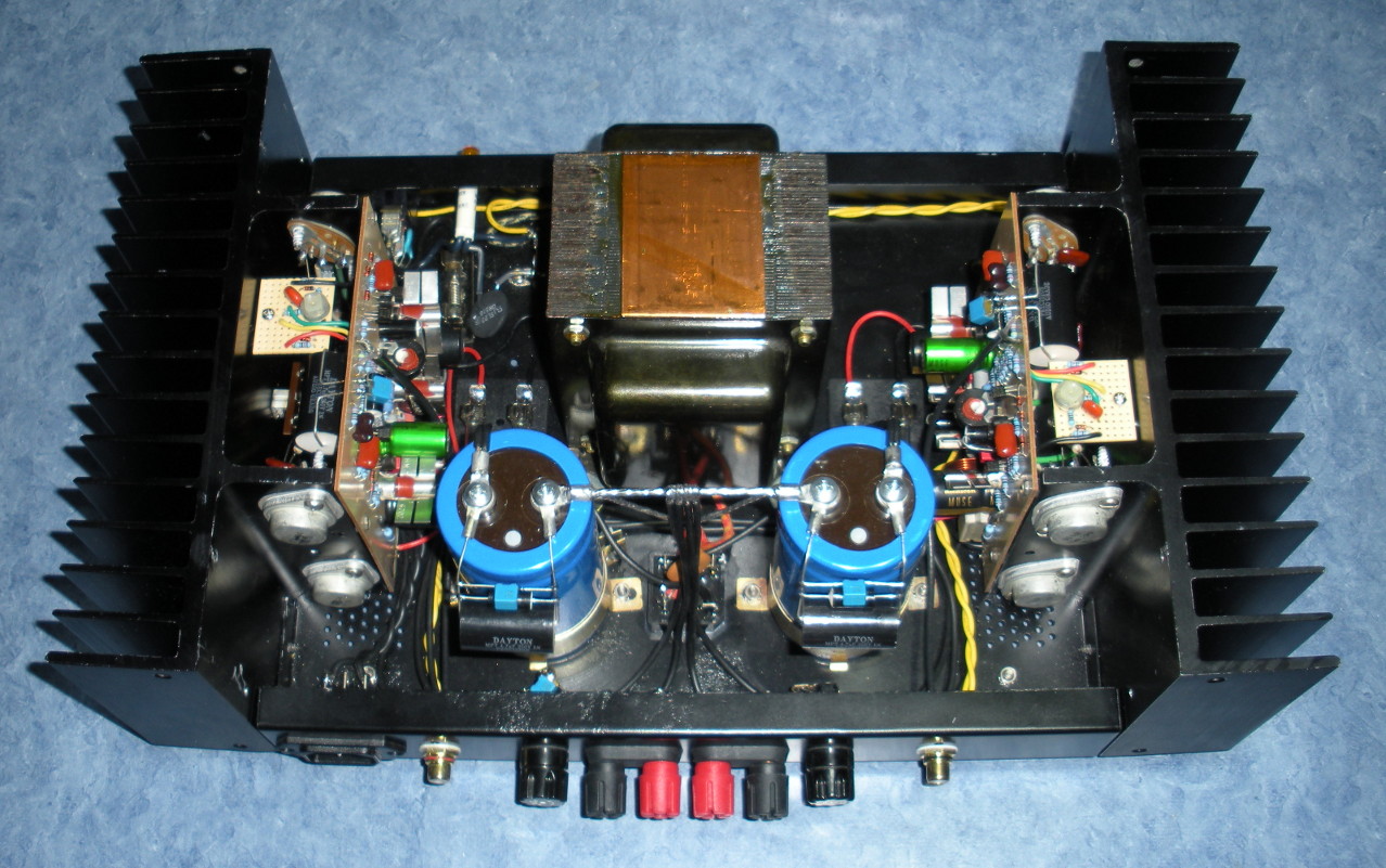

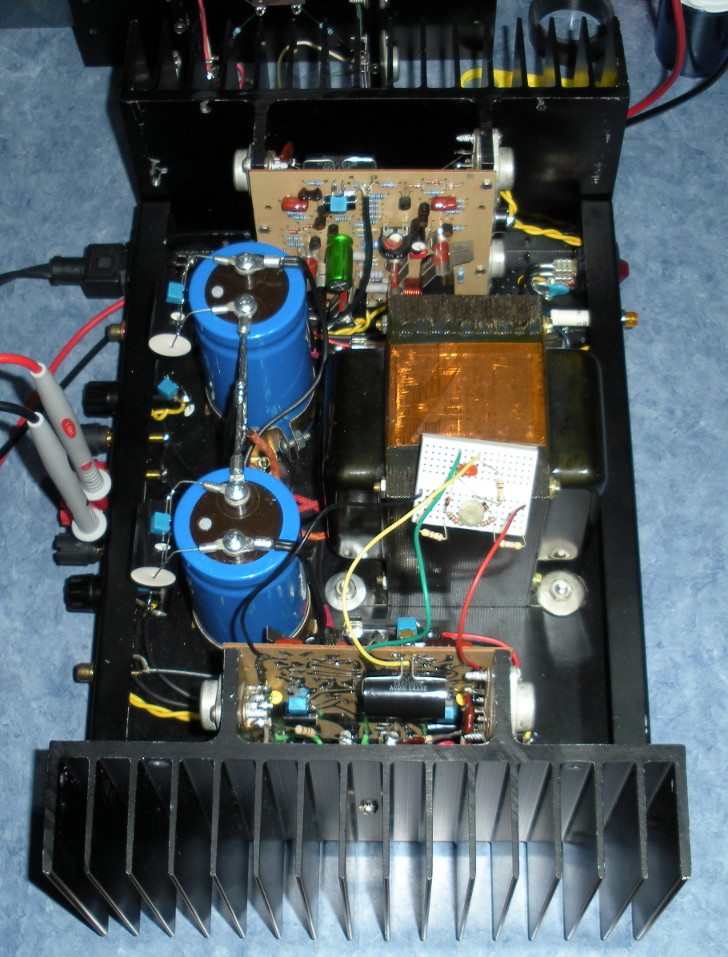

Put together a test circuit based on the DH220 design.
Had a 4.7K pot on hand, so adjusted the circuit for that.
I tried a 1 meg resistor between the pot and R3, but it was too much.
With the 100K resistor it worked fine, allowing for adjustment down to less than 1 mV.
I already have some metal film resistors on hand, just have to track down some good multi turn pots.

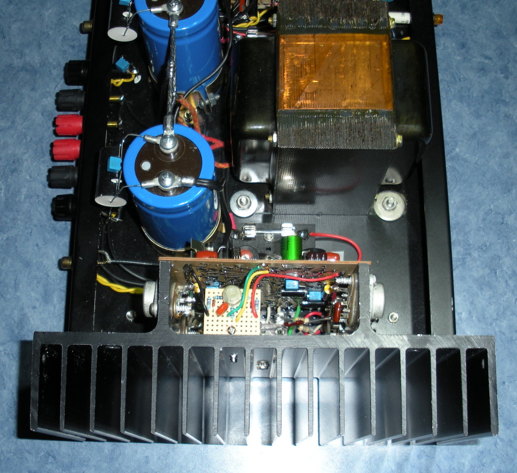

Mounted the components on perf board, into as small a size as practical, and then trimmed each board down to size.
Used some old serial port shell hardware to make a couple of small plated angle brackets.
I had to remove each C1 and its bypass caps to be able to install the boards/brackets.
I then fastened the DC Offset boards to the heat sinks, and wired them to the appropriate points.
Adjusted both channels down to less than 2 mV (including fluctuations).
Worked well, and did not have to alter or cut up the original PC6 driver boards.
Its an easy upgrade to do, the hardest part is to securely fit the boards into the available space.
The size and position of the C1 caps you go with will also need consideration.
Make sure you test fit everything before you start drilling holes and mounting stuff.
I have checked on the DC Offset circuit for the DH220, and there are some noticable differences between the two, in components and values.
Also tvrgeek, you mention splitting the input and output power supplies by lifting the output side of the 68 ohm resistors, I take it that you meant the R28 & R34 47 ohm resistors on the PC6 boards.
28 and 34 yes. They were 68 in the 120. Sorry for the delay.
Thanks tvrgeek for clarifying the R28 & R34 resistors.
If one does split up the input/output feeds for the positive, negative rails and grounds, are components like (R34, D12, C21), (R28, D11, C20) & R39 still necessary, or can they be removed completely?
If those are the separation points for each respective rail or ground, can both sides (input/output) be wired directly to the respective rails/ground?
I also ordered a transistor tester, so I can check into matching input transistors in the future.
Thanks for the recommendations on that Stormrider.

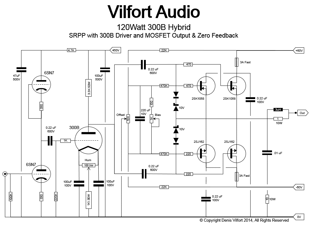

I also tried a 6sn7 to 300B to 3 pairs of MOSFET for a nice amp with zero feedback. Still have to draw up the schematic. When I do, I will post. It ended up being a nice sounding 250W 300B amp.
A 120W version could be built in a HAFLER 200/220 chassis - if you are willing to punch holes for the tubes in the top cover of the chassis. A bit messy - but it could be done. If you go that nuts, then I would also opt for a tube rectified power supply.
If you do not have the heart to punch holes in the old HAFLER, then the 2 X 6SN7 VAS and driver will work. Good luck.
D.
120Watt 300B Hybrid
This audio hobby is a funny old thing... It's a bit like cooking: you borrow insights and inspiration from all the good work others have done before you. Thanks to all those good folks, we can now snip a bit here and another bit there and then end up with some fun "new" circuits.
I started fooling with 300B's more than 20 years ago. And it is still one of my favorites. Alas we can only get ~ 8W or so from the old friend in an SE amp. To boot, the 300B's are expensive and so are good output transformers... Hundreds of $$$$.
But with hybrids, we can still get an old Hafler 200/220 on EBay and use it as a donor. Often for less than a few hundred bucks. We can of course also get some MOSFETs, heat sinks, power transformer and some power supply caps and build from scratch.
So this is the quest here: get the 300B sound and at the same time get enough power to drive most speakers. Not to mention rocking the house when you want to.
Thanks to the net, getting inspiration for such a thing is easy. Gordon Rankin for example still has his wonderful design article on "The Bugle" on his site: http://www.wavelengthaudio.com/bugle.pdf . We can take this topology and update the values for 300B and say 6SN7.
All we now need is the 300B to act as a driver to the MOSFET source follower output. To do this, we replace the output transformer with a 50W 3.3K resistor (wire wound non inductive). Then capacitor couple the 300B's plate to the gates of the MOSFET's. Those who are familiar with MOSCODE 300, will recognize the BIAS and OFFSET scheme here.
Sure, this is a bit "Frankenstein". After all, we are borrowing from Mr. Rankin and Mr. Kaye here. But is this not what our hobby is all about?
So how does this beast sound? It sound like what it is: a hybrid. But the cool thing here is that it retains the grunt of a 300B as well as its glorious midrange. The SRPP 6SN7 also works well here. Broskie has written extensively on the benefit of having the SRPP circuit working into a friendly load. Also please notice we are connecting the plate of the lower triode. This is mostly a taste thing. If you like, feel free to connect the 300B’s grid cap to the cathode of the upper triode.
The 300B also has an easier time of it. Not driving a transformer and difficult speaker loads, it is not breaking a sweat. Not to mention that we are running this (expensive) tube at ~ 50mA and ~ 300V on the plate so it will last for years.
Finally, all there amplifier stages are capacitor coupled – so any drift as a function of rolling and/or tube age will not affect operation. Which makes this a really nice DIY project. Have fun!
D.
