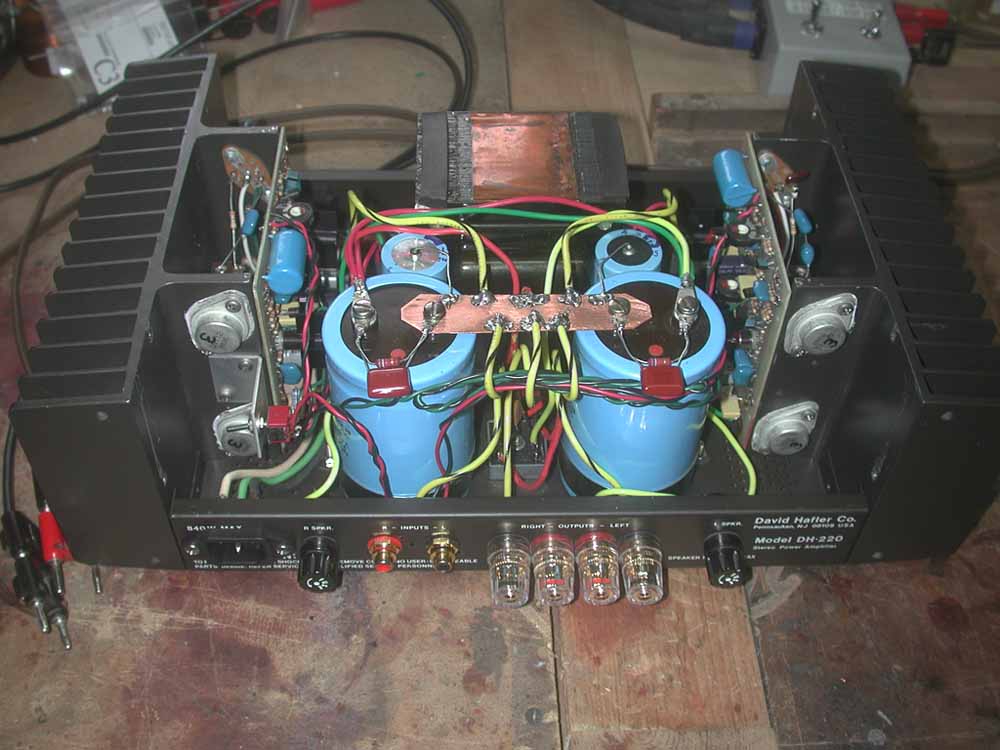

Here is one of my 220's with new 35,000 uf caps bypassed with 470 uf, 6800 ohm bleeders, and 2.2 uf caps. At the same time I replaced the RCA jacks with new modern gold plated and the Speaker jacks with same. I also put an IEC power jack in for a dedtachable cord.
At 8 ohms it does 155 watts with .007% THD. I haven't checked it at 4 ohms or in mono mode. I have a second one I am doing the same thing to and should end up with some nice monoblocks.

Input Z and Rectification
I am modding a DH 200 (PC-6 board) and have four questions.
1) Can I replace R3 (22kOhm) with a 47 K resistor to increase the input Z (I am using a "passive pre-amp" i.e., 10K pot and would like to have a 10:1 ratio on the "output" to input Z).
Any problems? I noticed this was done with the DH 220 (PC-19 board)
2) I would like to add a thermistor for inrush protection. What is the specification on this?
I assume it is simply wired in series between the switch and the transformer. Is this correct?
3) I will be bypassing the PS caps with 47uF caps. Is there any reason to go ahead and put in larger PS caps (replacing the 10,000uF caps). What is a suggested value?
4. Without having to add heat sinks, is there a way to improve the rectification? What would be the suggested specification? Would it be wired in the same way as before?

a) Input can be increased easily from 22k to 47k. Just change the corresponding feedback resistor from 22k to 47k too. Since the gain of the amp is determined by the ratio of the 2.2k and the 100 ohms there is no problem.
b) larger PS caps: I use 2 x 30000uf in one DH-200 and also 4 x 14000uf in another DH-200 with no problem. For the latter I use 2 rectification bridges (one for each channel).
c) "BTW, I will be also be adding bypass caps on the input coupling caps and also a bypass cap on the 470uF electrolytic (C5)":
good idea.
Tom,
You can up the filter capacitance to around a pair of 26K uF devices but they verge on the chance that switch and bridge rectifier might be damaged. If using such large capacitance you might want to look into soft start circuits.
Yes, you can put a thermistor in series with the incoming AC. Some just hang this device on the left channel thermal switch. Some question the use of a thermistor with an AB class amp as it might limit the dynamics when a lot of current is required. But, the DH-500 amp went to the use of such a device to protect its switch and bridge.
The 22k resistor cannot be changed. It must match the other 22k resistor in the feedback circuit, else a lot of DC offset will occur. There is more to determining input impedance than just on resistor.

Dick,
For clarification, the gain of the amp is determined MAINLY by the ratio of the 2.2k and the 100 ohms and not the 22k (or 47k) resistor. However, a small amp gain change is due to the divider of input circuit:
22k / (22k + 2.2k) = 91% compared to 47k / (47k + 2.2k) = 95%
Also, the 2.2k is in parallel with the feedback resistor which gives an additional 5% increase if 47k is used instead of 22k.
But, it will cause no harm to the amp.
