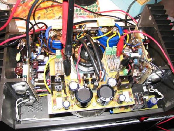

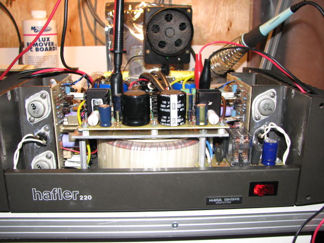

Hello everyone,
Merry Christmas. Finally had sometime to finish modifying my Musical Concepts modified DH-220GXB. Hard to get spare time with 1 and 3 year old boys.
I added a separate transformer and a regulator for the driver boards and placed it above the MC toroid transformer. To the right, just above the power switch I also installed a soft start circuit. This is the amp that got me started on the DIY path. IMO the GXB mod was the best of the original DH-220 mods from Musical concepts. I started with the original M mod, then DX, FX, GX and finally end with the GXB.

Congrats on your impressive work!!
Can you characterize for us the before and after differences in the sound of the amp with the regulators? Does regulating the voltage to the PCBs make much difference?

Hi
Very nice integration and available space optmization !!
What is the voltage you used fro the driver stage?
I see you used IC regulators but which one?

Hopefully I can notice a difference for all the work that went into this little project. The amp has not been used in my system for over 6 months during this latest work in progress.
I'll report on sound at a later date. I'm letting the amp burn in for a lititle while.

The front end circuit is set at 60v regulated and the driver transistor and output stage is at 65v unregulated. A 55v+55v transformer provides 80v+80v to the regulators.
Actually Fab, there are no ic used in this regulator. It is all descrete components. There are 2 sets of pass transistors. The prereg uses TIP 122/127 and the main regulator uses K216/J79 mosfets.
