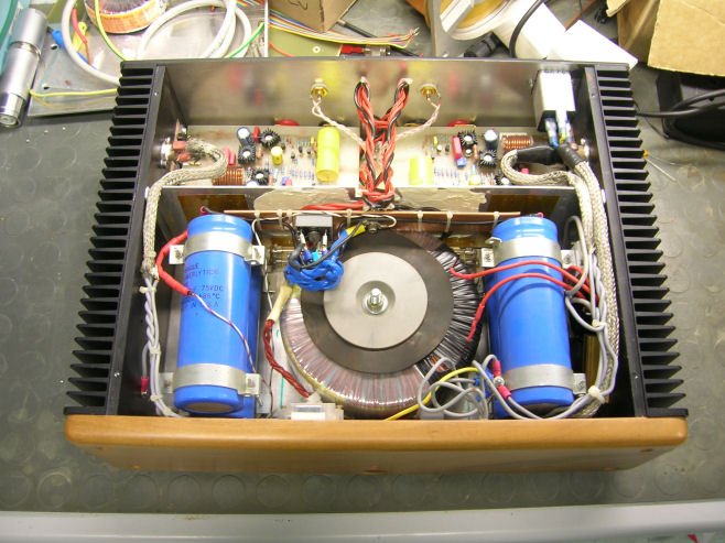

I start including a picture of my amp.
Thank you,
Paolo
Thank you,
Paolo

I see that you are already using another chassis sicne the one of the DH-2xx is a little to small...Therefore, if you check my web site under "Double mono dual classes Power Amp 15W/8 ohms Class A - 75W/8 ohms Class B" you will see a circuit schematics based on the DH-200 topology but with a few enhancements...
Very nice construction
