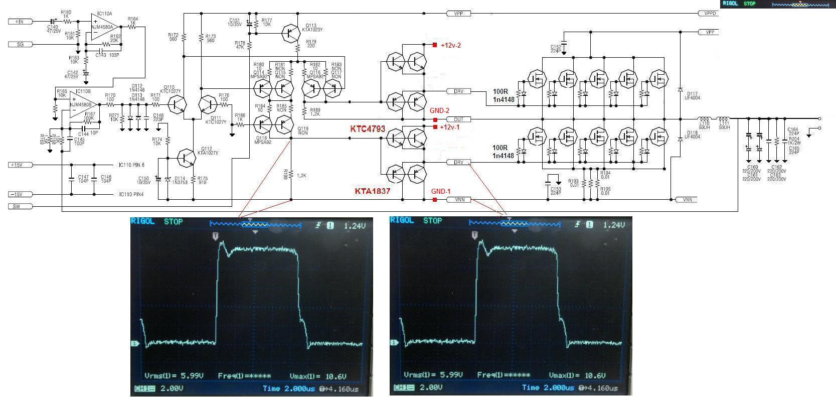

i replaced the irfp4229 with a pair of irfp264 i had and something must of happend cause i blew a KTA1837 ... maybe i should rebuild the driver board using new transistors ... i found that resistors that should have the same value are quite different so might have to deal with those to ...

In the scheme by Sony r191,192 = 390 ohm but is missing gate resistors.
Do you think that if we increase r191,192 at 390 ohm and reduce gate resistor from 100 to 20 ohm I will get rid of problems?

Check for resistors with actual value outside tolerance range first.
I would also check DC current gains of Q110/Q111, Q114/Q116, Q118 and the low side NPN drivers (all the ones that run hot) with multimeter. The pairs should not measure very different.

mgm2000ro gave me this ideea of a modification .. it implies using two separate 12V supplys for the totempole... one is referenced to -90V and the other one is referenced to output...
this should provide a clean square wave for outputs ..no ? what do you think.. ?

Yes, this is the standard solution. But the question was: is it desirable to provide clean square wave in this circuit? I don't know the answer, because there are possible problems.
Have you find the wrong parts yet?
Those two waveforms, modulator and driver out, look to be exactly the same signal.
I'd expect the frequency to increase with the + drive resistors gone, but double is going to ratchet up switching losses. Are you getting any cross-conduction?
