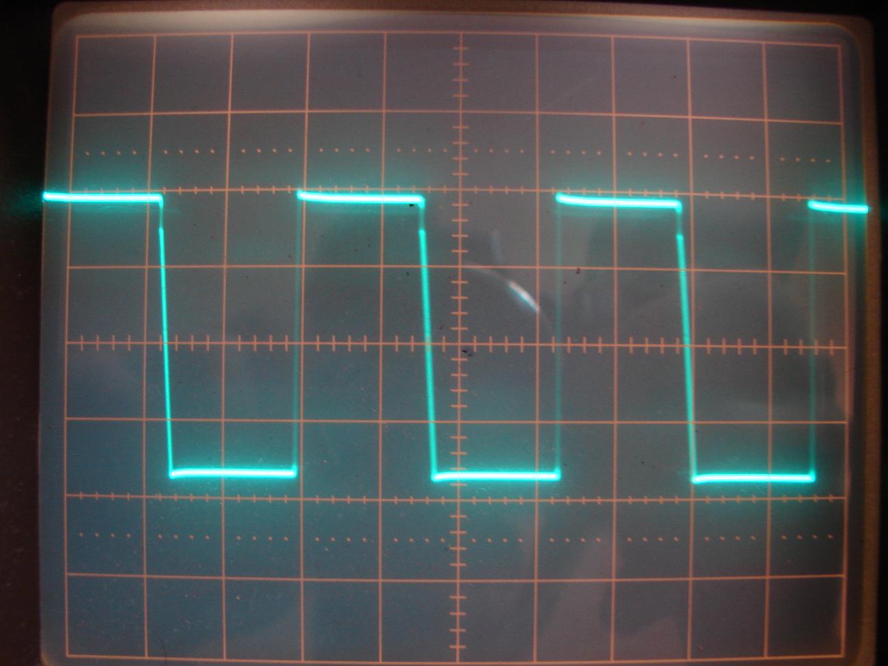

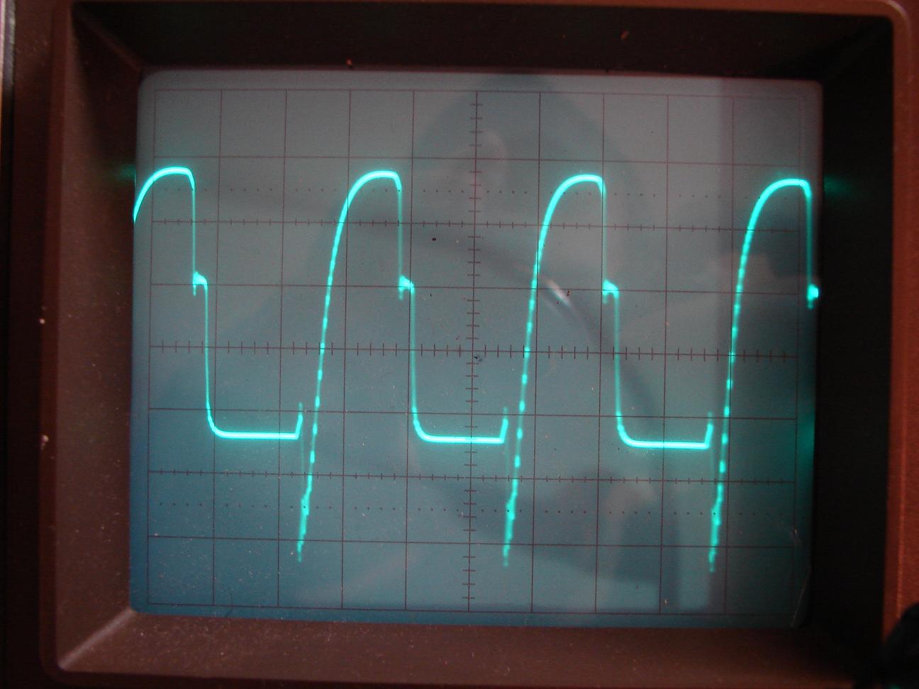

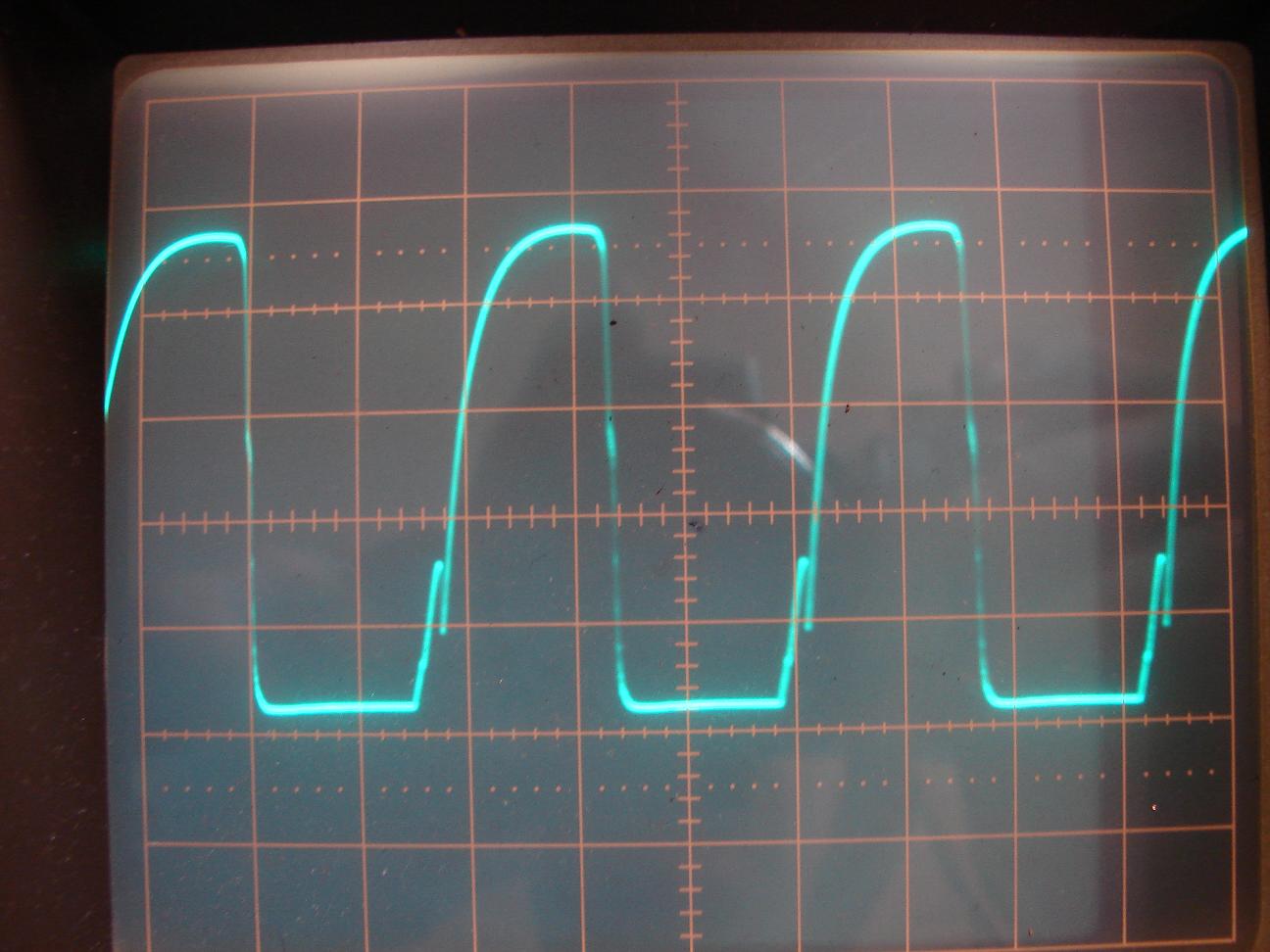

new scope measurement ... Q134 is getting hot ... q136 is not !
i did this measurement only with 2 output devices so i can see better witch one is getting hot etc.
i`m going to try with irfp264 to see what it will look like ... unfurtunetly i don`t have a DSO ... only analog scope
Which is which? And where did the two gate waveforms come from?
Showing gate and drain signal on the same screenshot would be much better, also it would be more informative to show them with lower time/div (1 us/div for example).
Q134 is on the positive side and 136 is on the negative side ....
Maybe because it starts to conduct too early, but it's hard to tell sure from these pictures. I can't join events together. This is what a dual channel scope is mode for. And some description about the pictures.
yes... the scope is dual channel .. but i`ve only got one probe ... i guess i have to get another one ... all pictures are 2v/div for gates and 50V/div on the ouput and all are 5uS /div
But what signals are on the pictures? Why are the last 2 are different?
edit: OK, now I see from the filename, but you could have write it down...

Do high side gate diodes work well?
Turning off of high side is too slow.
Maybe the pnp BJTs are damaged. It can be seen from the waveform of emitter.
Turning-off of high side is ok, it's either turning-on of high-side what is happing too early, or turning-off of low-side what is happening too late.
I would increase R191 and see if the rising slope of the switching waveform becomes less steep, more like the falling slope.
Of the two gate waveforms posted, isn't one IRFP264 and other IRFP4229? Or is one high side and one low side?
Note that things may go wrong by adding more devices because di/dt increases.
Anyway, if one MOSFET is not clamped properly, sub-optimal gate drive increases the chances of failure dramatically because more heat is produced, while it could have survived longer with optimum drive.
Do you really think it's OK that miller region lasts for 1 us with only one MOSFET? If high side gate driver were intact it shouldn't last more then 100 ns! It can not be OK!
IMHO no way. The gate voltage is not even close to threshold during transition. Less then 1.5 V is not enough for anything.
This is the same statement as the previous.
I bet it won't.
High and low side. First one is high side. And this shows the unquestionably slow turning off.
And things may go wrong because of other reasons also.
I agree!

This way it doesn't help at all. But it's very difficult to tell what could help. Basically the whole thing is about coupled inductances, the high di/dt loops has to be low coupling ratio with sensitive circuit loops, but yet we know almost nothing specific about those loops except for the plain existence.
But forget it for a while! The statement that it is the cause of your every problem is only speculation without any evidence. Contrary to this the high side gate driver has some prooven problem. Check that facking BJTs and diodes!
Pafi: But you were the one that noticed that the rising edge of the switching waveform was way faster than the falling edge. This can only have one cause: High side is turning on too soon.
Of course, some of the driver transistors are subject to high thermal and voltage stress and could have degraded performance (like lower gain and high leakage current). The low side could be lagging for that reason: Degraded Q114/115 and/or Q118/119, which are the only ones that have to sustain high current and high voltage simultaneously during 50% of the time. Additionally, collector leakage in these transistors can increase the off-state Vgs...
I also misinterpreted it first, because I was too lasy to do the calculation, but later the high side gate waveform made me think it over. Cosseff=290 nF, so 2*3 devices results 1.8 nF effective capacitance. 4.5 Ap on the inductor makes output node to change with 4.5A/1.8nF=2.7V/ns, so duration of a free (ZVS) transition is 180V/2,7V/ns=72 ns wich matches to the rising edge. Consequently the much slower falling edge must be faulty.
We were the victim of an optical illusion, we got used to much higher switching frequency (and much lower time/div), where a visible slope is normal.
