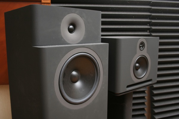

Rather than blather on about these little beasties from ignorance, or bash the personality or english as a second language issues of the designer, have any of you actually heard these speakers?
I wonder if I might live to regret saying so, but I have heard the QM10's.
I haven't "lived" with these or listened to them in my own room or compared them to a reference so my comments should be taken with a grain of salt. For what it is worth, on initial impression they sound good, OK, a little dark, IMO, like too much baffle step correction, a wide bass hump, or a shelved down treble. These things do really have surprising bass - especially considering the 4" woofer. Honestly, probably too much bass for my preference. These are said to need boundary loading, but I am left wondering how they would sound a little further from the rear wall.
Several other people said these open up if listened to more near field (front center at a club session) but I did not listen to them this way.
Construction, these boxes are very lightweight with a spartan, dark-textured finish. The overall aesthetic and fit and finish is good - no visible particle board edges, etc... - but certainly unassuming. The tweeter looks like a $4 MCM electronics mylar item, but isn't spitty or nasty. The woofer is said to be from Tymphany.
My preliminary opinion: not worth 1/4 the price, but there are worse buys out there for $1700/pr, or whatever they are going for.... the advertised price seems to change (upward) almost daily.

Off course physics dictates what is possible but I doubt there are many (if any at all) such small speakers with that level of performance. And you know what.. the QM10 is not meant to be a discoteque speaker system.. Also the QM10 has a bigger box than many other smallish speakers with a 4-5" unit... guess what.. it's because it gives less distortion hence engineered for sound quality. 😉
About the floorstander it has really nice performnance as well and naturally it betters the small brother due to laws of physics. It measures well..

Loving the huge step in the baffle for tweeter time alignment. I can see it now: "So you've time aligned the tweeter, nice work, but what about the diffraction and comb filtering caused by that surface right in front of its wave launch? Couldn't you budget in a 1/2" roundover or something?" and the guy goes "Erm..."
Sorry I'm being unduly harsh, I've never heard them nor likely too. But from appearances, for the money asked and from my own engineering sensibilities there's not a lot to capture the imagination.
The speaker can reproduce a pulse.. in more than one direction. How many other speakers can do that?
The roundover you suggest.. you don't think it would be there if it would produce a better result? It would direct energy towards the listener and casue the problems you are talking about.
I have listened to several of the speakers from this designer. I have also seen some measurements. Reading the "expert comments" on this forum (which I have been on since 2002) makes me laugh!
Educate yourself guys before going on like you do.
/Peter
