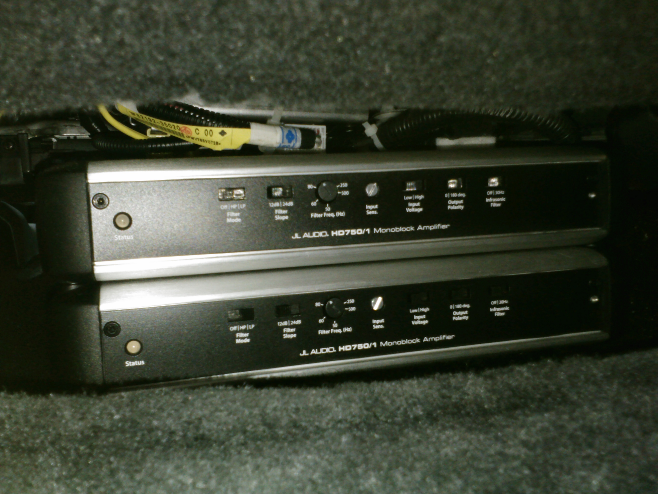

Hi Einric,
I just checked out the "Diamond Audio" product line; very impressive stuff, and "top shelf quality"!! I feel like some putz :( , I considered myself, a very well informed young'ish (older) dude; apparently... "I'm not"! :no:
I'll be looking into their products for some of my near future project endeavors. Perhaps they have an in-line "low freq signal processor" (parametric EQ'); I've been looking for one that'll fit under the passenger seat in the truck (I have the amps "Stacked" under the driver seat already) Here's a look below: "you can click on it for a larger peek"...
