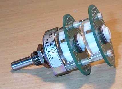

Elma also makes a series attenuator, the 04A2A00S, which might work as a cheaper alternative. What do you think about this?
I am checking on pricing now, but it should be quite a bit cheaper.
Datasheet:
http://www.elma.com/files/products/rotary_components/pdfs/audio_switches_series_a_002.pdf
Brian
I'm not that sure about series attenuators (with stock resistors). I have a feeling than in some cases those are worse than a good pot. But if properly chosen, SMD resistors are used, they might be pretty good. IIRC, Jonathan Carr is using that type of setup (with different swittch though) in Connoseur preamp.
Peter Daniel said:I'm not that sure about series attenuators (with stock resistors). I have a feeling than in some cases those are worse than a good pot. But if properly chosen, SMD resistors are used, they might be pretty good. IIRC, Jonathan Carr is using that type of setup (with different swittch though) in Connoseur preamp.
The switches do not come with the resistors, so it depends on what you want to pair up with it.
If you are looking at SMD resistors, the 2 channel DACT switch is in a series configuration with SMD resistors and costs $180. It uses the same Elma hardware as the one that I am considering.
Here is a picture of the series resistive attenuator without the resistors.
Brian
