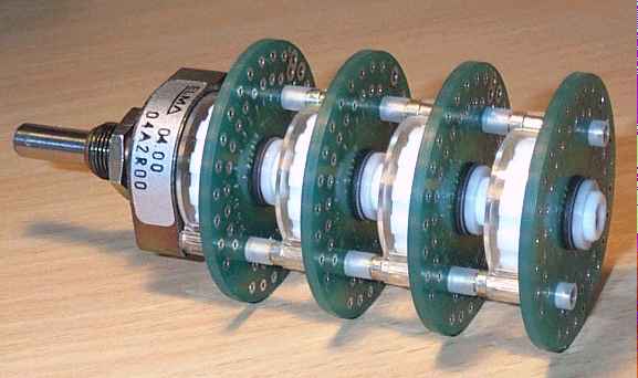

Anyone interested in a stepped attenuator kit to go along with the gainclone kits? I have done some research, and the best solution seems to be the Elma stepped attenuator ladder seems like best switch out there to use. It has low contact pressure to make it silky smooth, compared to a standard 24-pole 4-pole shorting switch. Elma also makes the hardware that goes into the DACT attenuators. All contacts are gold.
I ordered one to try out, and I will post results when I get it. Would anyone here be interested in a kit with one of these and a resistor set? The single unit price for these is just over $90, but if I could get enough interest, the price for a kit could be under $90 (hopefully around $80) including all the resistors needed to put in it. This is probably the nicest attenuator on the market that you can buy, and probably the best solution out there for the gainclone kit. Expensive resistors could be substituted in the most used listening positions on the unit.
I will post details when I get the one that I ordered, and see if there is enough interest to organize a kit for this.

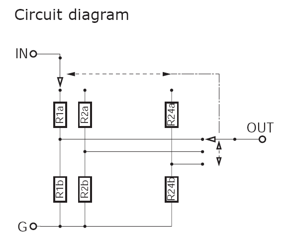

tg3 said:And post a schematic with your review too, as I always confuse the different passive attenuator topologies.
Here is the schematic from the datasheet, just 2 resistors in the signal path at a time. This should be the cleanest solution.
I like the attenuator that I have in my gainclone now, but it pops when I change settings, and this one should not have any problems like this, and be silky smooth when changing the volume.
The best part about this attenuator, is that you can easily put it together, as the pcbs on it are made especially for the task, unlike regular 4-pole switches.
