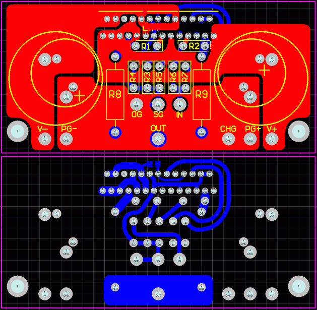

I was reading that too and it seems like a good idea. I noticed that sometimes the diodes warm up quite a lot so having some sort of heatsink bar would help with disippation. This would require fliping diodes in the other row to have the taps on the inside. It shouldn't complcate the traces too much. But I think that one flat bar piece, 1/8 thick and sized approx 1 x 3 should be enough. Don't go with separate heatsinks as this will add unnecessary bulkiness. Of course adding isolation pads would be required.
The board looks really nice now, isn't it?😉
I have a technical question to those who know more about board design. It seems like adding a track from pin 17 south to connect it with V+ plane would increase current supply to that pin. Yet it creates a loop. Is it good or bad?
Also, would trimming both power planes on the sides, like on LM3875 boards, would be recommended? This would somehow decrease the unused area of the plane and help in directing current where we really want it, towards the caps.

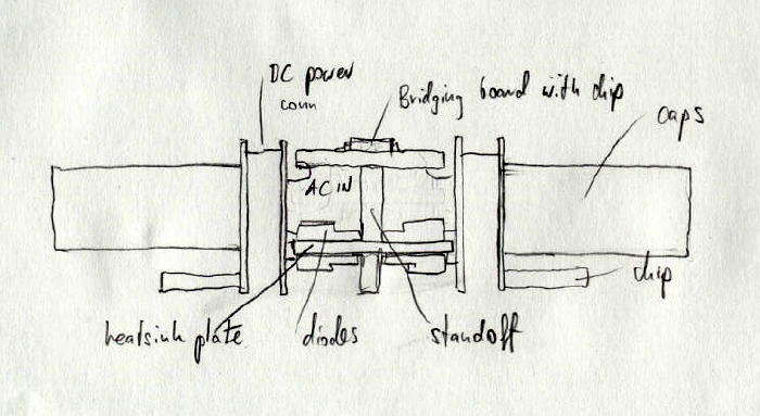

Here's another approach to simplifying connections in bridged version. You have 2 boards facing opposite ways with the bridge board between them.
To each of the amp's board, a rectifying board is attached. Short wires carry DC power as pads on both boards are aligned.
Both rectifying boards are tied together by heatsing plate, to which diodes are attached. There are 2 standoffs to mount that plate to main heatsink.
Additional standoofs provide mounting support for a bridging board, containing DRV134 chip and regulators and small bypass caps. The power to bridging circuit is taken directly from rectifying boards. There are only 4 wires to supply AC to both rectifying boards.
The rectifying boards have a ground plane on one layer, providing a shileding from diodes, also the bridging board has a ground plane and additional shielding is provided.
It seems like an interesting approach to bridging concept and this doesn't require mirrored boards.

1. Where are the output networks (RSN1,2 CSN1,2)? The guys from National didn't put them on the schematic for fun. They need to be on the PC Board there seems to be room above the filter caps. They are part of the compensation for the amp and need to be there. I don't know why people want to leave these off or mount them on the binding post. PUT THEM ON THE BOARD.
2. The CHG terminal is for the ground return for the center tap of the transformer I take it. Put a pad right next to the OG pad, as close as you can get it. Separate diode bridges for each cap would be even better with returns directly to the filter cap GND terminals. Location of this ground return is critical for how much ripple noise shows up on the output.
3. Look at changing the V+ and V- connections to the chip to lower the resistance between the supply caps and some of the supply pins on the amp that have more resistance in their traces. Something like this picture maybe......
4. The rest of the layout is very good and I can't think of anything I would change.

I suggest reconsidering the idea of orienting the diodes with the tabs facing outward (rather than towards each other), and using two heat sinks. This eliminates the possibility of large stresses on the diodes if the combined thickness of the heat sink and insulators does not exactly match the gap between the two rows of diodes. Also, two heat sinks provide twice the surface area for convection cooling, and allows the option of using finned heat sinks for even better convection cooling. Or, eight small finned heatsinks could be used, eliminating the need for insulators.
However, it would not work as well with Peter's bridged arrangement; cooling by conduction to the chassis/main sink is easier with the single, central PS heat sink.

I guess Zobel discussion went already to far, so I created a separate thread for it: http://www.diyaudio.com/forums/showthread.php?s=&threadid=34130
Everybody interested in LM4780 board, please be assured that the board will feature a Zobel network.
