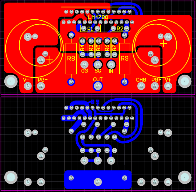

Here is a modified layout, following some of the suggestions. I worked on it with Peter last night. I tried putting the resistors above the capacitor, but it didn't look good. Instead, the R6 and R7 were swapped to equalize the trace lengths a bit.
As for the T, I think that it is unavoidable, and shouldn't be an issue. I increased the width of the output trace from the IC chip, which should help. I had tried using both layers, but came back to this solution.
The heat relief traces are removed as well.
Any comments?

mhennessy said:
I think that we're all in agreement (from here, and the previous thread about this board) that Nationals board is not an example of an optimised layout 😉
It might not be optimised (for nice appearance), but it definitely is an example of a proper layout.
It's just that some small issues you might think affect the performance, in real life may have no importance at all😉
Now I really like the layout.

The datasheet in page 5 suggests 100 nF+ 10 uF + 1000 uF. I think you at least should have 100 nF.

Actually, it's neither. It's an example of a layout done by a draughtperson, with relatively little regard taken to layout or appearance, other than providing a rudimentory star earth. Traces are much longer than they need to be, compromising performance. I thought this was discussed in another thread? Anyway, even your initial paper draft was miles better than this layout in both regards 😉
peranders said:One thing though, how about the hole size for the speaker cable? ..and what about decoupling, like 100 nF close the the IC? Have you forgot those? I advice you to put in 2 psc. 100 nF 63 V polyester.
I agree about hole sizes - but having read previous comments about decoupling, I don't think you'll win that one. I believe Peter has found them unneccesary based on listening tests using good quality electrolytics. I will add just one comment - think about when the electrolytic caps start to age - that's when small parallel decoupling capacitors come into their own.
Brian - I like the new version of the layout. I might have some small comments, but I don't think they're worth voicing at this stage. Just one thing that I notice - you're using vias! Doesn't worry me in the slightest, but what does Peter think? 😉
Who will be soldering the speaker cable directly into the board? You need a short cable to the speaker outputs on box outside, so it needn't be that thick. It's that connector that needs to accept a thick gauge wire.

BrianGT said:
Any comments?
The pcb layout looks OK to me. But there are some issues that maybe were discussed in other threads, but I missed them.
If this is a NIGC, where are the capacitors that should be at the input and feedback? If I am not wrong this was the same philosophy used on the single NIGC boards, but aren't you running a certain risk by not using those caps?
Carlos

Brian, when I think of it, you have unnecessary long traces going in long loops. Since you are going to have this pcb professionally made why don't you shorten all signal traces and uses 15 mil traces between the IC pins? I should also go for more groundplane. Consider also that rather much of your copper areas aren't very usefull. Think electrial field inside these areas.
Not having proper decoupling is like not having your hands washed before cooking dinner. I vote definitely for proper high frequency decoupling. You can bet on that some people which are building this amp will encounter RF/EMII trouble. It's easier not to solder in a cap compared to patch it in.
As a comment about mhennessy's remark: I think it's really good of you designing these pcb's but having eagle control of all parameters yourself is nearly an impossible task, even for a pro. It takes years of practice, maybe a lifetime! I wonder why Mr. D hasn't comment this project?
Brian, why don't you skip the symmetry and place the smoothing caps at the left side only. Most of the power are connected the left side if the IC.
mhennessy said:Brian - I like the new version of the layout. I might have some small comments, but I don't think they're worth voicing at this stage. Just one thing that I notice - you're using vias! Doesn't worry me in the slightest, but what does Peter think? 😉
As for using vias, I assume you are referring to the two traces on the top layer going to the feedback resistors. I actually forgot to change them back to the bottom layer, after playing around with them earlier. I put them back on the bottom layer now. I doubt that it would make much difference, but I would rather have them away from the power traces a bit more.
What small comments do you have? I am curious. You can e-mail them to me if you don't want to post them here 😉
Brian
If you have 0.1 ohms resistors it's probably not very important to have thick wires but I imagine that it looks nicer if you can choose such cables if you want to.carlmart said:

Also Brian, my remarks are probably not very important. I gather the amp will work alright but wouldn't it be a kick to have done everything to make it right?
peranders said:Brian, when I think of it, you have unnecessary long traces going in long loops. Since you are going to have this pcb professionally made why don't you shorten all signal traces and uses 15 mil traces between the IC pins? I should also go for more groundplane. Consider also that rather much of your copper areas aren't very usefull. Think electrial field inside these areas.
The pins on the LM4780 are quite a bit closer than the LM3875, so I don't like the clearance issues with running traces in-between them. I really don't see any reason to need to do this. The only long traces are the input traces.
As for decoupling, I was going to just try soldering decoupling capacitors on the bottom of the board, and see if it makes a difference. I don't really see an optimal place to put them, except on the bottom, on the leads coming from the electrolytics, or the extra mounting holes (the unused set)
Brian
peranders said:Brian, why don't you skip the symmetry and place the smoothing caps at the left side only. Most of the power are connected the left side if the IC.
I initially tried, but it didn't seem to come out as nicely. I had the power inputs on the far left, and the inputs on the far right, with the output and grounds in the middle. The board size increases a lot also, since the BG 1000uF STD caps have large footprints. After trying this, I decided that the small tradeoffs of the current layout are greatly outweighed by the symmetry and form factor obtained by the current layout.
Brian

peranders said:and what about decoupling, like 100 nF close the the IC? Have you forgot those? I advice you to put in 2 psc. 100 nF 63 V polyester.
That size decoupling cap is best soldered underneath, detectly to electrolytic, if you really needed. Providing special spots for those caps on a board would be compromising simplicity of a ground plane. I got used to attaching components to both sides of PCB (whenever more convenient) and it shouldn't even present clearance problem with such small value. I have my protoype working withaout any extra bypass caps and it prforms fine.
I looked at National's layout again and I think a lot of thought went into creating it. If tight packing of components wouldn't be my goal here, I don't think I could improve on that (National's) layout. It is very good for what it was intended. Maybe they just wanted to show that the chip performs even when not every trace on PCB is analysed in depth and optimised to perfection?😉mhennessy said:
You definitely don't need input caps if your source is protected against excessive offset. The two parallel channels I've built presented much lower offset than what I got with LM3875 (it was about 24mV). As to the feedback capacitor, I never required it with LM3875 chip either. It's hard to predict if its really needed here, that's why we go with a smaller initial run for testing purposes. After that we will know for sure.
