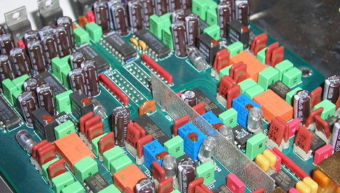

Now check this tightly packed Levinson board. Although some of those polystyrene caps are mounted horizontally, whenever space was limited, they mounted them in vertical position. I really don't know why people think that this way of mounting components is compromised? It all depends how it fits in a circuit, but I'd rather compromise placement of 2 components than other, more important aspects of the design. I wouldn't go with bigger board just to accomodate 2 resistors (which you propbably won't be using anyway).

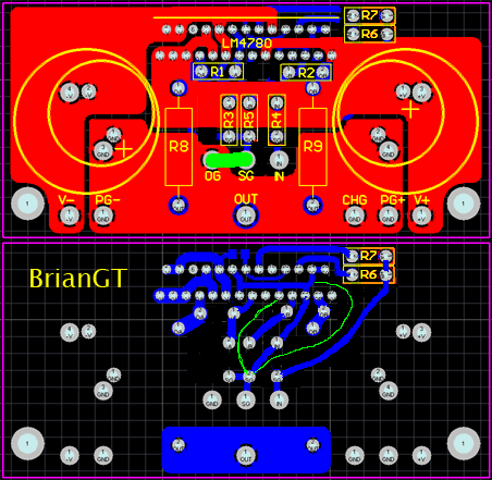

I couldn't resist improving the signal earthing further (possible alternative route shown in green, although I prefer the blue)
Brain, I'm sorry to say but this green trace is doing no good at all. I had also such ideas when I was younger but those traces are just antennas.
Check also my grounding, green.
Hi Peranders,
I wonder if you thought I was suggesting adding these traces along with the existing blue trace? Just to clarify, I was suggesting alternatives - I only intended Brian to use one path. More than one would create loops, which is bad (as you say). Sorry if it wasn't explicit in the origional post (although re-reading the bit you quoted, I think it was fairly clear)
Mark 😉
Peter Daniel said:
If you check pin out on the chip, the pin where you connected blue trace is NC. The best connection point for ground path would be your left, green trace.
Thanks - I hadn't noticed this - but National board connects these NC pins to ground, which is what Brian had done, so there's probably no real need to worry about this 😉

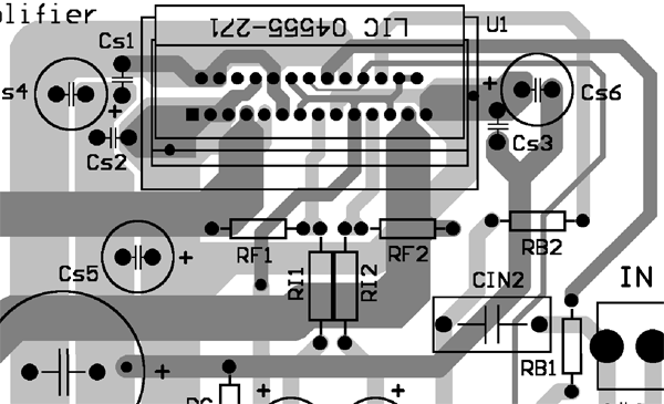

Regarding long traces from input resistors to the chip, I might be concerned with them, but obviously it wasn't a concern of National design team when they made evaluation board. Those traces are even longer on their board.
BrianGT said:
Here is a picture of the National Evaluation board layout, for comparison purposes.
Would the output track where Rf2 connects be considered a T track?
I think that we're all in agreement (from here, and the previous thread about this board) that Nationals board is not an example of an optimised layout 😉

I think that mounting resistors vertically in your PCB is fine, and a useful compromise because it contributes to the overall small size. But, just for info, here are the objections to them
Increased suscecptability to RF pickup - this can be very serious in some applications. The problem is caused by having a conductor at right-angles to the ground-plane, which forms a good little antenna
Reduced reliability. Sounds unlikely, but think about how stuff gets serviced. When routing around inside a piece of kit, it's easy for these components to be knocked over so that they touch adjacent conductors. To get around this, some manufacturers use special, pre-formed resistors that have the exposed wire covered in the same enamal as the resistor body (you've probably seen these in el-cheapo kit)
Mechanical stability. For larger components that run hot, there's a greater chance of bad solder joints appearing because the mechanical stress on the joints is greater.
There's probably others as well, but it's still early in the morning for me 😉
Just to finish with some (hopefully) sensible advice, when mounting components vertically, you can avoid some of the issues by deciding which way round to place the component. In the ML example above, I wouldn't mind betting that the long exposed wire was connected to ground, or failing that, the lowest impedance (or "earthy") part of the circuit.
So, for any resistor in your PCB, you can work out the optimum way to vertically mount all of the components, by just thinking about circuit impedances. For example, R4 should have the long lead connected to ground. The long wire of R2 should go to in the IC output node, as the input end of that resistor will be very prone to pickup.
Hope this makes sense and helps,
Mark 😉
