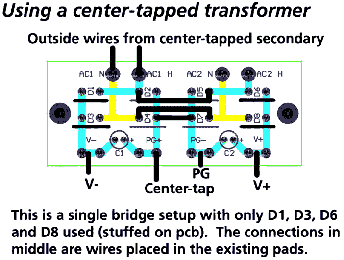

Meanwhile, in Brian's new users guide, chapter 3.1 goes like the attached picture. Why would someone want to use Brian's solution over the previous one ? Is any of the two solutions better than the other ?

moving_electron said:In section 3.1 of the new manual it states:
"The original standard application of this kit uses the first, a transformer with dual secondaries. For this application, the primaries are attached to the mains, while V+ and 0+ are attached to PG- and V- and V- and 0- are attached to V- and PG-."
Is this what it is really supposed to say??
It's late here but this doesn't make any sense to me.
This was a typo in the manual, it should have said:
"...while V+ and 0+ are attached to PG+ and V+ and V- and 0- are attached to V- and PG-."
I have corrected this and updated the posted manual.
Here is an alternate explanation of what is trying to be conveyed:
For the standard power supply configuration for the kit, a transformer with 2 pairs of secondary windings should be used. The rectifier pcb is setup in a dual bridge rectifier configuration, where each secondary is rectified to DC, then the dc voltages are referenced to ground on the amplifier pcb to obtain +V and -V. To wire the input AC from the secondaries into the rectifier pcb, wire 1 pair of secordaries into the AC1H and AC1N connection pads on the rectifier pcb, ane the other pair of secondaries into the the AC2H and AC2N pads. For the transformer primaries, they should be connected to the AC mains with a fuse in series with either the hot AC line, or two fuses, each in series the neutral and hot AC lines. If your transformer has dual primary windings, it is able to be configured for both 110vac/220vac AC mains for domestic (us) or overseas usage. [parallel mains 110vac for US, and series mains for 220vac] (Avel Lindberg transformers have dual primary windings for this purpose)
I wrote this up real quickly and haven't put time to proofread it, but I will add a similar text to the manual, assuming that I correctly wrote the above paragraph.
Brian

I could not manage to get Sherman's method to work, but that may have been because I was trying to parallel two transformers at the same time. I think I blew 5 fuses trying to get it to work.
My solution was to not even use the power supply pcb that was supplied, and just made two rectifiers (one for each channel) with the 8 diodes. That worked wonderfully, and gave me two monoblocks. Just a suggestion for anyone out there that wants to use a CT. 🙂
Variac said:...transformer stuff...
If you are stuck with a centertapped transformer, if you peel back the wrapping on it, you might find that it is actually dual primaries, with the windings tied together to make a center-tap. I have heard of a few instances of this.
As for the single bridge not being high end... it might be a slight tradeoff, but my solution of the single bridge appears to work. With the dual bridges, my concern is that ground loops might be created, since the GND connect is tied together at the transformer, then seperated, then tied together again. If only a single ground connection to the amplifier pcb is used from the power supply board, then this problem might be avoided.
As for using dual transformers to form a single supply, if the samples are not exactly the same, the DC levels might vary a bit more than using a single transformer with dual secondaries, causing additional dc offset.
I would recommend trying different power supply configurations, without the amplifier pcbs connected, then see if the DC voltages come out correctly with a multimeter. Also, keep safety in mind, wearing safety googles and carefully handle the mains.
Brian
mateo88 said:I could not manage to get Sherman's method to work, but that may have been because I was trying to parallel two transformers at the same time. I think I blew 5 fuses trying to get it to work.
The current kits come with two rectifier pcbs, so a single bridge could be assembled one each, with the wiring shown in the user's guide, using the available parts. For the basic kits, 100v 4.7uF fc capacitors are included, so that they could be used with a single bridge, across +V and -V without overvoltage problems.
Then, each single bridge pcb setup would power one channel.
Brian
Yeah, I have the old kits, though, so I just made pretty little diode squares and plopped the capacitor on top. I actually like it that way, nice and compact. 🙂

Here is an example of what not to do when wiring up your center-tapped transformer:
If you look closely, you will see that half of the centertap secondary is shorted out/reversed in polarity. The transformer is a 42vac center-tapped transformer, meaning that 21vac-0-21vac is desired with respect to the center-tap being ground. The two wires that go to the center-tap should go to the AC1H and AC2N connections on the pcb.
Be careful not to do this, as might possibly blow up capacitors, blow fuses, ruin chips, etc...
The primary AC connection is not shown in this picture, but make sure that a 3A or similar slow-blow fuse is connected in series with the primary hot AC wire (or both the hot an neutral wires).
As for the strange triple primaries, they are wired correct, as this is a surplus Chia Yu Co Ltd transformer from Apex Jr:
