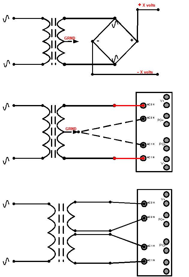

Transformer wiring
Hi All-
I know there have been MANY discussions about transformers and wiring for Brian's Gainclone Pwr boards but I never found what I was looking for so I drew this.
Hope it is helpful to some one.
Troy

Toroid transformers usually have two separate windings but it will work also with a center tap. Note that you only can use one rectifier bridge. When you have two windings, you have choose to have one or two rectifier bridges.
If you plan to use a transformer with only one winding and no center tap, this requires more work. Look in the datasheet how you must do.

Center tapped x-former
Hey variac-
I drew the diagram according to what I interpreted from Brian's email.
"Troy,
It looks to me like your power supply is wired up wrong. You need to wire the AC1H and AC2N to the center-tap on the transformer, which forms the PGND connection. I would recommend swapping this and checking your power supply voltages."
I have several transformers I bought from Steve @ Apex so I am going to evaluate the sound with each pwr option on the diagram.
I have NO DOUBT that the dual transformer version will sound best, but some people may be more inclined to try the GC if the cost could be minimized.
