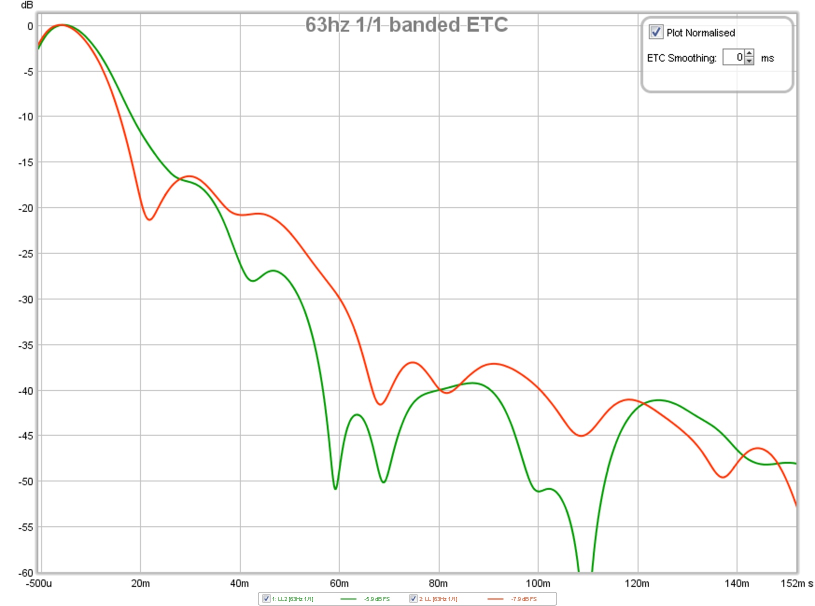

But lets think about the original goal: A tighter and better behaved low end. While GD certainly is one measure of such, it is not the only one. Decay plays a role as well. If you look at the attached graph, this shows where i was back in June (orange)vs now (green) with a banded 1/1 63hz ETC. Generally, the lows decay a little more quickly than before (after 28ms). Another way to look at the difference is how long does it take to get to -30db and -40db.
-30db: 60ms before, 52ms now.
-40db: 67ms before, 57ms now.
Is this significant? ???
So, Is GD or decay more important? I really cant say.

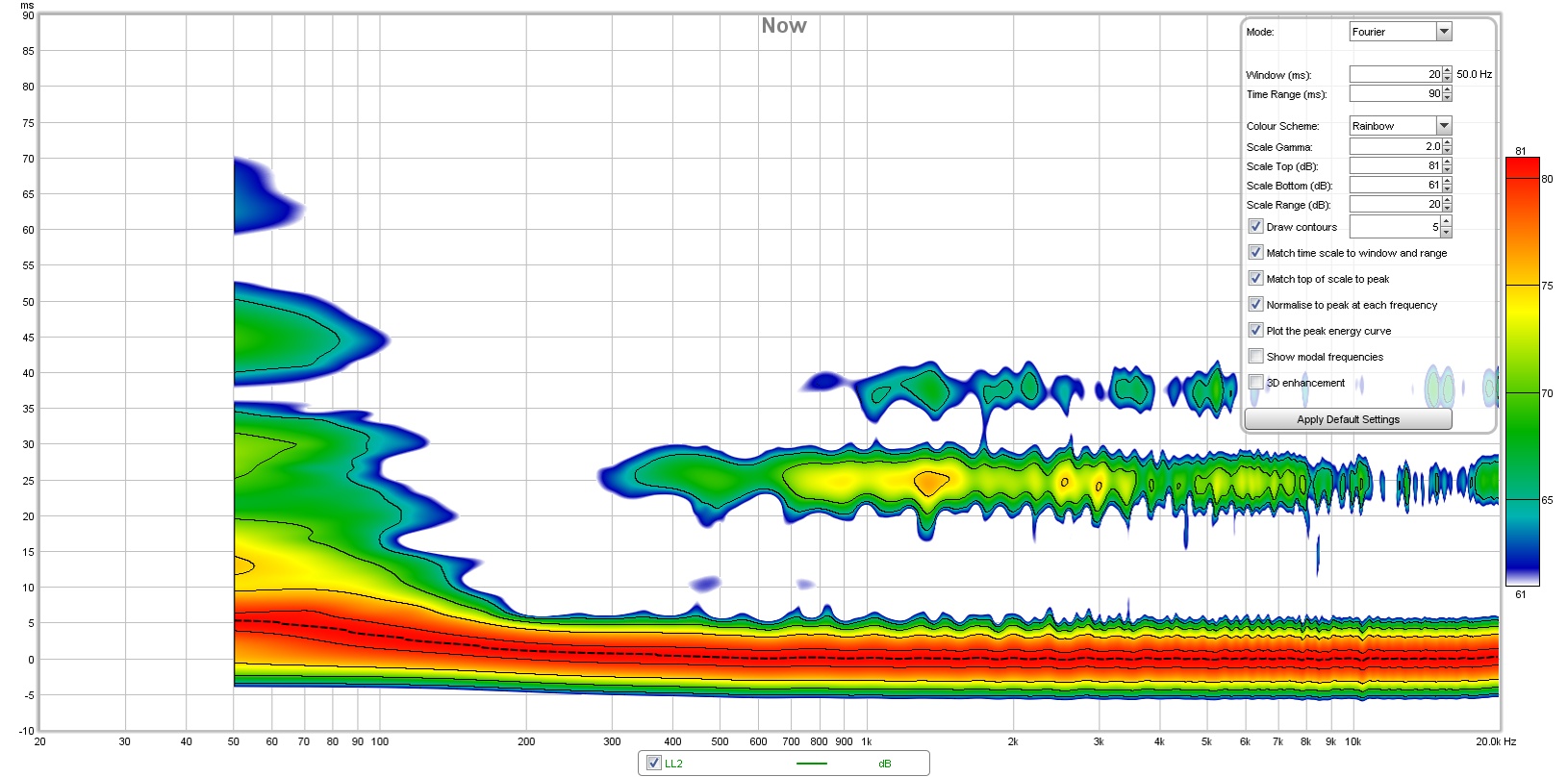

But some of what I have explored further since last summer is what room reflections we need. The graphs provided show where I was in this regard to where I am at now. IMO, the sound improved noticeably by increasing the room response, albeit, in a controlled manner.
The 24ms and 37ms reflections are quite directional. The 24ms arrives at 120 degrees and the new 37ms at 60 degrees as observed from the LP.

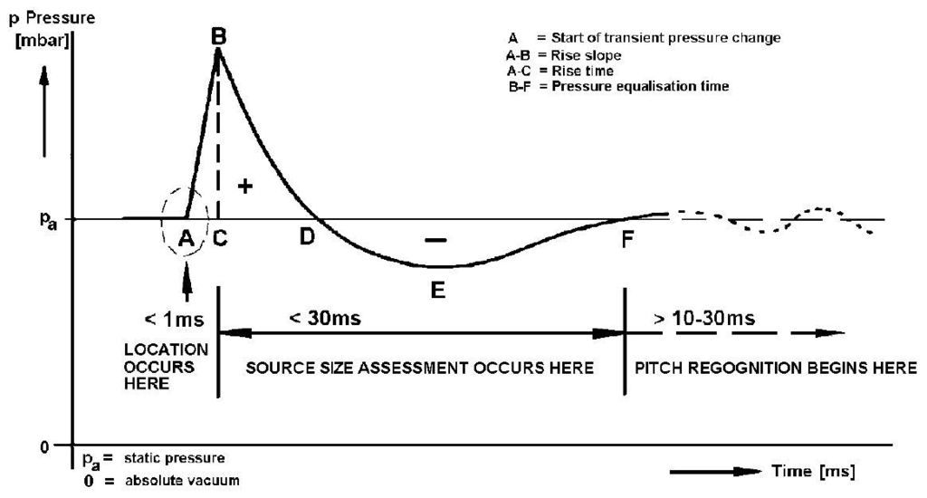

I like this graphic of an idealized transient pressure response. Not only is it about time coherency, but also what happens immediately after the transient or step in the case of our loudspeakers and room:
I modeled my step response so it measures similar at the listening position. Note the time scale. I need to take another measurement as I had a ground loop/RF buzz on this measurement, and a refection at 2.3ms, but the overall shape is similar:
One aspect I found that affects the pressure equalization time is how quickly the woofer stops after the impulse has been sent through. Incorporating a subsonic HP filter, in my case, really changed the pressure equalization time. I found it also reduced the Group Delay. Something to consider if one hasn't played with subsonic filters between 15 and 20 Hz.
Without wanting to turn this discussion into a "my STEP is larger/longer than yours" the shape and the size of the step is largely determined by the shape of the FR response and its roll of on either side. (and anything that happens in between that could turn the phase like crossovers do)

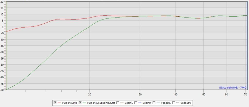

Here is a quick graphic of the simulated response at the LP with and without the 20 Hz subsonic filter.
It's a considerable difference. The speakers I have can go quite deep and at the levels I listen to unstressed. The amplifiers I run directly to woofers have a reasonably high damping factor.
When I AB the two curves, I can clearly hear a difference in the bottom end regardless of the content played. My preference is for a much tighter impacting sound. The corresponding step response is inline with the idealized response referenced, if one is designing for a 20Hz to 20 kHz target. Others may prefer the sound of rumbling subsonics, but I don't find it very musical sounding. A certain mastering engineer on the Acourate forum went through the same exercise, with stereo subwoofers of high quality, and noted the audible difference as well and keeping the subsonic filter.
